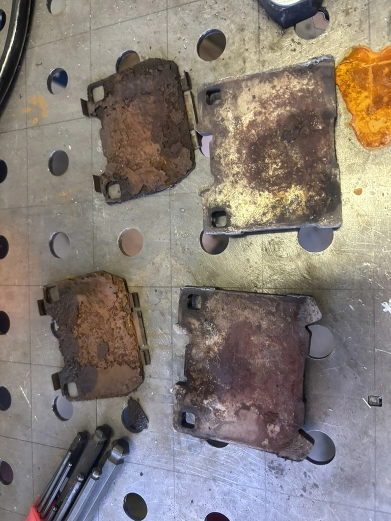

Rear brakes were squaling a lot even after Toyota Service. So checked the situation and rear brakes needed some cleanup.
No full points for service guys here.. its 15-20min job per corner so not really a biggie if "you're there".

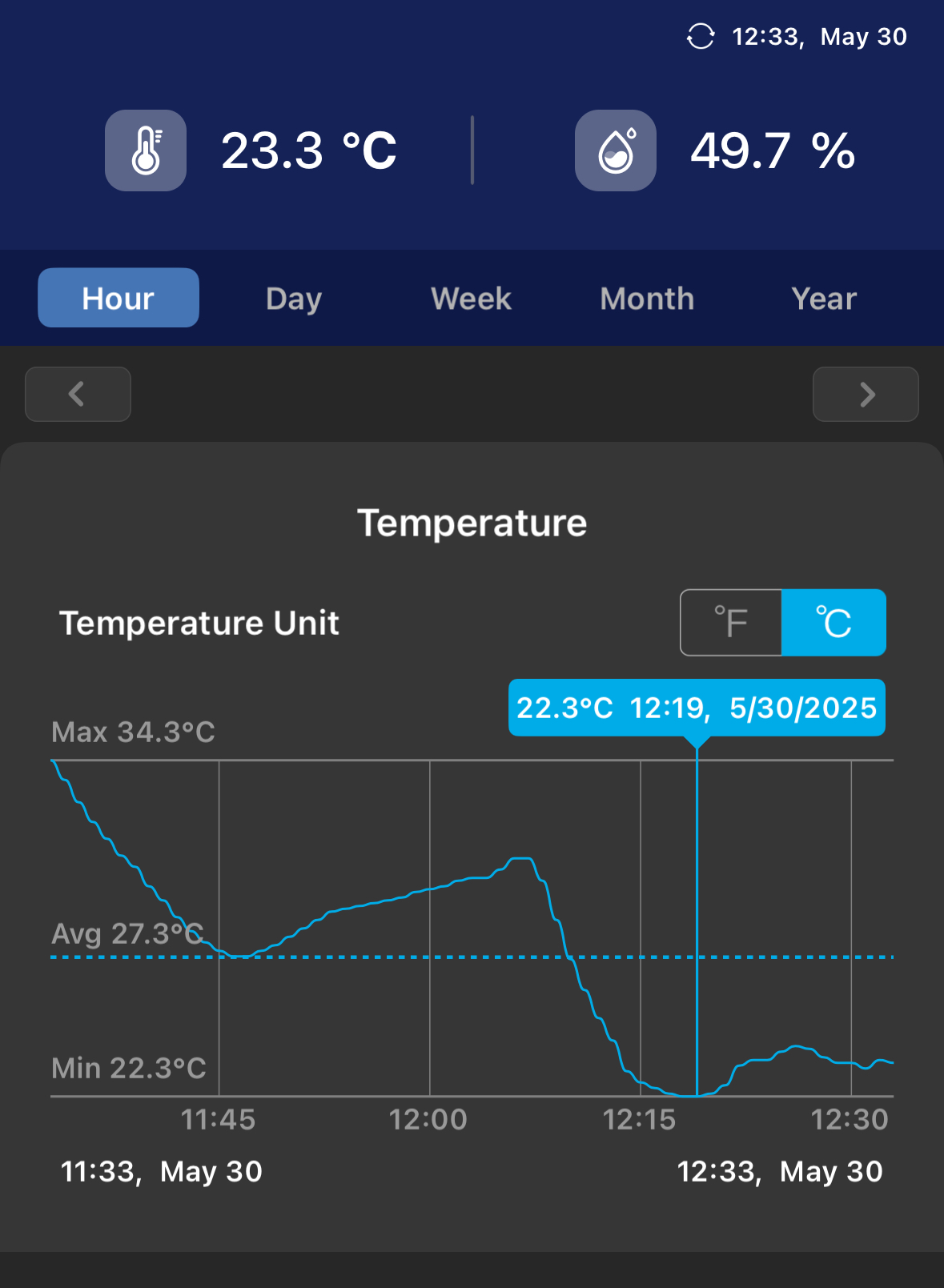

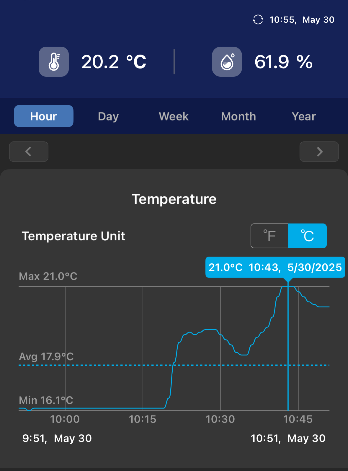

went for short recreational walk with GR, and same time measured the underhood temps with Rally2 vents.
Temp sensor was located on top of airbox snorkel.
Ducts seem to work faily well from 50kmh onwards. In city they gave 2-3'C above ambient and on road it drops to 1-2'C.
City traffic had few stops. Ambient temps were btw 17-20'C during drive.
here are few temp measures from cold car (50% in city 50kmh, then later 50% on faster narrow road, 80kmh). And back vise versa.
The middle pic is how temps went when car was waiting for 1hr. Oils reached 95'C after first drive.

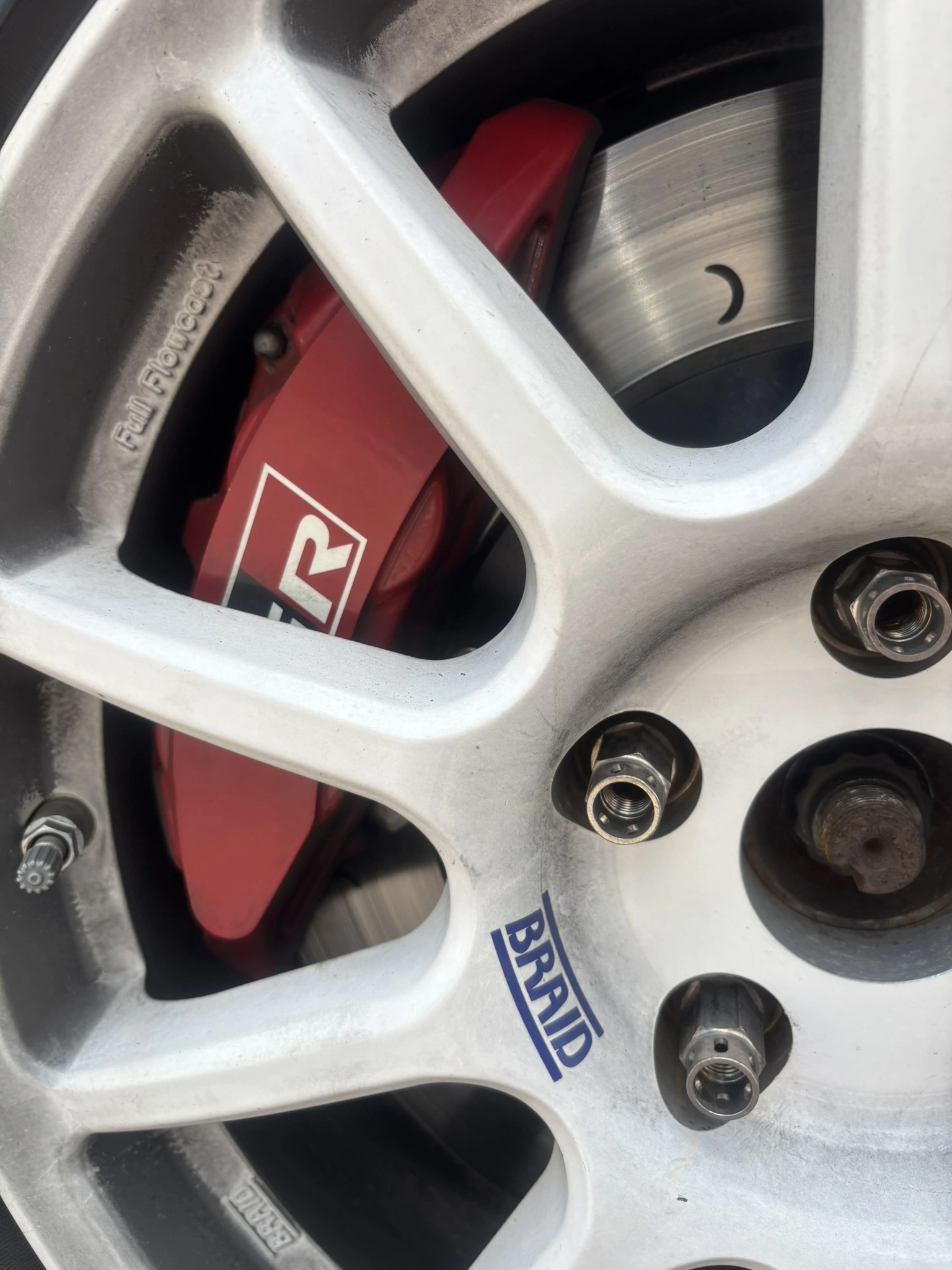

BTW with fresh discs the RP-X's dust like mad.
1. starting the car from garage, cold engine. Temps rose max to 21'C but then dropped to 20'C (1-2'C above ambient).
2. car in parking lot, hot engine. Temps rose to 37'C, then dropped to 27'C, and started slowly rising (car was parked in sun).
3. Back home, oil temps in start 70'C. temps dropped quite fast to 22'C on road, and then rose marginally few degrees in city.
In total vents work quite well. with aluminum intake plenum intake temps seems to be highish when driving slow as manifold heats up from engine, but intake temps drop too when pushing harder as more cooler air flows through it.
Car feels bit brisker now, not sure if its thanks to vents with IC working more efficiently, or from lighter brake discs. maybe combination of both.
goes certainly fast enough for narrow road fun.
pic 1 cool car, drive to park.
pic 2. car waiting on parking lot.
pic 3 - drive back home.
pic4 dusty boots

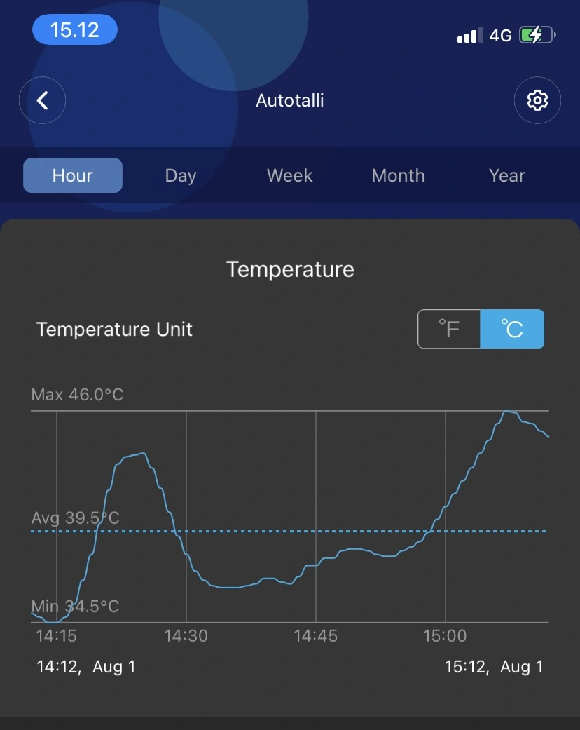

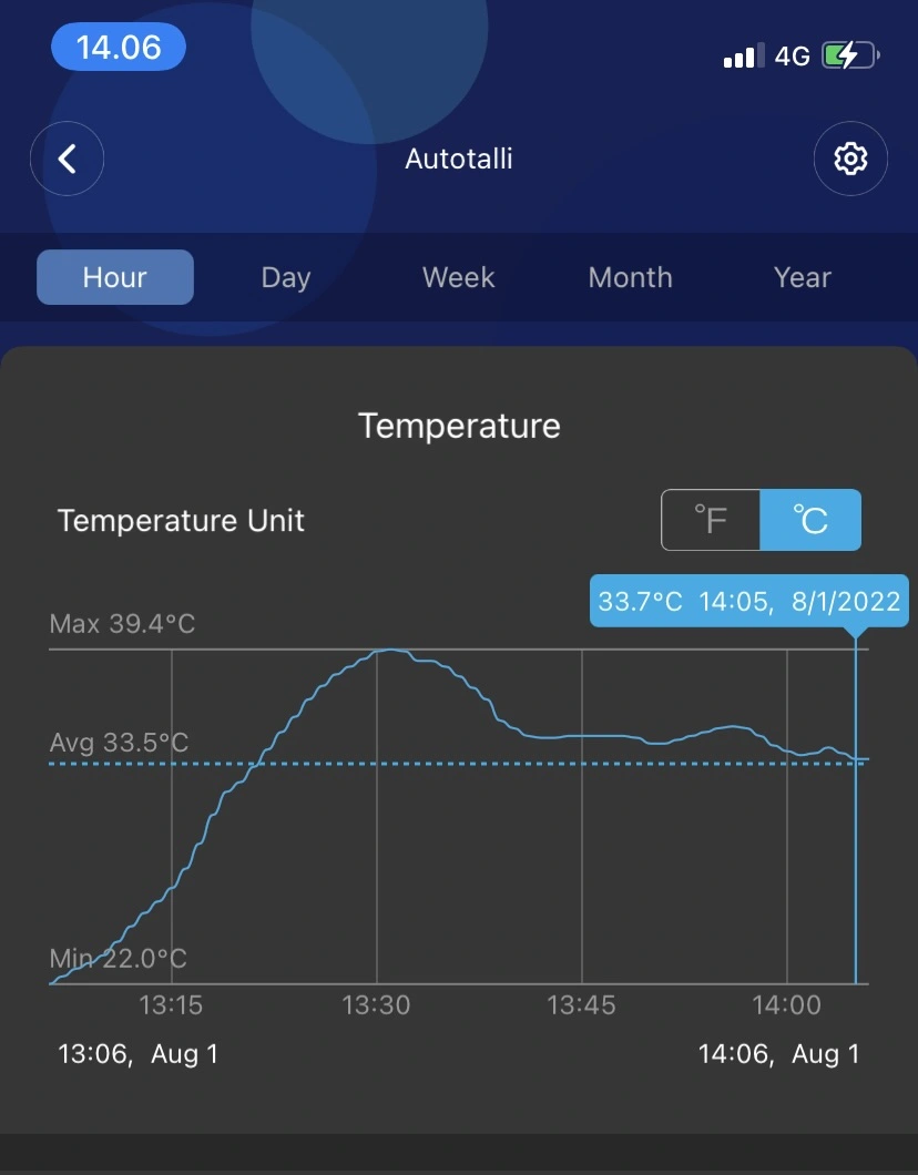

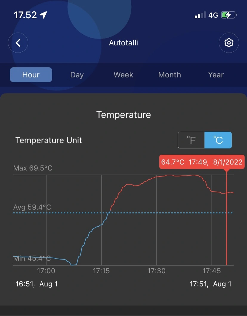

Thanks for detailed info, how would the temps have been with non vented OEM bonnet, is there a discernable reduction?
I measured it some point but should try to search the old results.
This i measured on track day 1.8.2022. It was hot day, temps 25'C or so.
If I rememer correctly I measured temps while driving to track and then on track. the last high peak is when car was stationary in pits after lap run.
The drive to track is 80km/h country road. looks like its 10-20'C above ambients with stock hood.
10-20deg above ambient down to 1-2deg above ambient is a worthwhile improvement. Assume you would also see lower peak engine oil temps?
