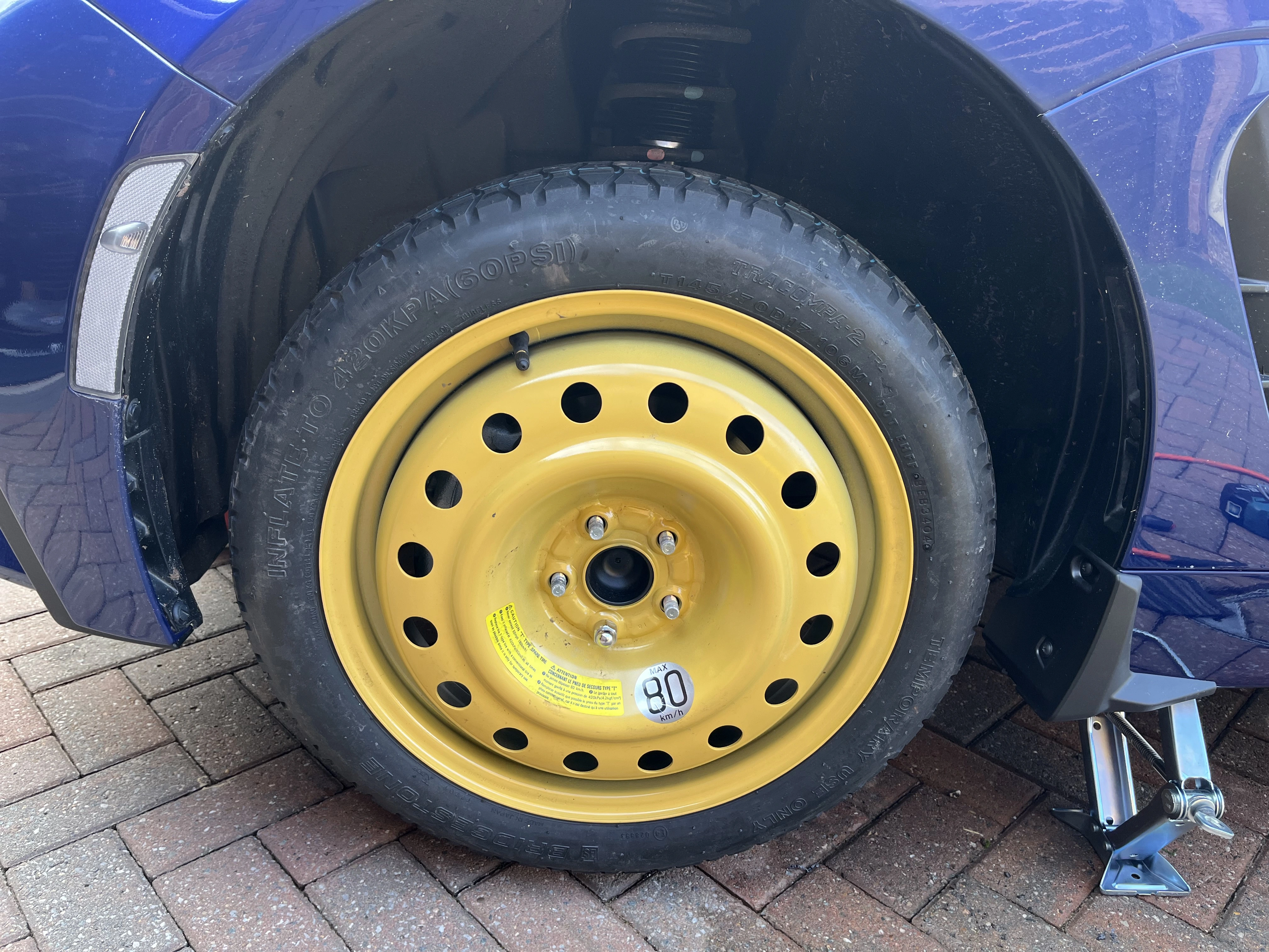

I bought a 17” Subaru legacy space saver with 145/70/17 from EBay for £40. Test fitted on front wheel with no clearance issues on Caliper. New tyre is £60 for Uniroyal as current is years old. Have an M8 bolt tie down & cap for retainer in boot.View attachment 25526

@Dal3D did your wheel from this 2007 Legacy fit the boot floor perfectly? No Sag no raise? With or without Foam and Jack bit?
Fitted fine - std boot mat thing sat as before.
