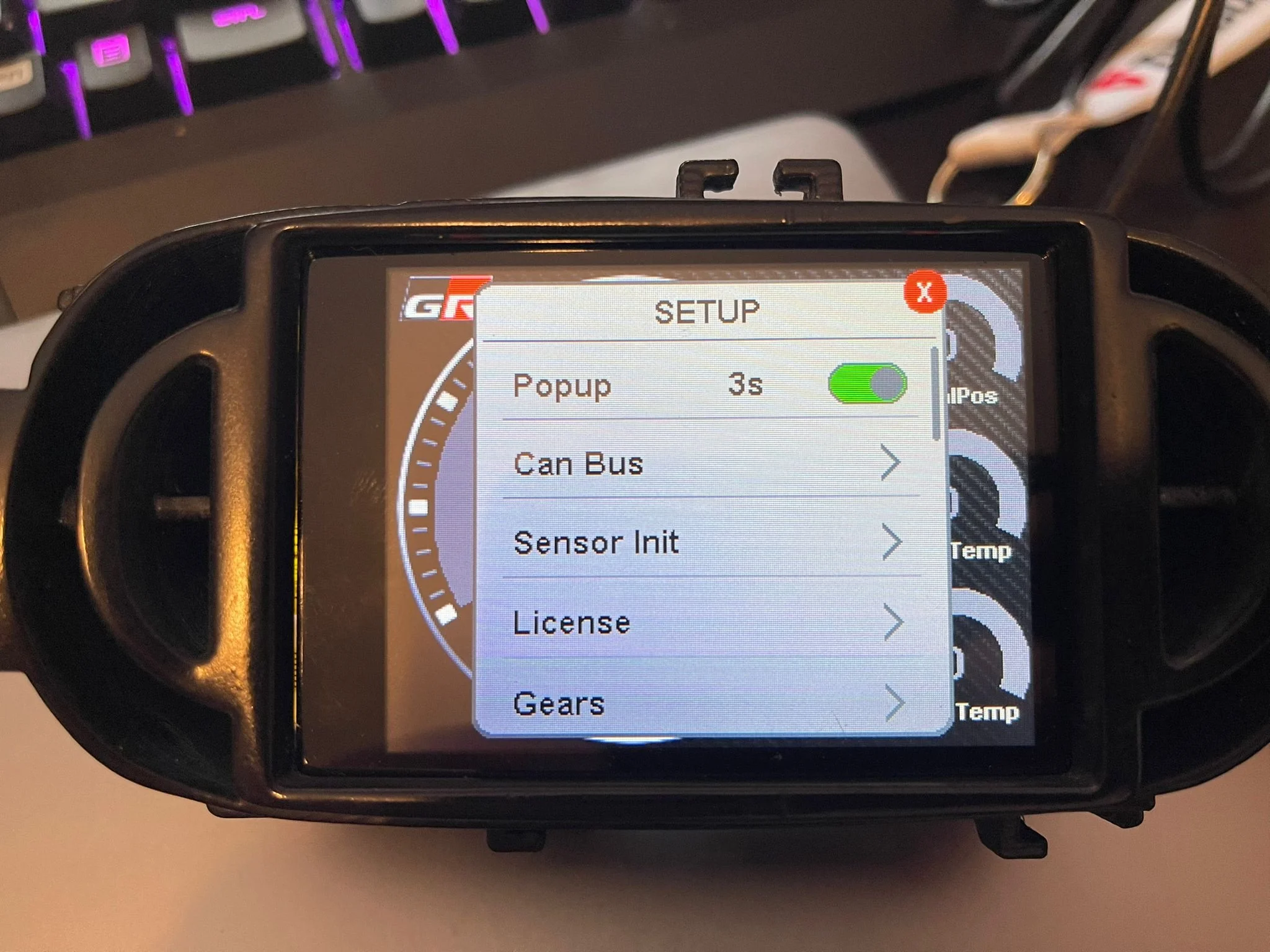

You superstarIf you have already installed the unit you need to upload files one at a time via the software.
Choose file
Select and upload one at a time.
reboot and then swipe down select setup
select sensor Init
scroll down and select flash usage, this will load the updated images from the MSD card to the memory, it will do a slow boot the first time to restart it and after that it will be normal.
