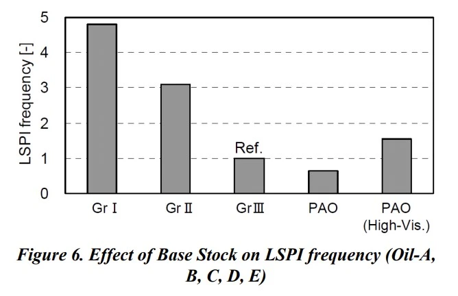

That's not exactly an easy question, and it's pretty unlikely you'd find a solid answer in regular forums. Maybe some hardcore oil forums like oil-club.de might help. To really tackle it, though, you'd need to read several in-depth studies to form an evidence-based opinion.
That said, there's a 2012 paper by Toyota Motor Corp. (DOI: 10.4271/2012-01-1615) where they tested how different oil parameters affect LSPI. One of the graphs shows that, although PAO base oil at the same viscosity slightly reduced LSPI compared to Group III, using a higher viscosity PAO base oil actually increased LSPI frequency (that's 4cSt vs 8cSt oil viscosity).
All the oils in the study used the same ILSAC GF-5 additive package. I believe Toyota uses Group III base for their 0W-20 SP ILSAC-6A oil, and Ravenol DFE uses PAO.
Yes, this was before the ILSAC GF-6A and API SP standards came out and I’m not sure if these findings still hold up with today’s oil chemistry.
