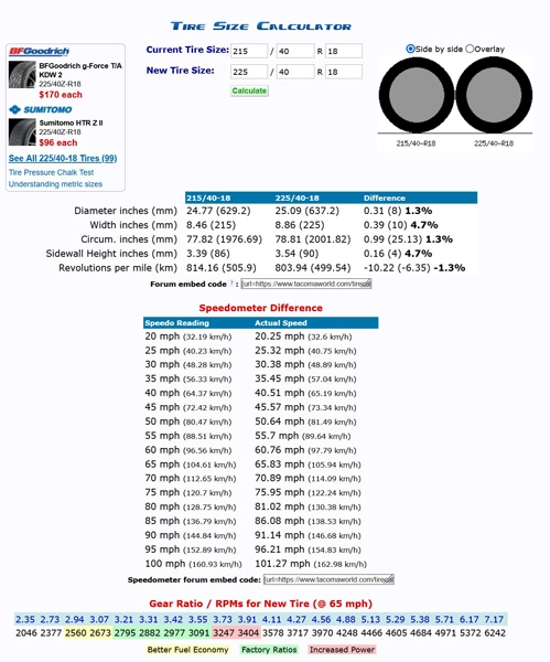

225 is just about okay on a 7 but I don't think it'll feel particularly sharp to drive on.
Here's another fitment calculator (need to pay, but isn't much) to see it against front and back of our car. Called wheel-it-fit. (just seen I forgot to change the profiles/ratios. But you get the idea)
