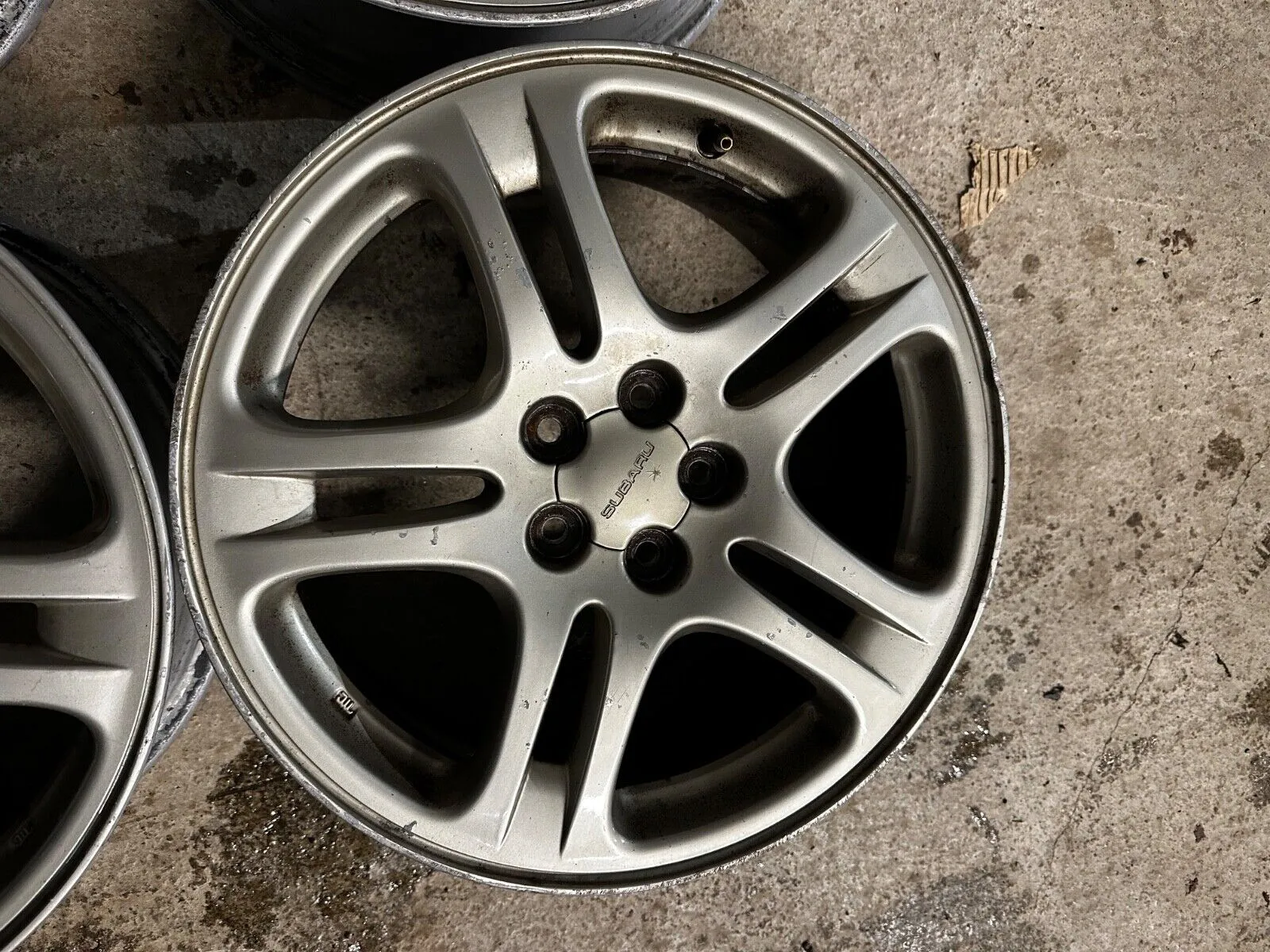

I have been considering a set of winter wheels/tyres but I am a bit clueless about wheel sizes, stud patterns, and all the other numbers that go with them. I saw some used 17 inch 5x100 Imprezza wheels as per the photo, what other info do I need to find out if they would fit? And would them mot having pressure sensors mean a constant warning on the dash? TIA

Im no expert but Width 6-8inch, centre bore 56.1mm or bigger & offset 40-50mm should be fine, tpms will show a small warning sign if its not there, no more annoying than the hill assist light
This webpage might help you. It lists vehicles with the same PCD and centre bore as the GT86. And it gives the offset for each model. Not sure how accurate the information is though... So do your own checks!
And this one estimates the clearances etc around any new wheel/tyre set-up.
Both are links that have been posted by others on this forum. They helped me with my decisions.

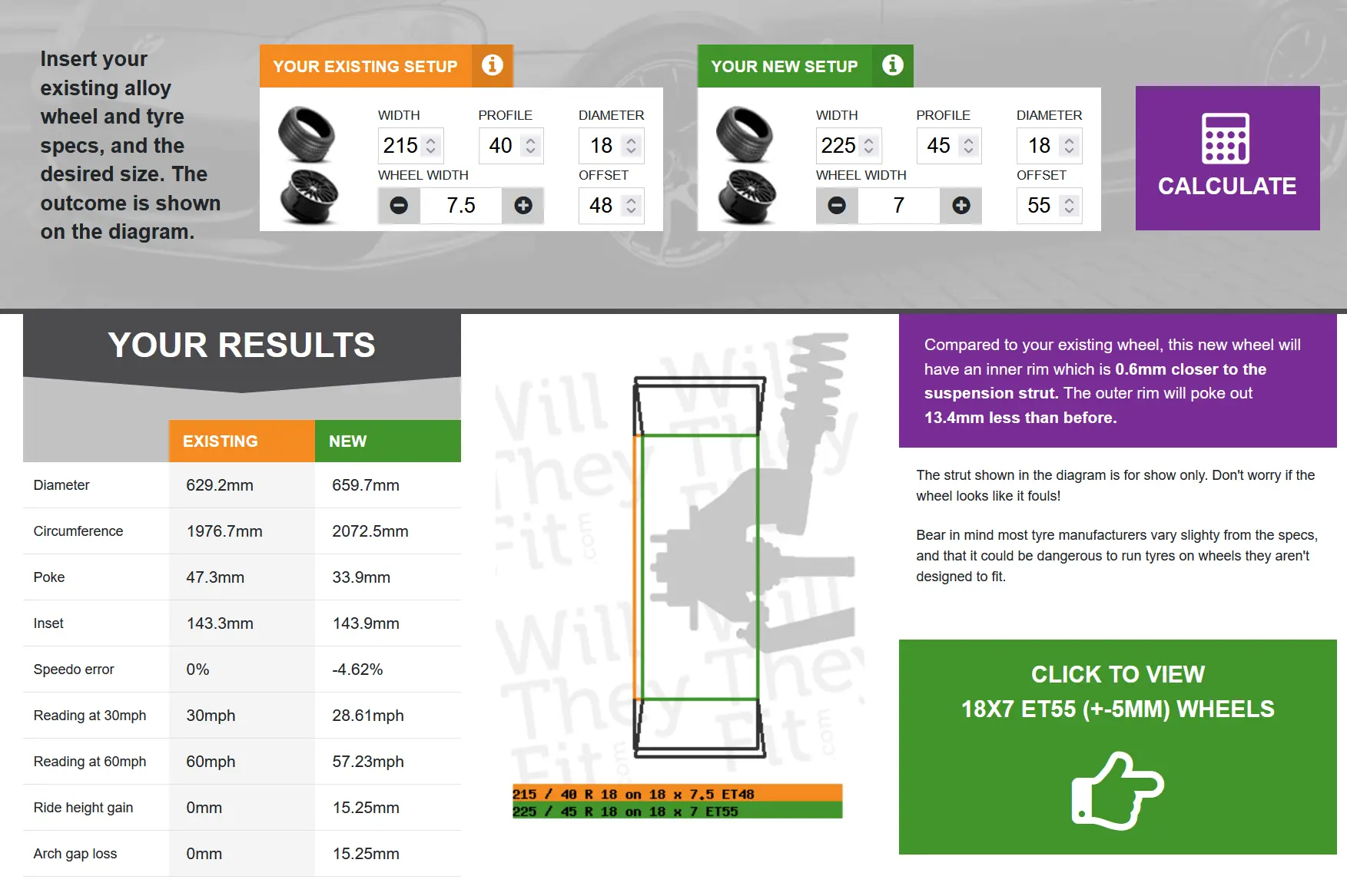

Using 'Will they fit.com' I got the following result:
There looks to be a fair bit of tyre 'flare' with that set up ie., a wider tyre on a narrower rim. Although it seems on paper to be 'a fit', I'm wondering if a tyre centre would actually put them on. You've also got a significant speedo error at 4.62%, albeit in the safe direction. Doesn't look like any spacers would be needed at only 0.6mm closer to the suspension, although the rim will be sticking out 13.4mm less.
There looks to be a fair bit of tyre 'flare' with that set up ie., a wider tyre on a narrower rim. Although it looks on paper to be 'a fit', I'm wondering if a tyre centre would actually put them on. You've also got a significant speedo error at 4.62%, albeit in the safe direction. Doesn't look like any spacers would be needed at only 0.6mm closer to the suspension, although the rim will be sticking out 13.4mm less.

This kind of info makes a forum! Top notch 😁👍
