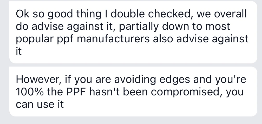

Update: I’m just out of a chat with AutoGlym Support and this is their Tech’s reply:
So it seem their AutoGlym ‘Tar and Adhesive Remover’ is okay on good condition (unbreached) PPF too.
