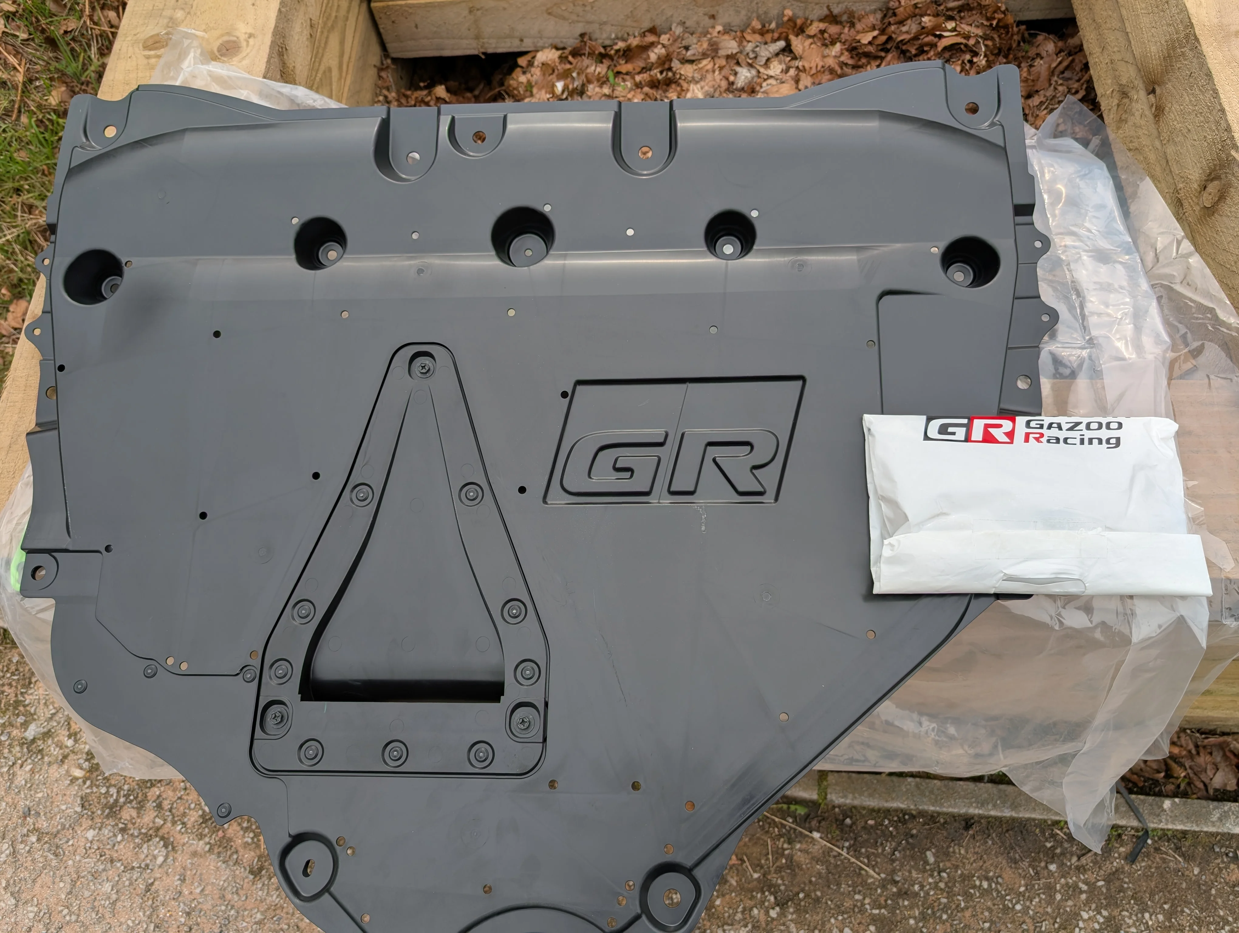

Tore up the original undertray, so replaced it with the GRMN version today.

Yes. There's at least one YouTube video I know of (Japanese) where they test the transfer temp (installed thermocouple) with the stock tray, this one, and the GRMN one. They just drive the car at around 80km/h sustained until the temperature plateaus. The TRD tray shows a significant drop in transfer oil temperature, and the GRMN tray about 10°C cooler than the TRD one.
Thanks, so the GRMN cover is better and, from what I've read, more resistant to road conditions (rain, mud, frost, etc.). What are the differences between the standard cover and the GRMN? Do you have any comparisons?

I am surprised the NACA duct works more efficiently the TRD
Material for starters. The GRMN is a hard plastic and the TRD/GR Parts is the same as stock. GRMN has no transmission cooling. GRMN must be removed to change the oil and filter.
My opinion...for fast road, TRD is fine. Here in Japan, a lot if GRY are used in competition rally, and they all use aluminum bash guards, so... :) Gymkhana peeps use either, and track cars should have a transfer oil cooler if you want it to live. Fast road, and either is probably helpful, but not required. IMO.
