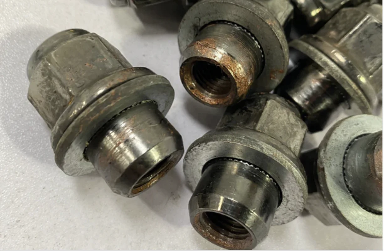

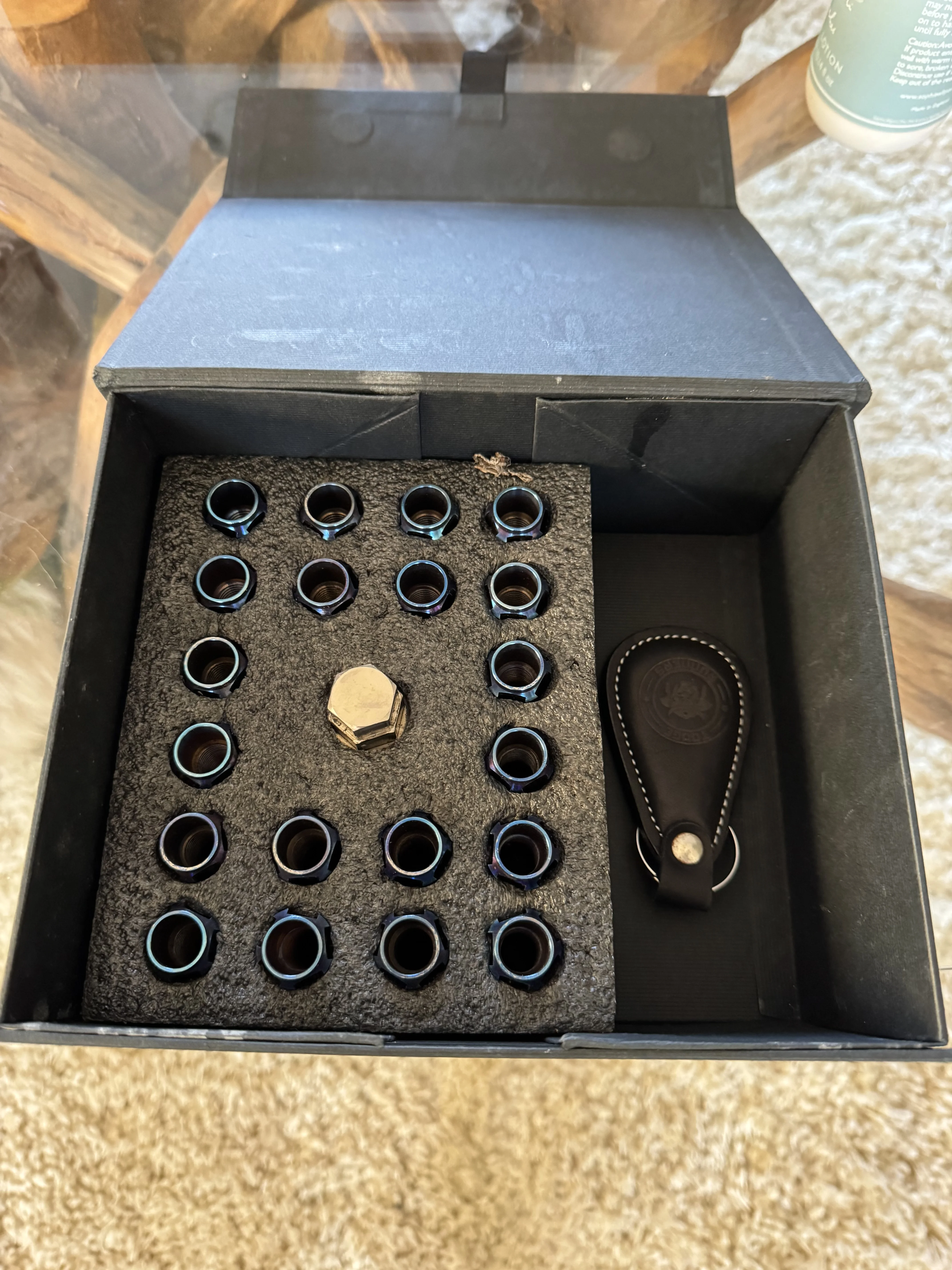

Are they OEM wheels? The nuts look like they’re for aftermarket-type wheels, 60 degree taper or whatever it is. OEM wheel/nut mating surface is flat, the wheels and nuts need to match.Snapped up some GRMN titanium wheel bolts, arrived and fitted today. Got them to save a little unsprung mass, but they look pretty cool too![]()
Oh balls, didn't notice that. Wonder if these will enable me to use themYeah, don't put 60° taper nuts on the OEM wheels![]()
Even with flat converters you are losing half the thread engagement on the wheel stud as you will be missing the shank from the original lug nuts. The more thread engagement the better.. 8 to 10 turns of th nut you are looking. With the missing shank I would guess you are using only about 5.
