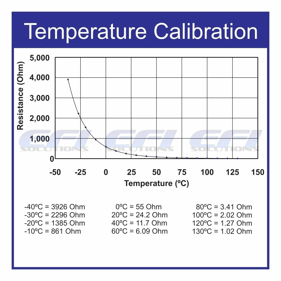

Its unlikely it's very accurate.
The software is converting a voltage signal from the sensor into a value.
If you went out and brought a thermistor type temperature sensor it comes with chart and you need to configure the ECU or the digital gauge so the temp reading is correct.

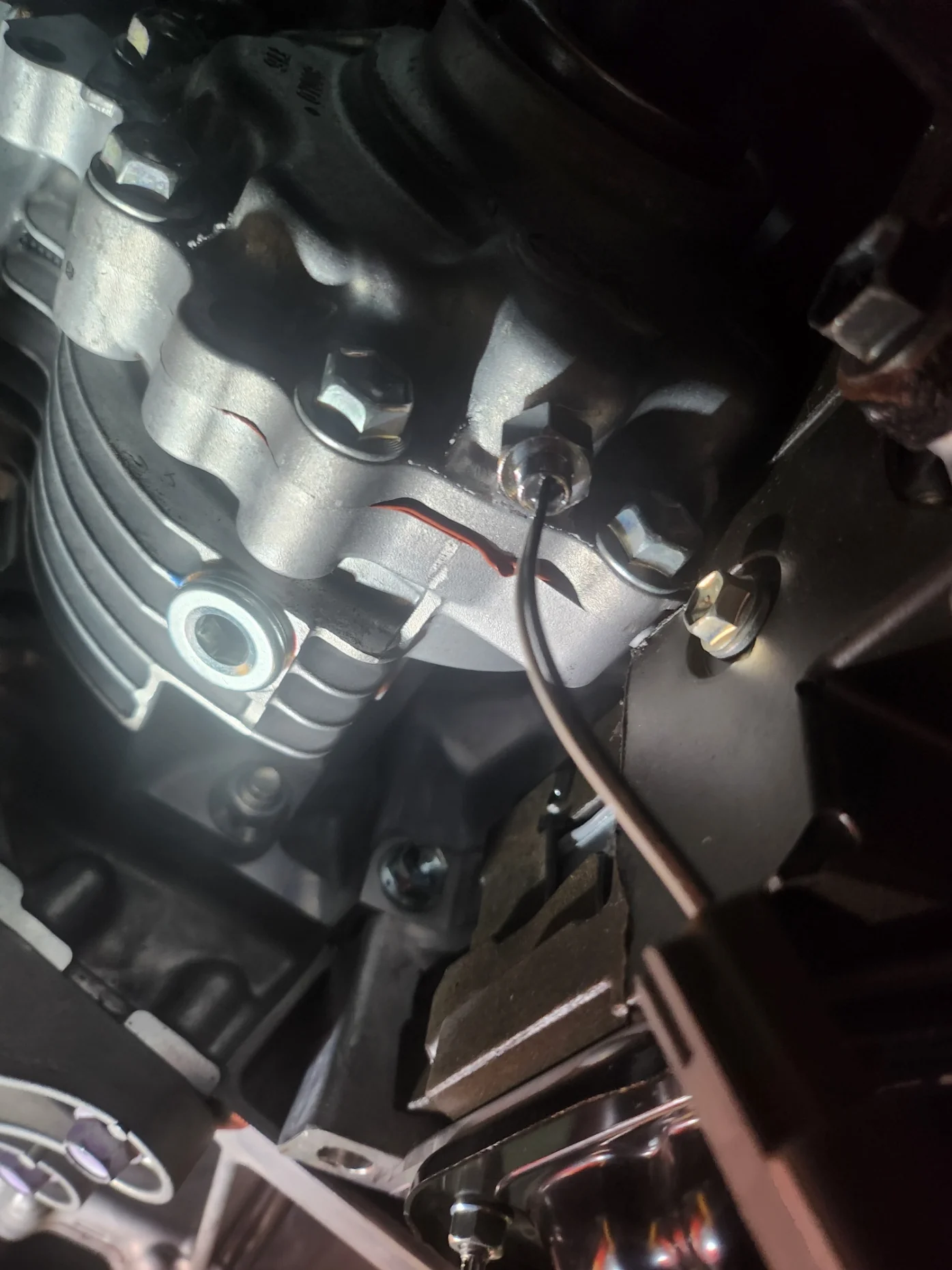

I am running a temp sensor in the T/Case. On a B road it runs around 110 deg C.

I had to drill and tap a new hole. I was a bit nervous drilling into the T/Case but it turned out ok. I have been told the T/Case runs hotter than the Trans.
The pressure and temp sensors are voltage. 5 volts supply, usually 0.1 to 4.9 signal voltage which gets convert into a value by the ECU.
The speed/timing sensors are like a digital pulse signal. Not sure about the MAF.

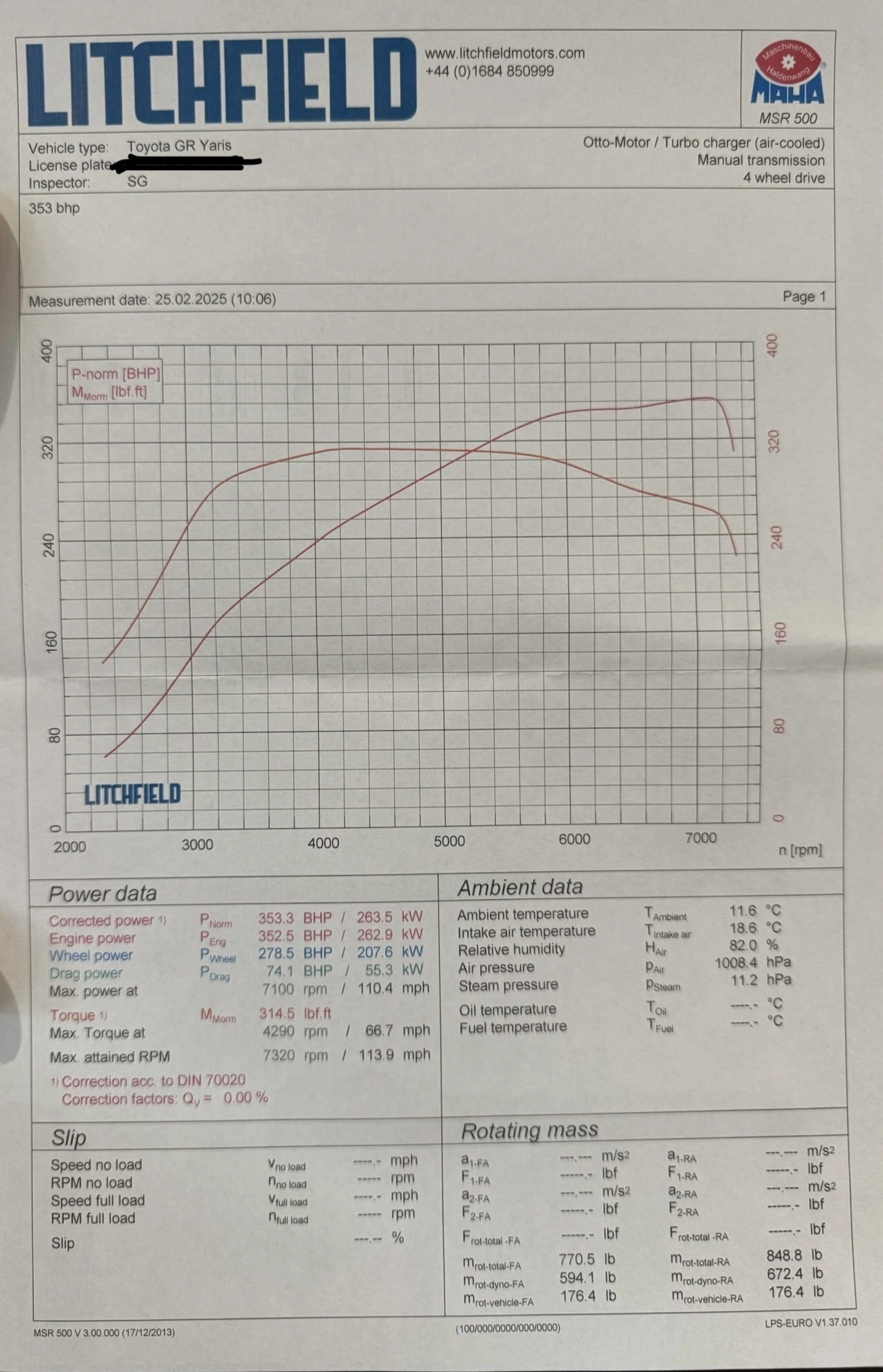

Yes my car has a Whifbitz tune on Gen2 Auto
