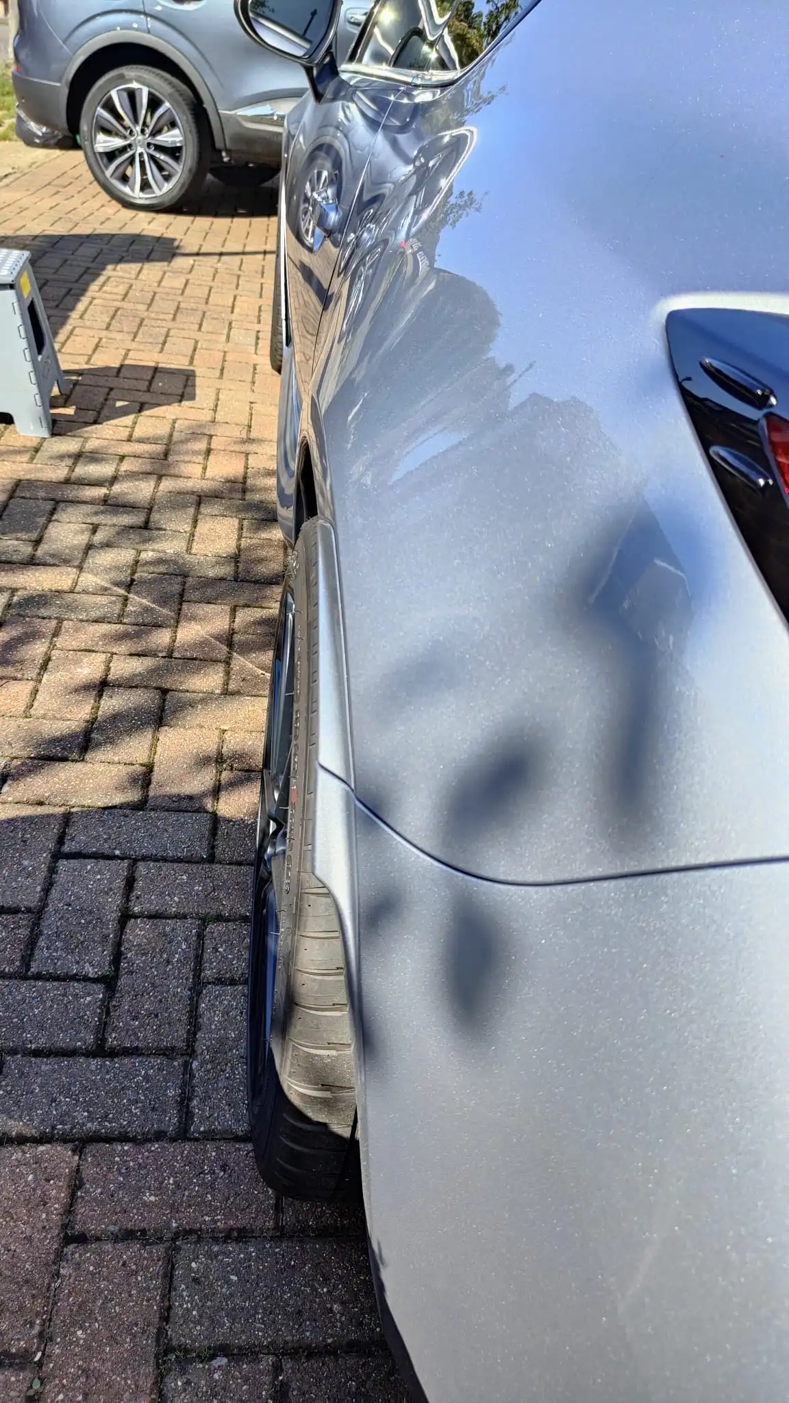

I ran mine on 20mm for 6months on standard suspension. It looks a bit strange for a few days then it becomes the norm.
Here's mine running 20mm on stock suspension

Okay, just fitted my spacers. 20mm rear, 15mm front. Stock suspension except camber bolts on the front with about 1 degree of camber.
I did the rears and at first they looked ridiculous. But because I'd jacked up the car with the fronts chocked, the suspension wasn't sitting at rest. After lowering the car and letting it roll a bit, looked much better.
