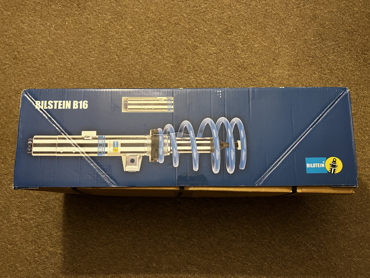

Well, despite being quoted 3-4 weeks for delivery, I had a surprise box turn up late last week.
Was a little confused at first, as the box clearly states Bilstein B16 (the adjustable version costing around 50% more money), but upon further investigation, it is the correct kit just in a generic box.
