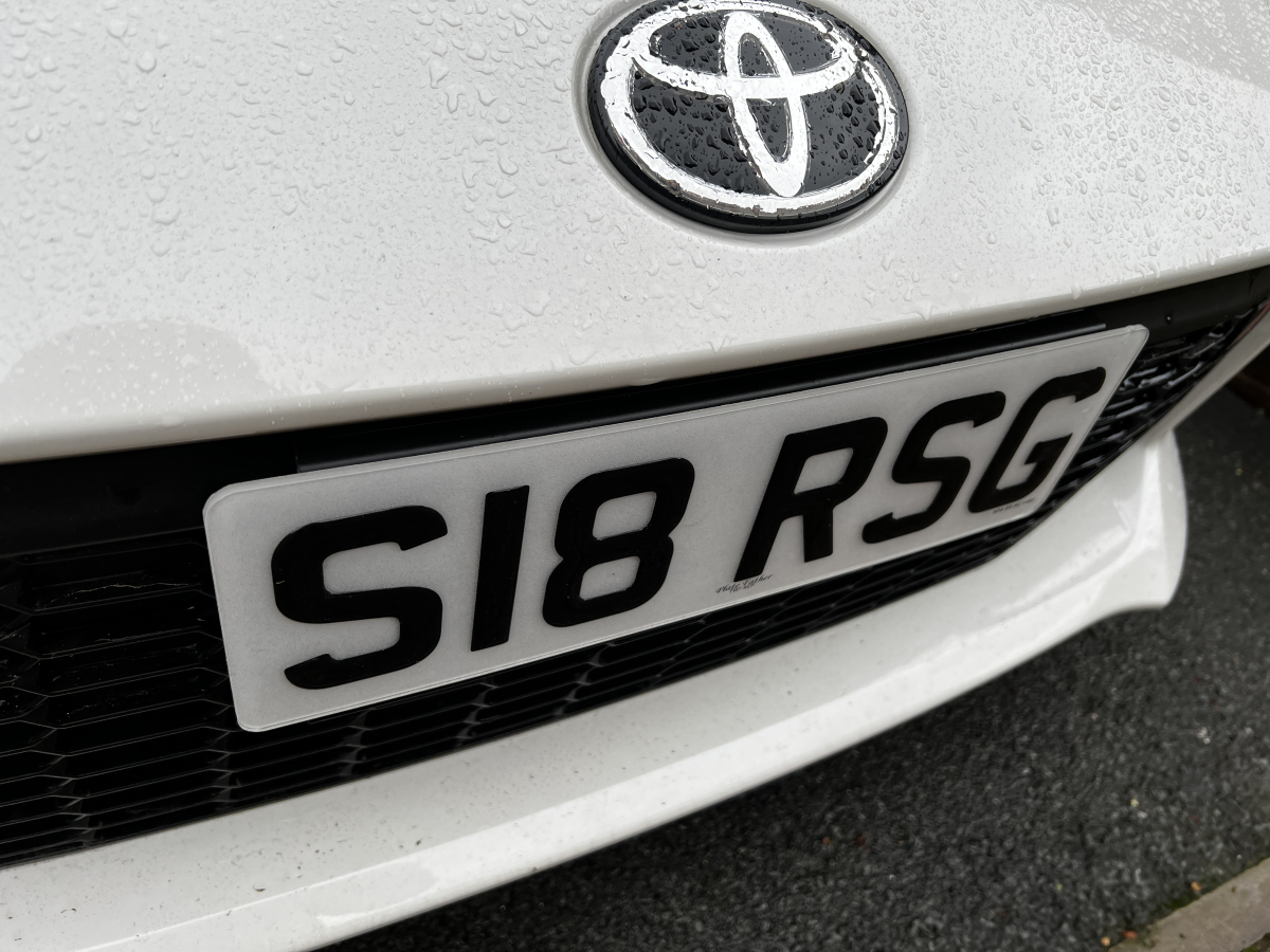

Great stuff, excited to follow along. I was just recently thinking how to modify the front plate mount, could you describe the process? I was imagining 2 cuts to then remove material before readhering
I attempted to re-adhere the outer portions of the plate mount, but after cutting them down with a hot blade, I realised that there's a slight taper so they don't fit back on.
Instead, I just cut the plate mount slightly narrower than the plate and left it like that. You can't really tell it's been done when its fitted.

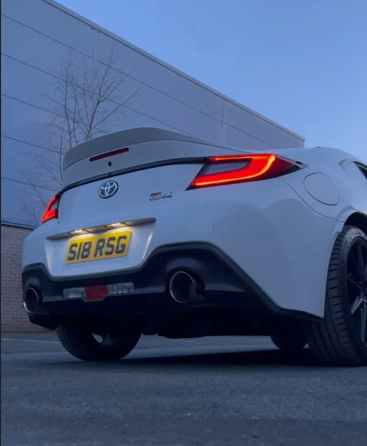

Hi interested to hear what you think about the Remark exhaust, and how it sounds.
i have just ordered a Cobra Cat back exhaust (non resonated), but not being fitted until 28th March.
Reactions: Taggy
Hi Nigel.
If you head over to the Exhausts section on this forum, I’ve posted a couple of videos and my thoughts on the exhaust. I’m only on my phone at the moment, or I’d post them again, but to save my fingers, pop over and see what you think 🙂
Hi, yes, that dose sound good👍
I’m a little concerned that a non resonated one may be a tad loud, but as it’s going to be used as a second car, hopefully be ok. I’ve had de-catted TVR’s in the past, so should be ok. After all, nothing in the front half the exhaust will be changed, so all stock there.
If push comes to shove, I can always replace the non resonated section with a resonated one, so options are there.
Carn’t wait now to get it fitted.
I've gone for it as bang for buck it seems like the most cost effective option for some noise as currently there's very little. If these are more efficient than last gen then there won't be much to gain from a full system anyway.
Reactions: S18RSG
I fear the full system might be a touch too loud tbh. This drones a little bit, but not terrible. There’s a decently sized resonator in the mid section. Interested to hear it though.
Agreed. The exhaust is a much better design on the Gen 2 than Gen 1. Bigger pipework, no random compressions. Even the manifold is 1/4” larger runners afaik. I think gains will still be there, but whereas a manifold and exhaust was worth maybe 20hp with a tune on Gen 1, I think it’ll be less than 10hp difference on Gen 2.
Consider the cost of a manifold and full exhaust system, it’s a lot for 10hp. A good percentage of the way towards a supercharger/turbo.
Reactions: KobayashiMaru86
Do they do an option of a Remark with at least a small muffler?
I quite liked the sound of it from your clips in the exhaust thread - but that cold start was far too obnoxious for me, and any sort of drone would wind me up. I've gone for the HKS option, but I agree that it's a lot of money for a cat back; but as everyone's noticed, there's not a lot of choice, especially if you're like me and want just a bit more noise.
I'm the same I like the sound, I just want it a touch quieter.
Some of the GT86 options might fit as they have the fitting on the correct side, but would have to be similar size diameter pipe. Not all GT exhaust are.
No, Remark only do a 'muffler' delete on their axleback. JDL do an axleback with 2 6" resonators which is the option I am considering (or might go custom made from H&S).
Reactions: S18RSG
