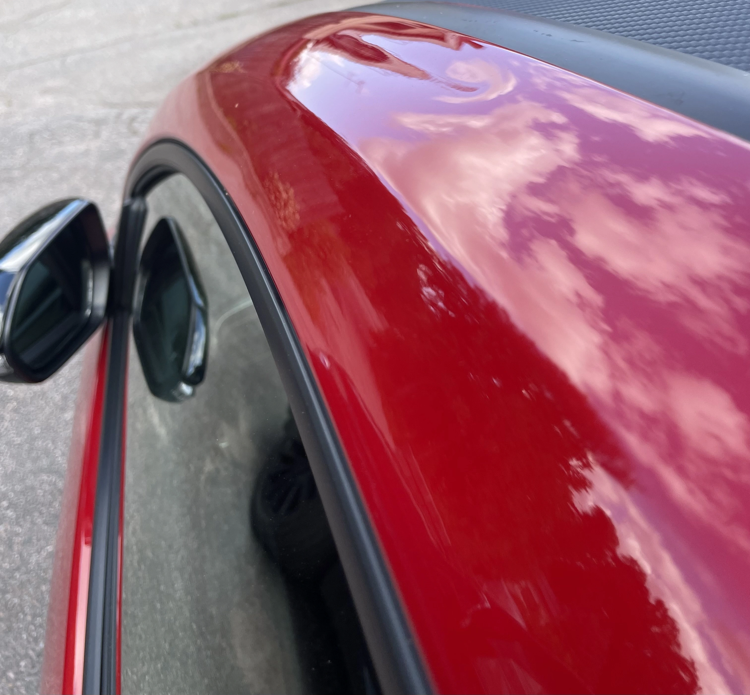

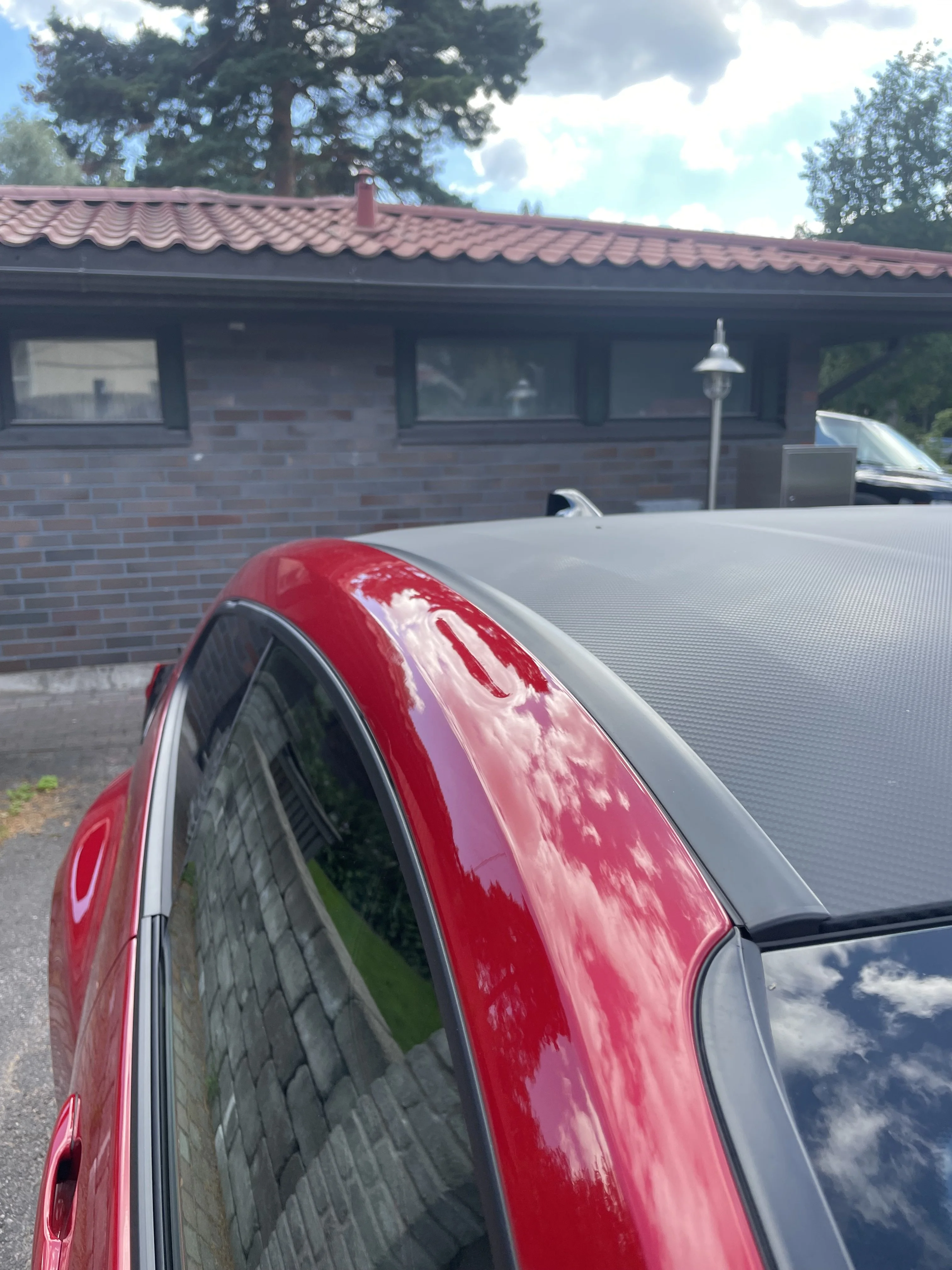

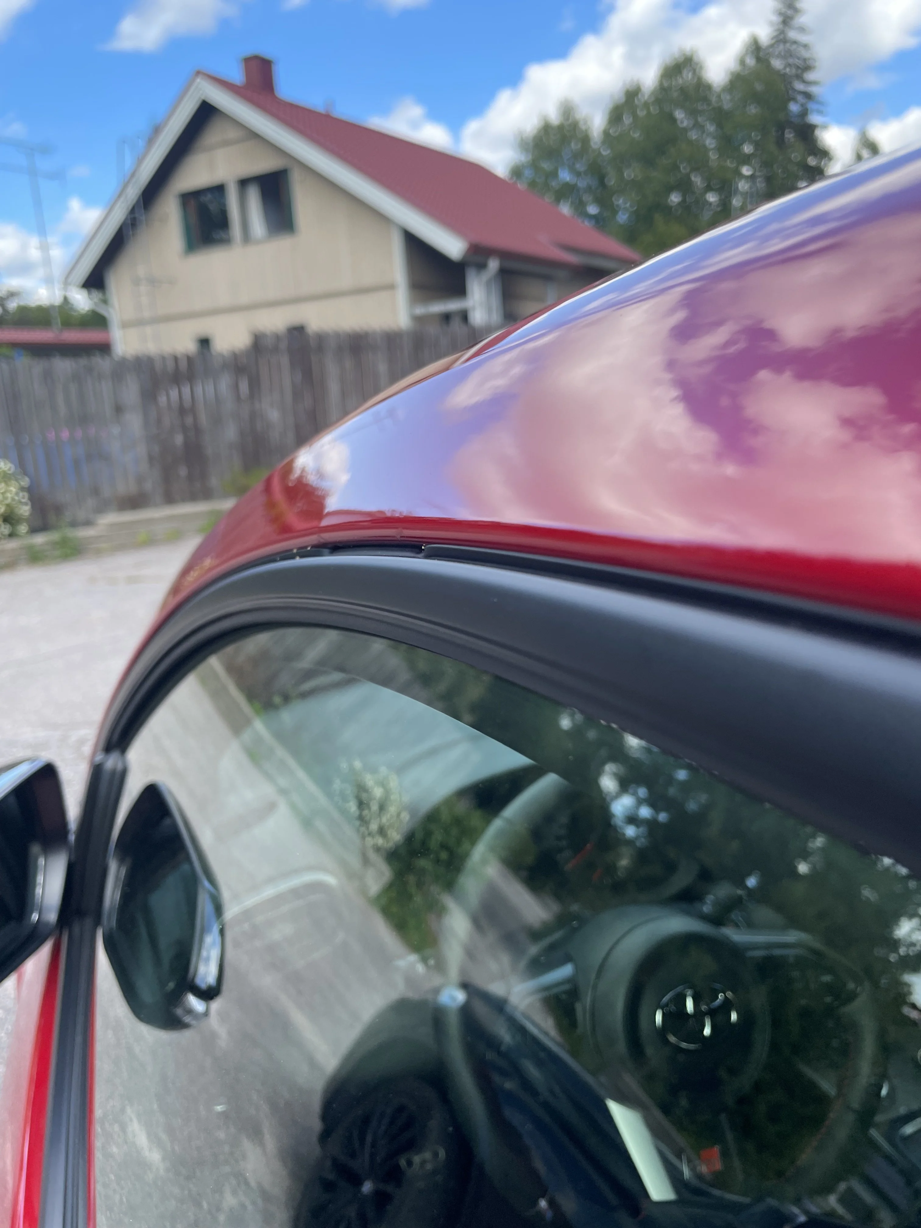

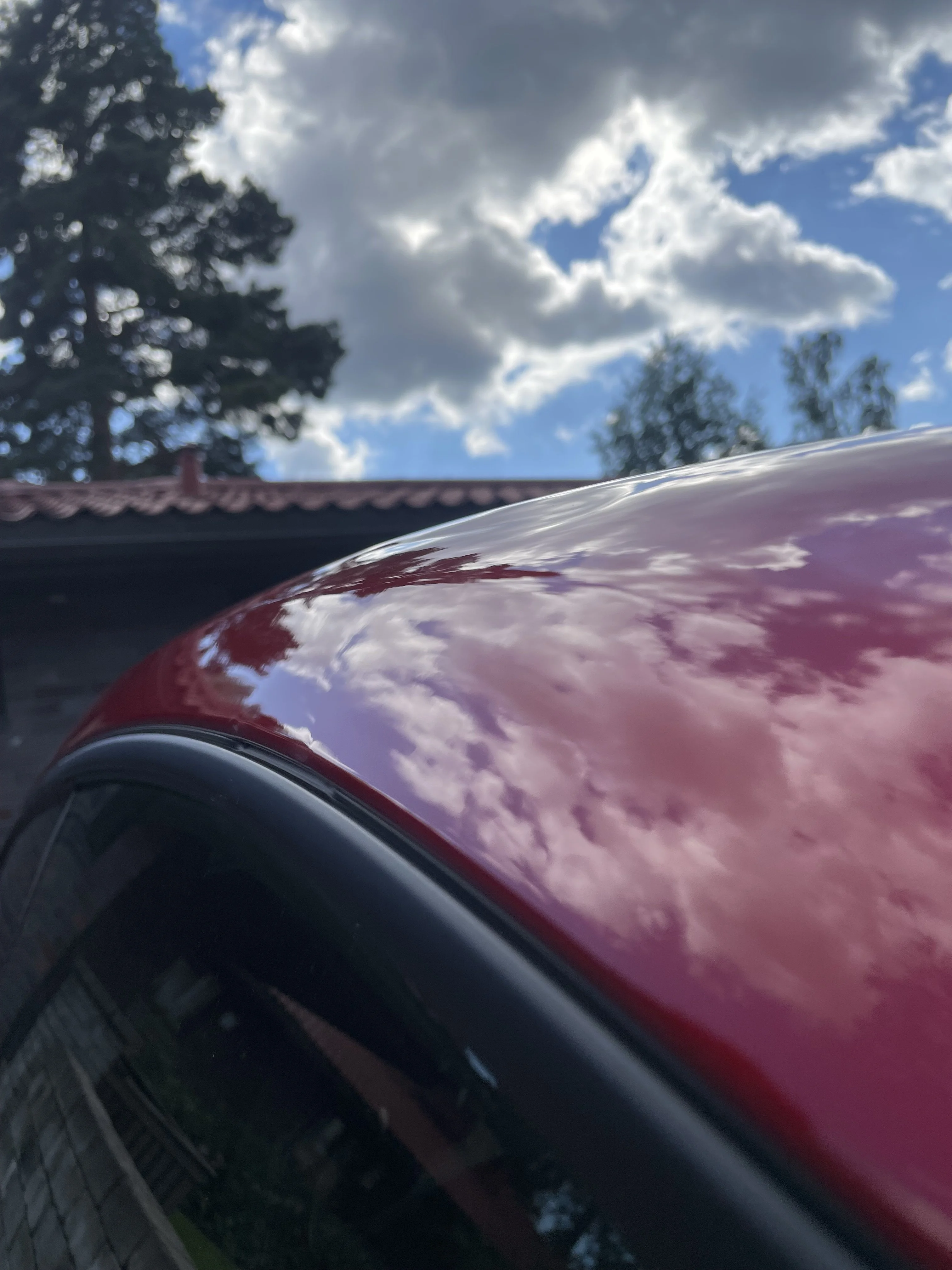

@Ralliesa did you use the exact same setup as lanman? And what kind of bikes did you mount? Thank you for sharing!
Anyone else who can report some kind of denting as well?
Yes I did. Other bike was trek full carbon frame and other was a normal frame bike.
I think the problem is the claw part of the rubberpad. Because when it is on for a long time you have to tighten the rack (thule says between every 500km) so it put more pressure on the roof. I might try to smooth off the claw part of the rubber with a boxcutter knife or something so it is just flat and the pressure is more even.
