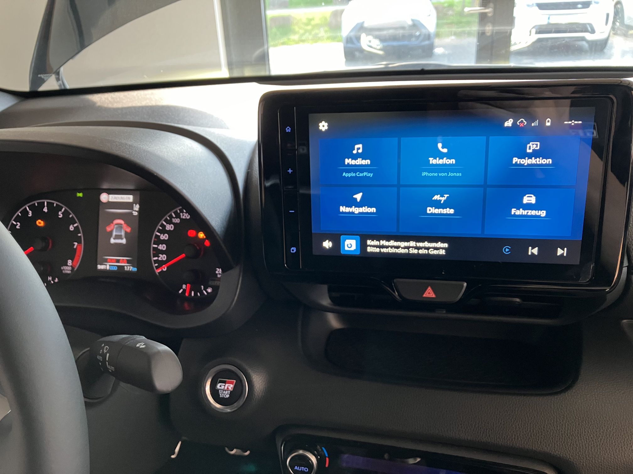

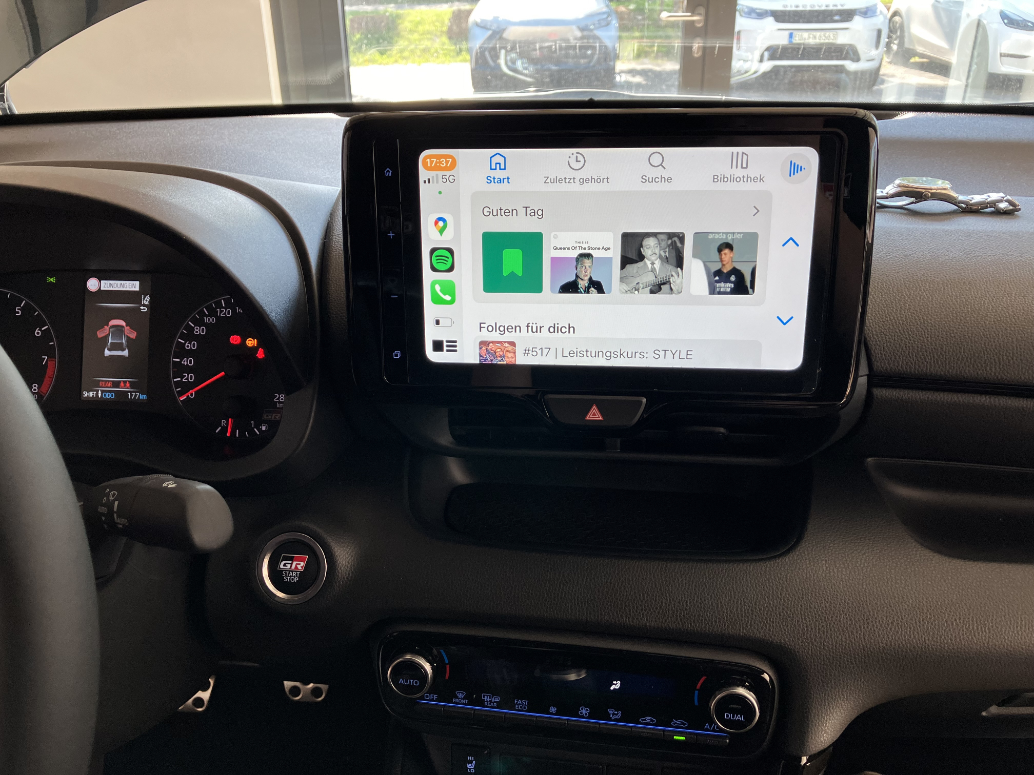

Thanks to this thread i changed my headunit too!
Everything the original unit could do, is working fine and even better. CarPlay on a much nicer screen and wirelessly is just perfect.

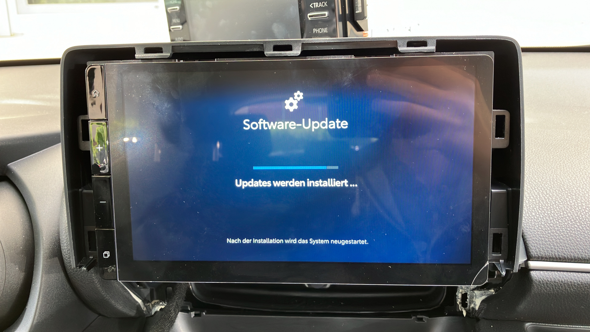

The clock not working does not bother me and i could even connect the system with my hotspot and update the firmware easily.
10/10 would do again!
