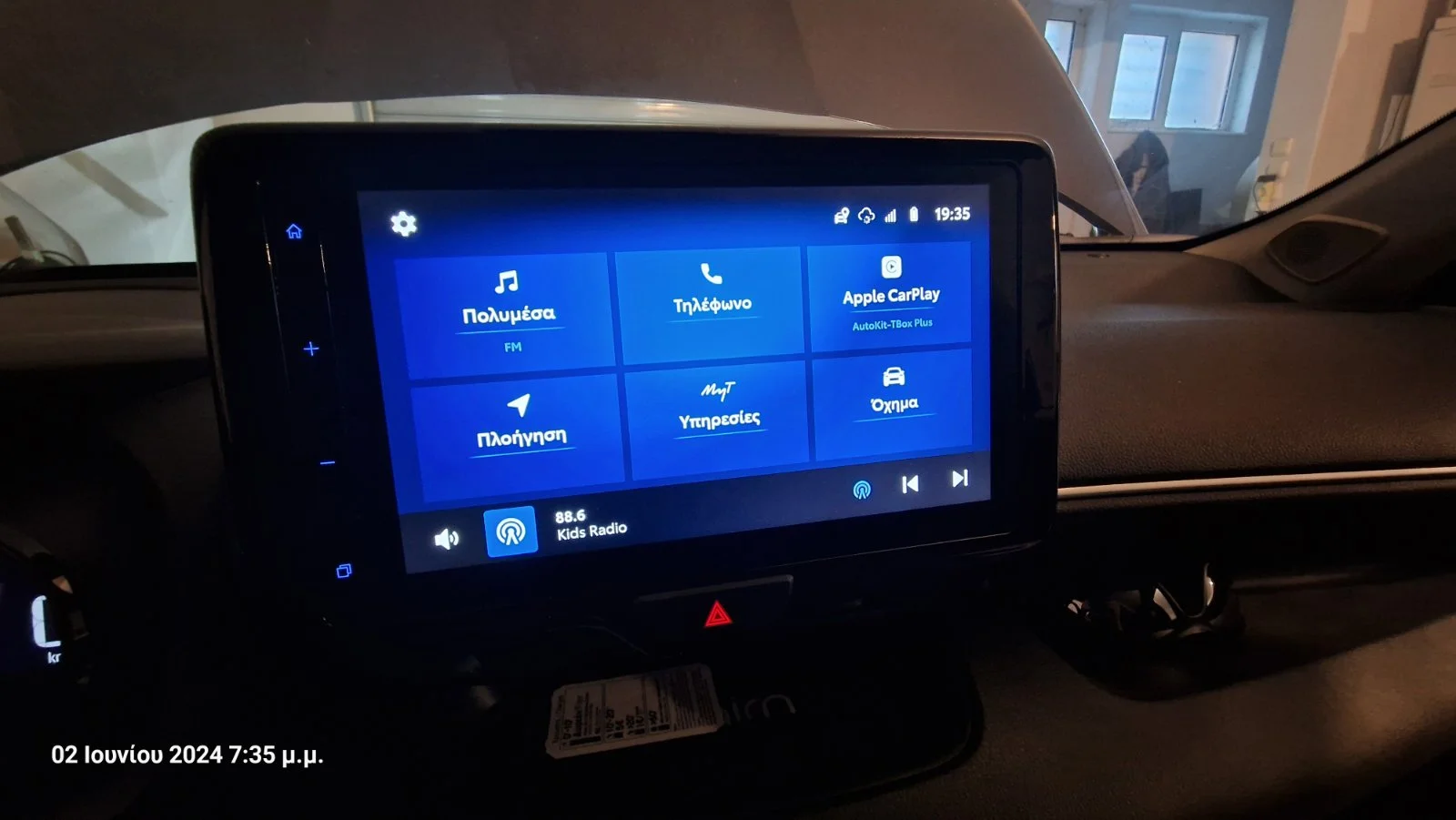

the surprise that it works too gps

Today I installed the screen and it works (mazda 2 hybrid )
I have an energy indicator, tire pressure and fuel gauge. Upgrade the software, everything is fine. Connecting to the carlinkit usb kit also worked. The watch also works well.
The only issue I have is a Pioneer GM D1004 amp I bought and don't know where to put it. behind the radio? will it all get hot enough together? or in the cupboard or under the seat, which will greatly increase the installation costView attachment 28413

inspired by the work shown on this post and especially by the experience of @takis1964 I decided to give it a go. I ordered a unit in very good conditions from Sweden, and tried to mount it. As already mentioned by other users there is a green cable that remains disconnected, at the same time there is a 5 pin socket that remains empty on the head unit. Here a picture:
After mounting it (everything else was 1:1 to the original head unit) I tested it. The main reason I wanted to swap the head unit was for native wireless CarPlay and this at least works. I was also a bit nervous about car metrics, energy flow and such, and I was surprised as this worked as well. My T services as already mentioned don't work, I am guessing due to the missing cable which I suppose is for the connection module.
What really disappointed me is that the update of the unit does not work, contrary to what other users observed. Furthermore the navigation does not load at all. I suppose these two problems are related to each other, what causes them is unknown at the moment. I attach also a picture of the error screen as I try to update the head unit and the version screen:

Good evening, the screen upgrade worked the next day. Do you connect the screen to wifi? I also connected it to the my t application and scanned a qr code. Then it login with the my t account and the screen is connected to the server.Then it does update
For the GPS, maybe the screen doesn't have it included? does it come from the simple model? I have installed carlinkit car box and I work on the map from there. Tuota's map is bad anyway

I have a normal Yaris, MY2020. I do have some connected services (unlock from phone, road assistance call through the car, …) so I suppose I have some kind of SIM card or similar installed somewhere, but it definitely wasn’t near the head unit. Furthermore I have GPS in my original head unit. I suppose these are the green, grey and white cables on the top row pf the head unit, with green being the LTE connection (which I didn’t have with the YP051 unit, and indeed I couldn’t connect to the myT services).
What bothers me the most is that the navigation tile was stuck on the loading “title” page (navigation with a map background). This suggested me the head unit is definitely abilitate to access navigation, but somehow maps or something were missing. Furthermore I really don’t interstate why the update would not work when con extend to a WiFi . This doesn’t make sense to me and I suppose these reason for this is a software problem with the unit, or the unit being somehow “locked”.
