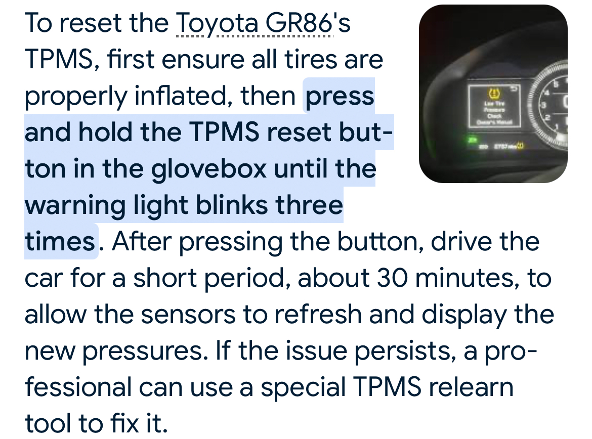

The button for resetting the system is in the glovebox (rhs). Below extract From Google AI:
If they are the same wheels and TPMS as originally fitted, their data will still be stored in the ECU, so you should not need a specialist tool and just have to go through the reset process as detailed in the user manual. It’s also in the TPMS thread.
I tried this and it did not work, multiple times. In the end re-activating the TPMS worked straight away.
Thanks both, I had to take it to kwik fit and they used the tool. I did actually see the image above and had given that a go but no good. Only cost £39 to get them re-linked which is better than having my pants pulled down like Toyota would have done.
