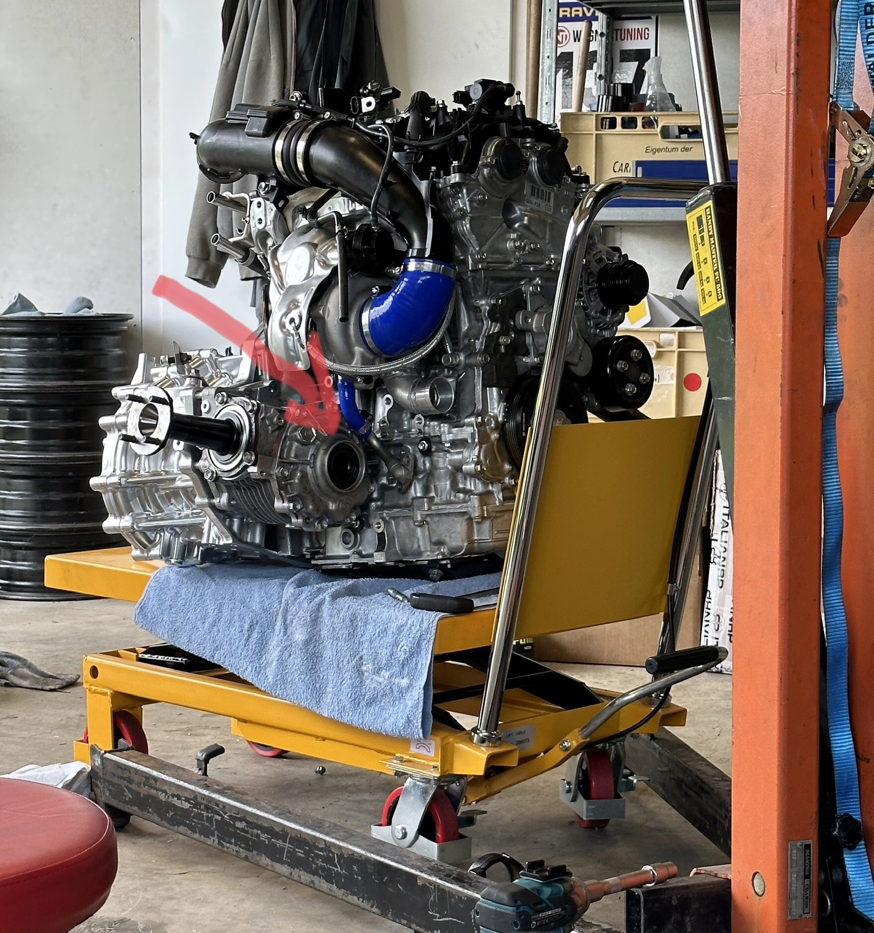

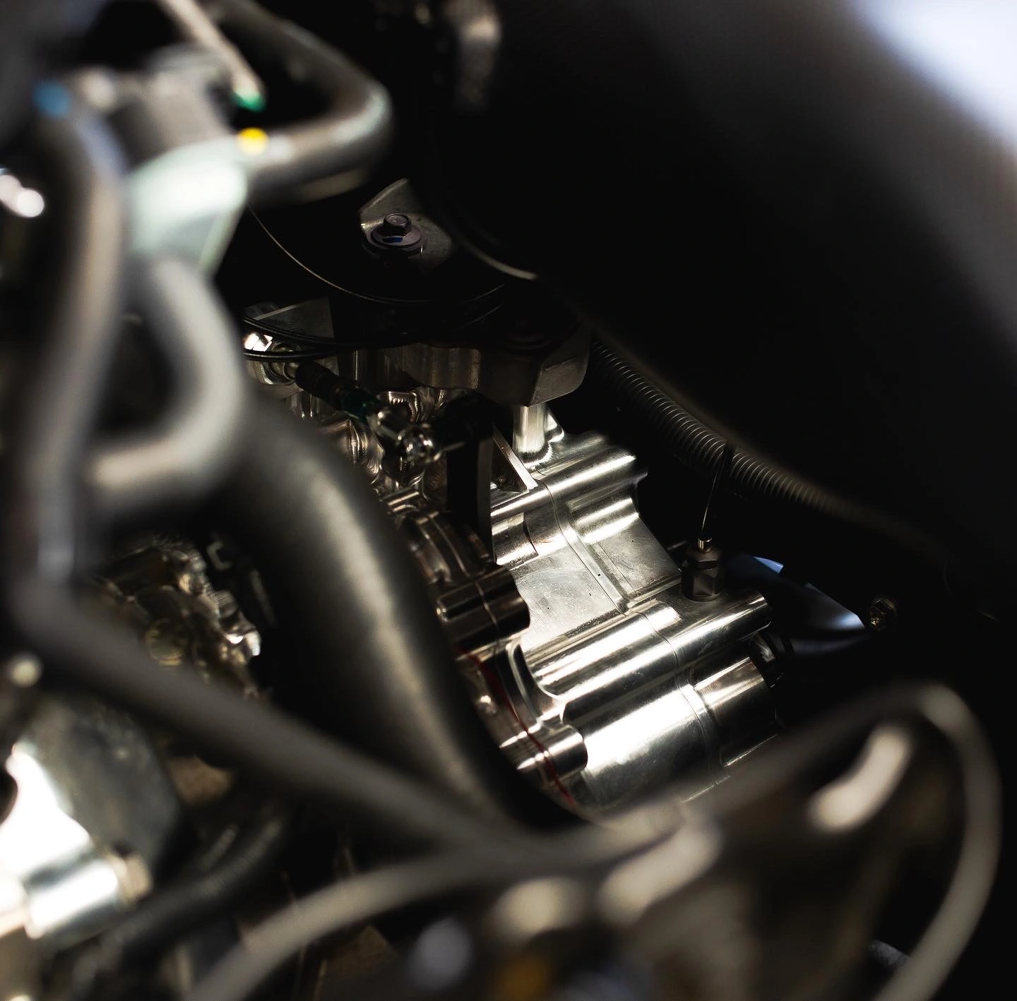

There is no oil pressure to talk about after the turbo to speak of so I don't see how it could fail?have to mention the turbo oil return pipe being silicone with a simple hose clap is a potential fail point, ideally should be solid steel pipe with gasket or threaded union

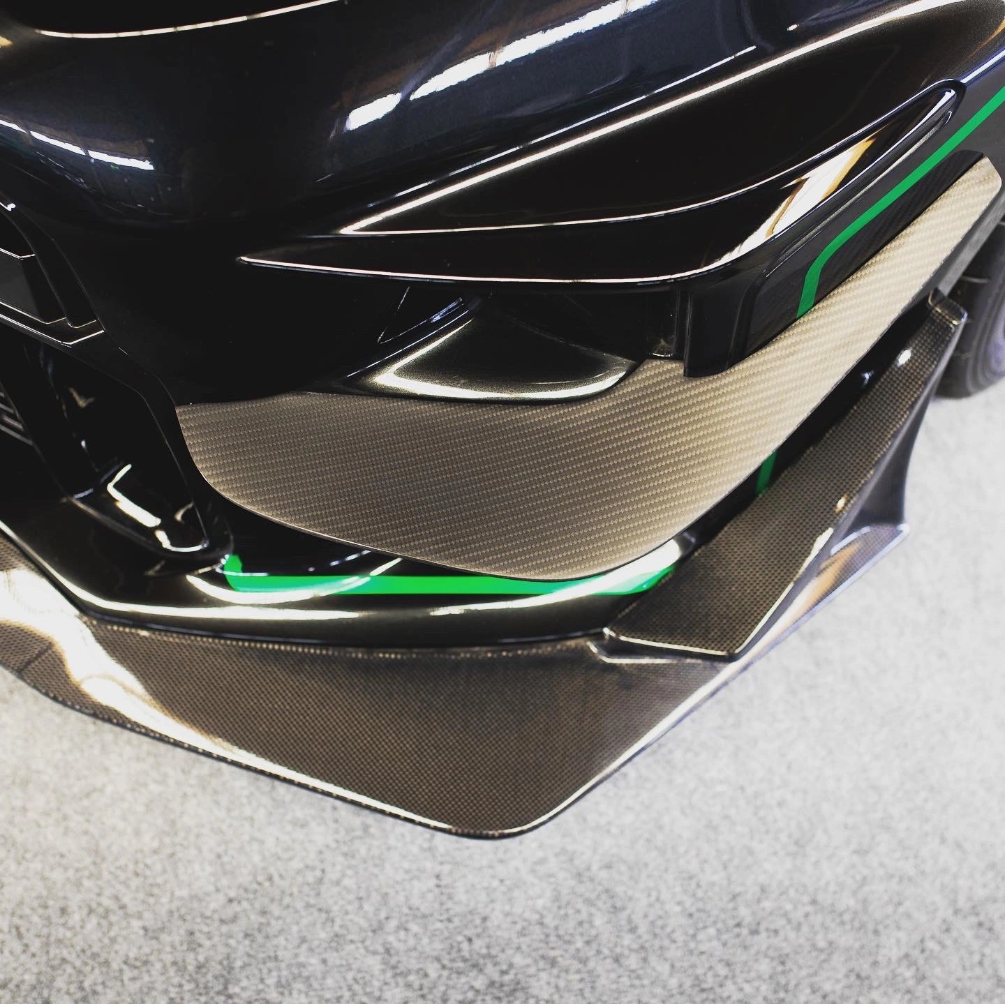

New Video about some of our new Carbon Aero Parts.
am aware no pressure its the way a Jubilee clip (not as bad as Miklor) pinches the silicon unevenly hot oil tends to find its way passed, ok for water and air but modern super slippery oils......personally wouldn't chance itThere is no oil pressure to talk about after the turbo to speak of so I don't see how it could fail?
I run the return like that on 2 diffrent turbocharged enginge (trackcars both so taking some abuse) without any problems...
Never had a leak there but certainly looking into it a little more at the next service.am aware no pressure its the way a Jubilee clip (not as bad as Miklor) pinches the silicon unevenly hot oil tends to find its way passed, ok for water and air but modern super slippery oils......personally wouldn't chance it
You‘ve got a good point.am aware no pressure its the way a Jubilee clip (not as bad as Miklor) pinches the silicon unevenly hot oil tends to find its way passed, ok for water and air but modern super slippery oils......personally wouldn't chance it
Like this?Just put the car together already...![]()
But the solid pipes tend to break because the turbo is only supported by the header and the bracket of the downpipe.
I know of three solid OEM pipes that did break and nearly caused fires because of it.
Because of that, i‘m perfectly happy with that solution, which we, run on all our track cars in the past years and never had any issues so far.

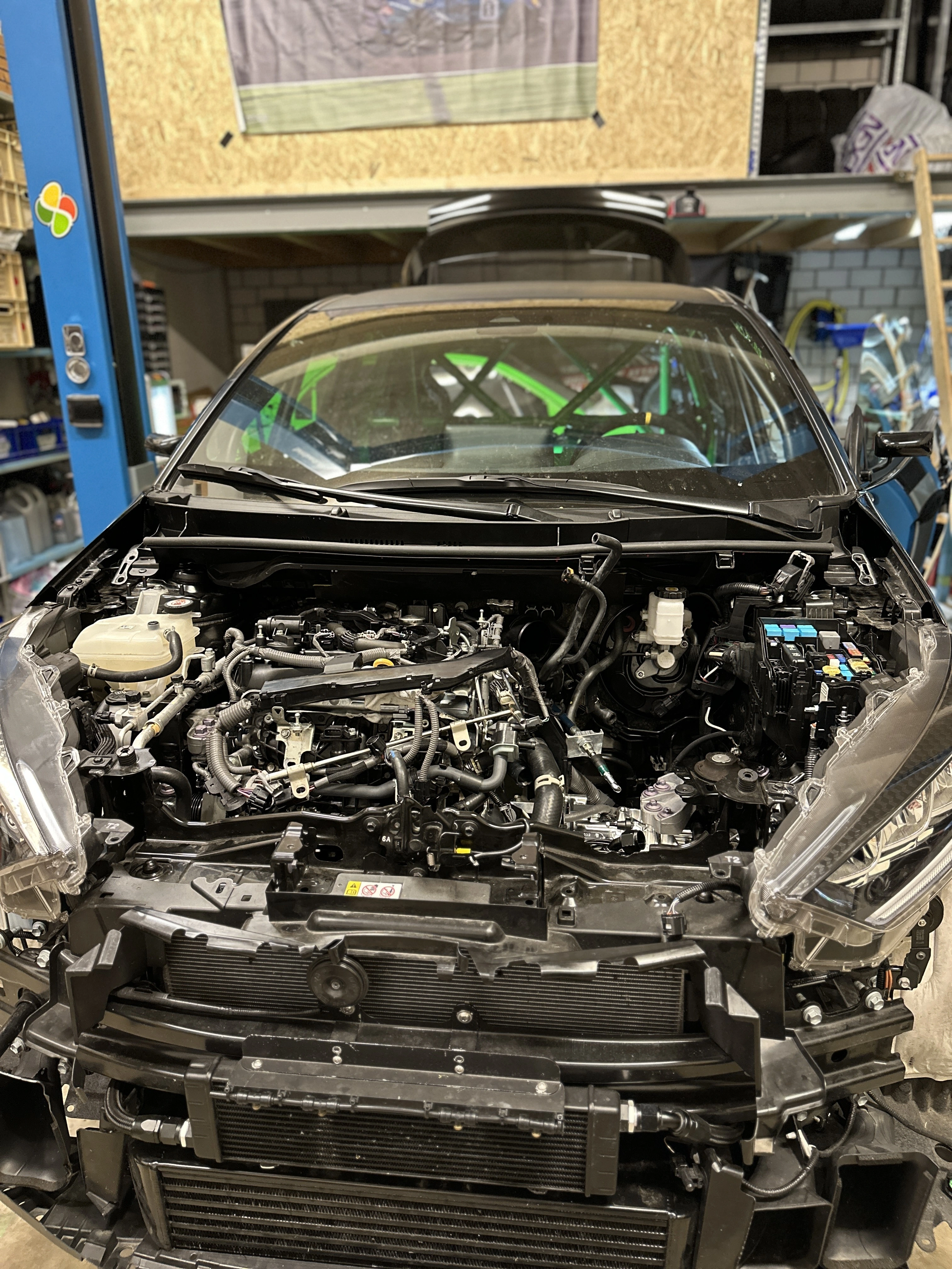

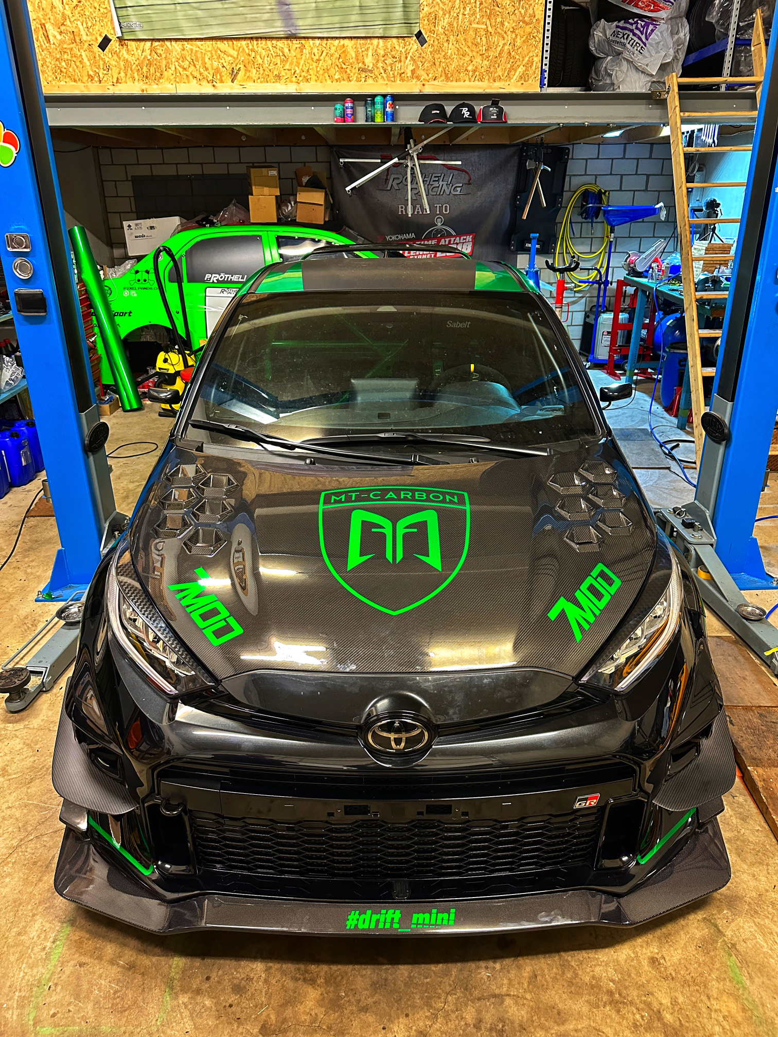

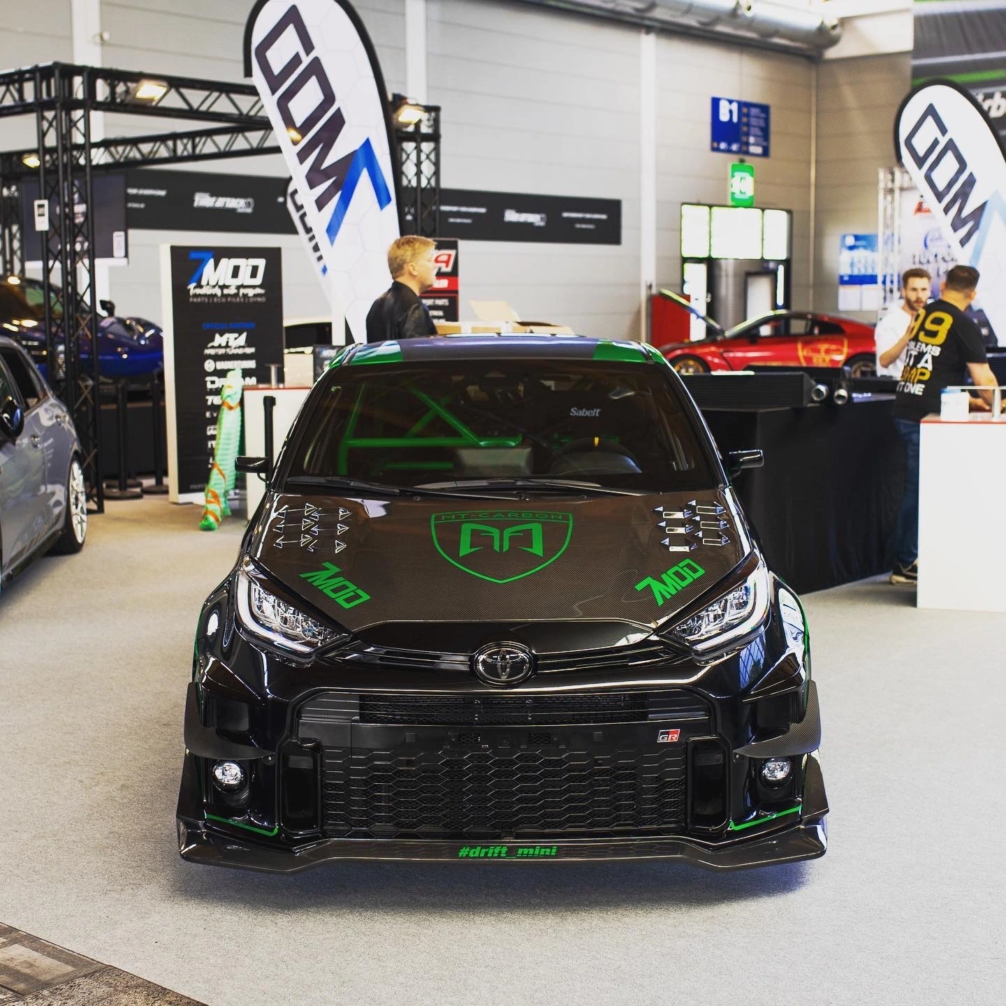

something different with the bonnet vents, very niceStill a lot left to do, but it runs, shifts gears and it‘s finally back on it‘s „feet“.
You want to see it live?
Visit us at Tuning World Bodensee 2023, in „The Motorsport Experience“ with 7Mod at Hallen-/Stand Nr. B1-207.
Kind of.Nice hood! Custom build? Has little Lambo vibes
Thanks Mate.something different with the bonnet vents, very nice
