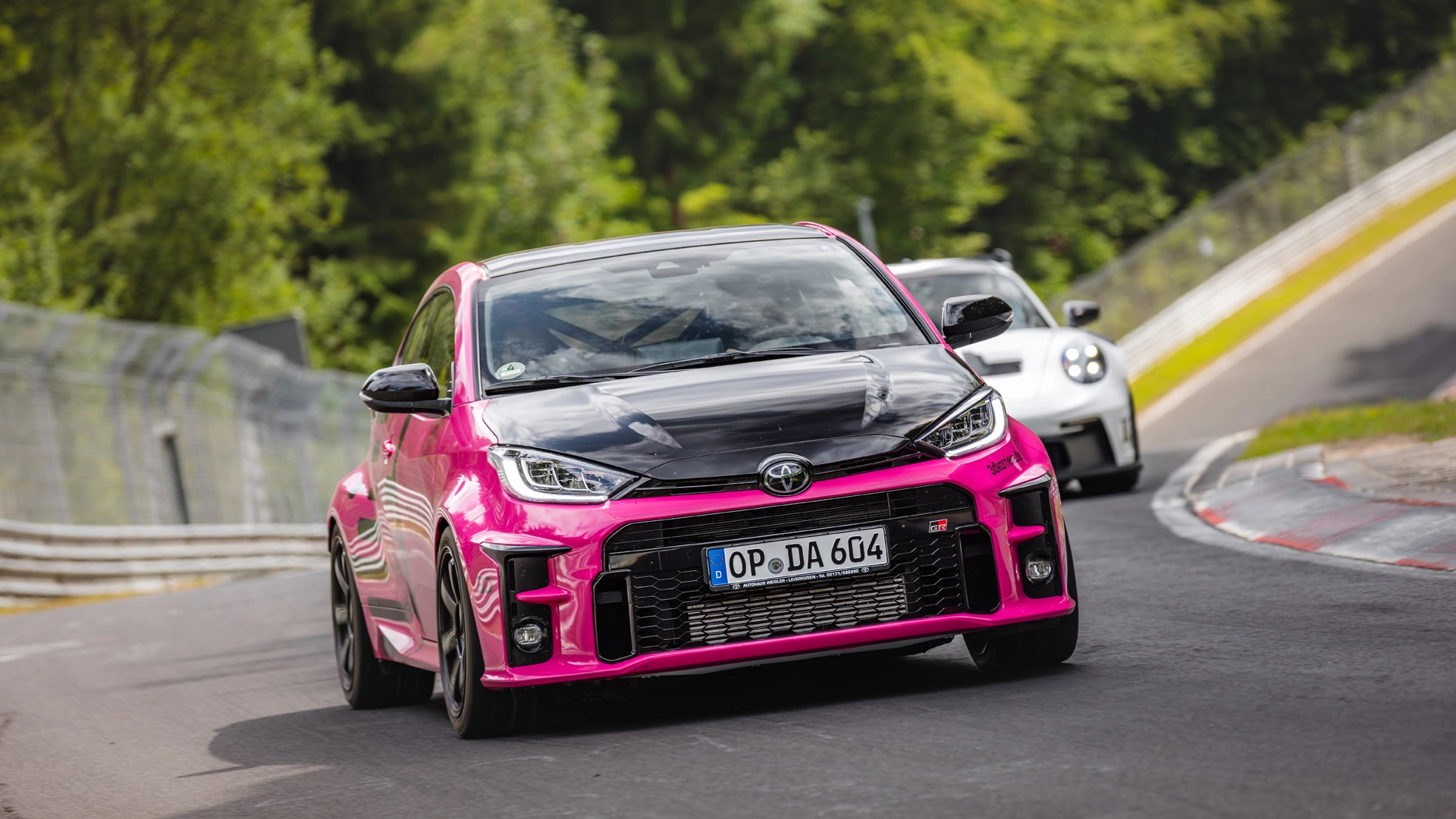

So, for the last 2 laps, I changed my suspension settings back to softer. I noticed that in some turns the car wasn’t as aggressive; however, in all those bumpy areas, I was able to fly over them with more confidence than before.
The steering choppiness in those hard turn was gone. I would only feel a bit of it in the second carrousel. As you can see from this pic, I wasn’t exactly taking it easy at all anymore.
Please keep in mind that I only have two clean laps so far without any steering issues.
There is a good chance that I will bitch about it again after my next laps on the Nordschleife.
