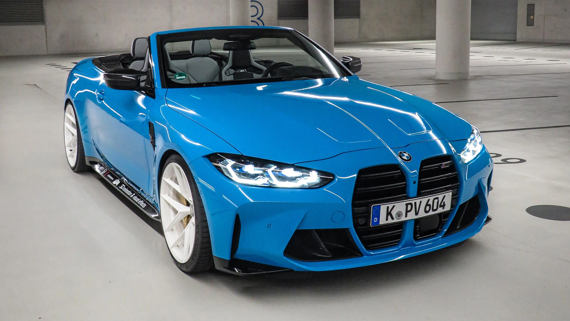

I also have an G83 M4 in riviera blue which is my daily.. if you guys like, follow me on IG: @blues_clues_g83
