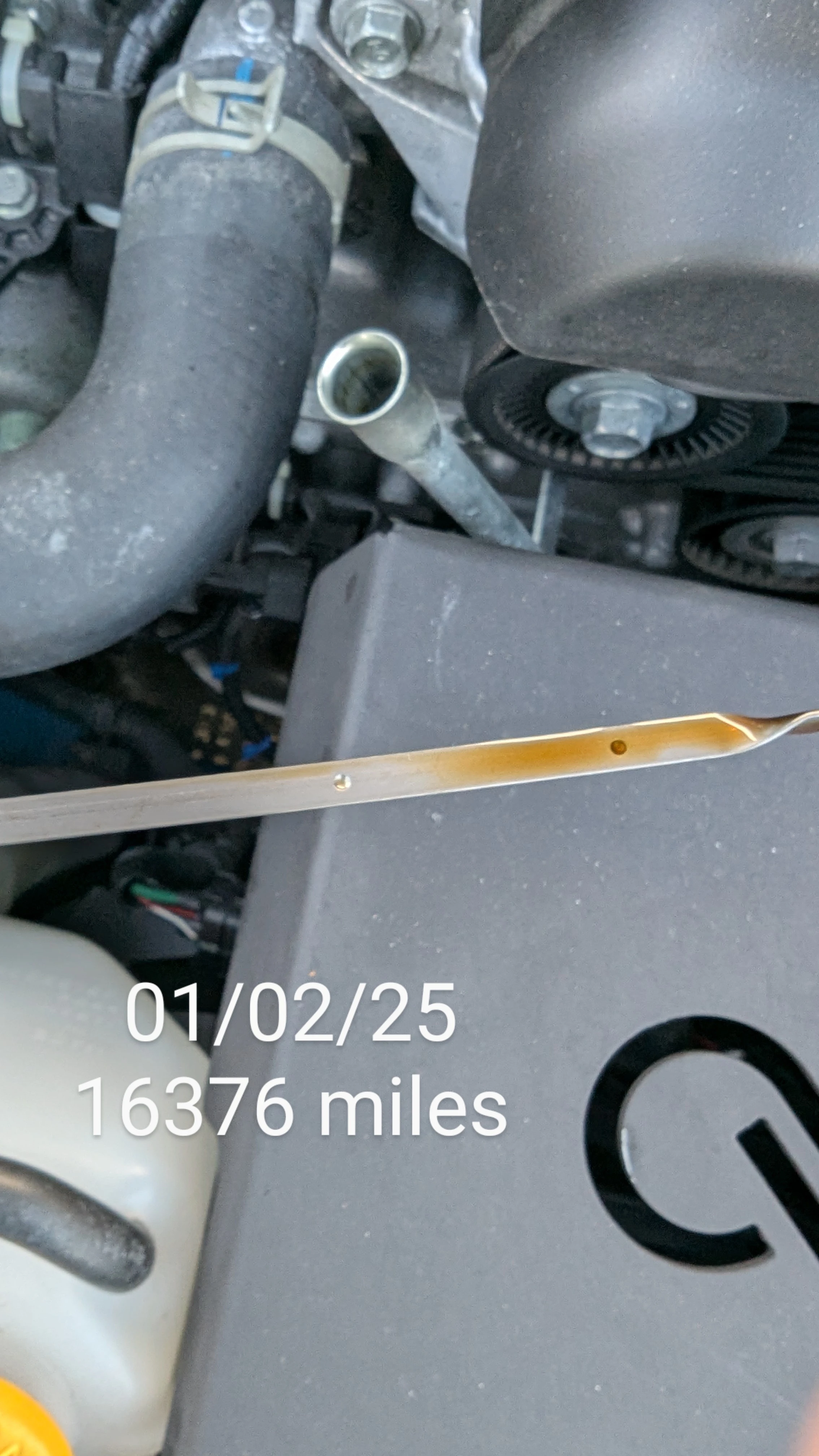

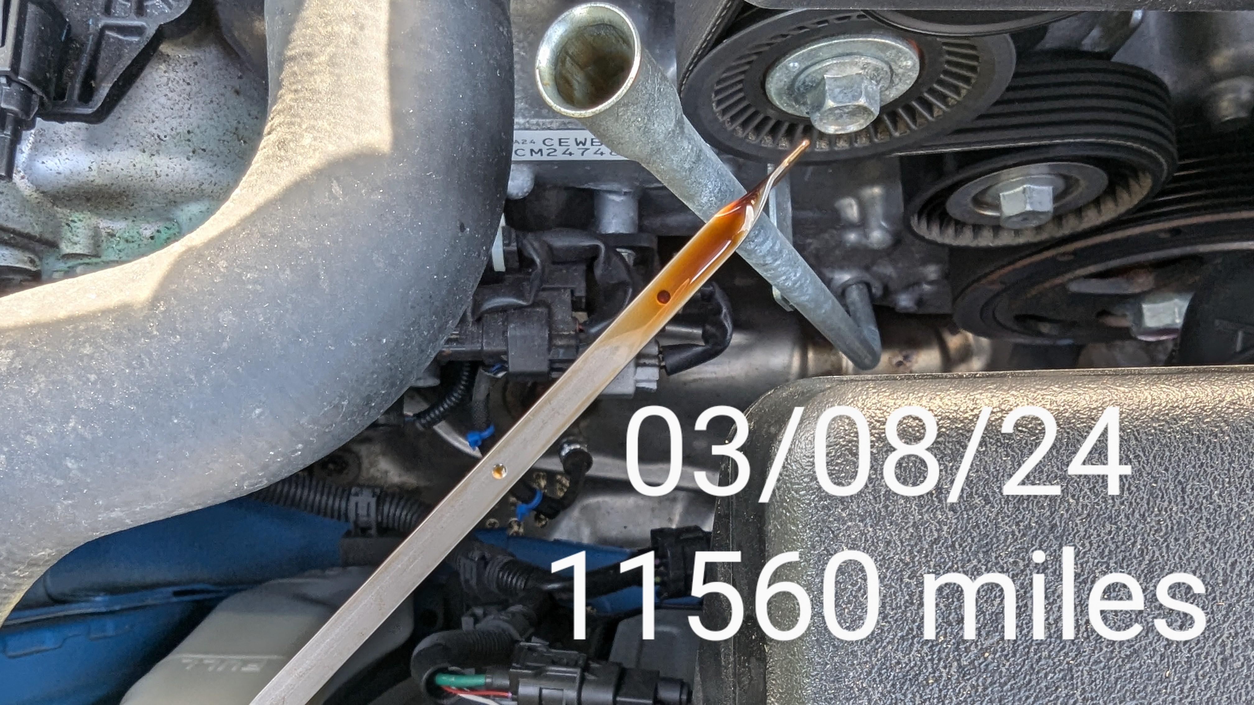

I had my original oil that came with the car changed at ~1400-1500 miles in mid Jan this year, then noticed the oil level had gone down to as shown in the photo above come end of Aug, it had done just shy of 10k miles then. This means the car used some ~700-800ml of oil in just under 8200 miles. So bought 1L of Toyota original 0W-20 oil and gave it about 300 ml. Had my 1st annual service done 3 weeks early in Sep by then it’d done 11k miles. Now nearly 2 months later & at 13k miles and by the dipstick I reckon it used ~200 ml of oil from the top of the dipstick. Normal or not?
Yes this looks normal. These engines do use oil. Best advice is to check the oil regularly say every couple of weeks and keep topped up to the max line (or slightly above). Having owned a couple of BRZs before the GR I found I could sometimes go 5K without any obvious consumption and on other occasions I would see a drop after 500 miles. A regular check is a must IMO.
Think my oil consumption might have slowed since the last service, which was on the 24/10. 3 months and one week later, and just a shade over 2k miles...don't think the level has dropped at all.
That said, it's also been winter so I'm not going in regular hard drives for fun. Will keep an eye on it.
