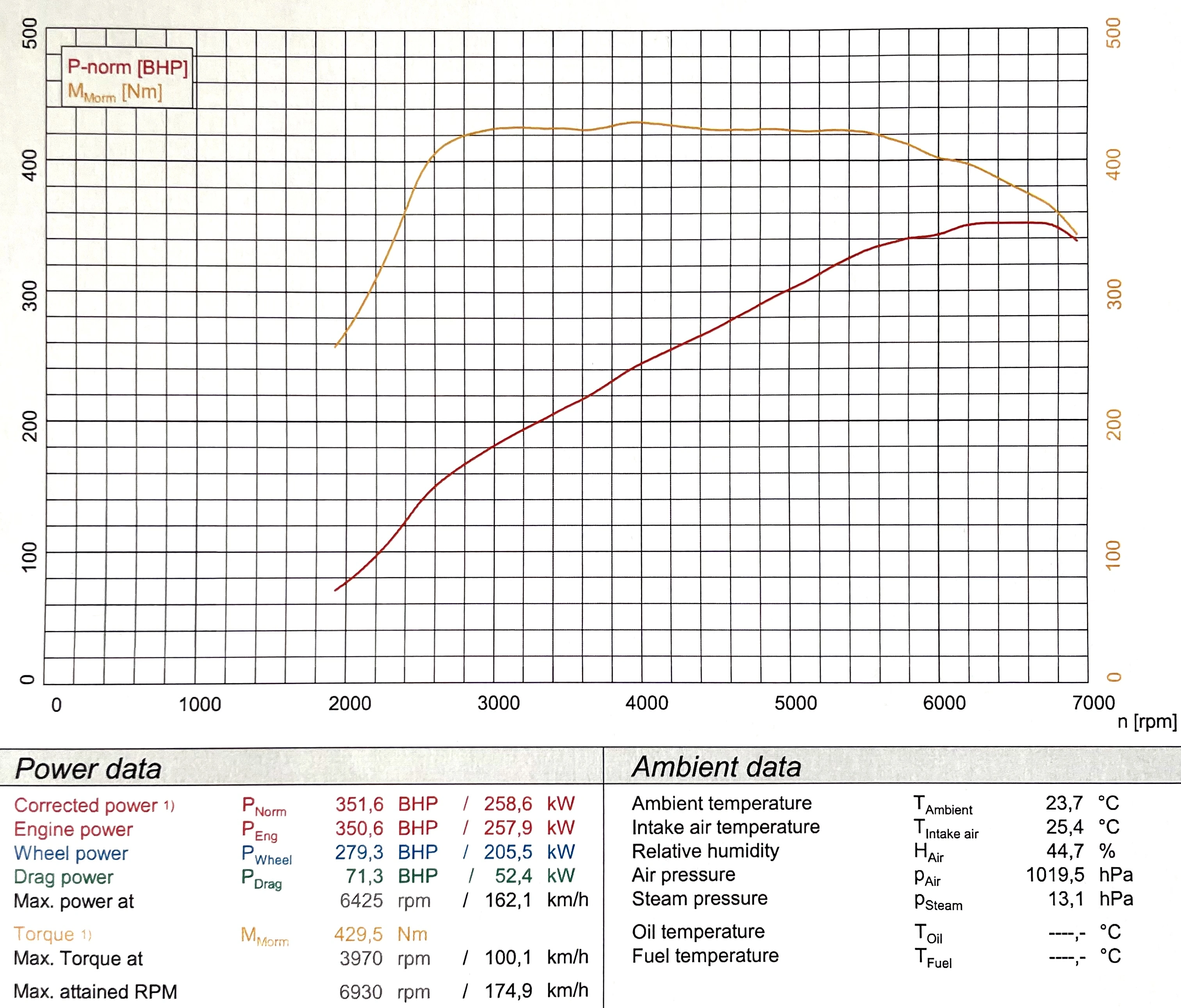

After a bit of a delay I’ve got round one of the tuning results.
Hardware list is:
-Syvecs
-Airtec IC, boost pipes, turbo elbow
-ITG panel filter
-Kelford valve springs
So, deliberately left stock Cat/GPF/Exhaust for initial tuning.
Reason for this experiment was:
-to see how valve springs in isolation compare to others results with no springs but full turbo back exhausts (which cost much more than changing springs)
340bhp/420nm. At 1.7 bar.
Area under the curve from 2.3k to 6k is immense. Despite similar peak figures from ECU tuning one of the clear advantages to Syvecs is the torque spread (I’d hope so for the price!) note, still some squiffy differential stuff at 5.5k to ignore, and very top end wasn’t refined as this isn’t the final hardware state.
Also, the “before”here is with the mods, but stock ECU:
One observation is despite the valve springs there is still torque roll off around 6k. So it seems both the stock valve springs (as per others results) and the stock exhaust system are limitations at this level.
Next step is adding a HJS sports cat down pipe.
After this is I guess next limitation will be the stock turbo.
Closest comparison for similar setup but with exhaust but not springs is Pumaspeed’s 350 kit (Syvecs, IC, pipes, elbow, panel filter, Miltek sports cat/GPF delete/GPF back exhaust):
So interpolating to 1.7bar it’s an exact match (340bhp/420nm), difference is just the curve shape.
So it seems different routes to same results, depending on if you want the louder exhaust note, or peace of mind if springs.
No right or wrong answer, but hope this comparison is of interest to the Zoo!

I’ve now got the car back, but not had a chance to use it too much yet.
Sedate 100 miles on motorways gave 45mpg, which was a nice bonus.
I can report however that the biggest unsung benefit of Syvecs is that hard breaking no longer triggers the hazzards!
That will improve A to B times more than the power increase, as I was only ever breaking to the sensor threshold for fear of looking like a tit to anyone nearby. Hated that feature more than the high seats or low mirror etc.
Back to the tuning, the HJS downpipe was fitted, OPF and rest of the exhaust remained stock. Pick up over OEM cat was 10bhp/10nm, so the OPF and standard turbo exhaust housing are a restriction, causing the torque dip post 6k.
Still, torque curve that flat from 2.5k to 6k, then flat power to 7k feels great to drive. Feels much happier to rev now.
This is running 1.7bar boost. Tapers to 1.5bar at the redline, as it makes no more power running it higher, compressor must be well out of its efficiency range.
Will get some GPS performance results when I have a chance.
Tuner was Ricky from RE Performance in Swindon. Would highly recommend.

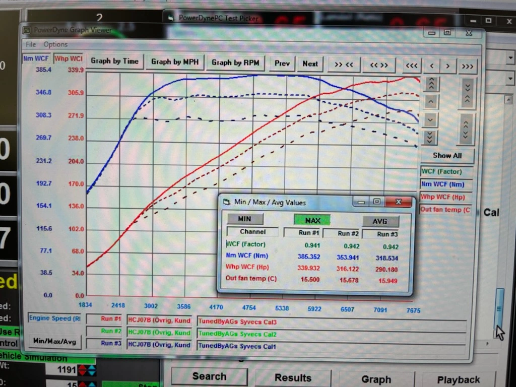

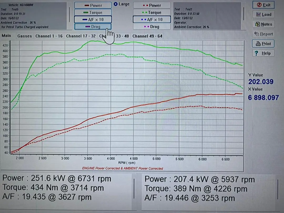

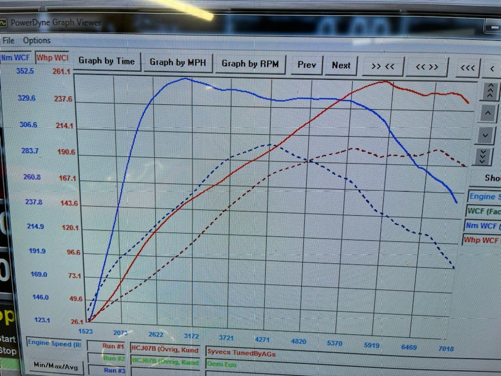

Don't have a dyno on only cams but this is when I first tuned with Syvecs on everything else stock accept exhaust. Milltek turboback with sportscat.
And then with cams and a slightly bigger turbo...
You can tell it nnow likes to rev! Don't know if stock turbo could hold boost all the way but the diffrence is huge!
Thanks for the charts - looks like Syvecs makes the biggest overall difference, then turbo and cams are more of incremental improvements.
Overall silly figures, your car must feel like a rocket!
