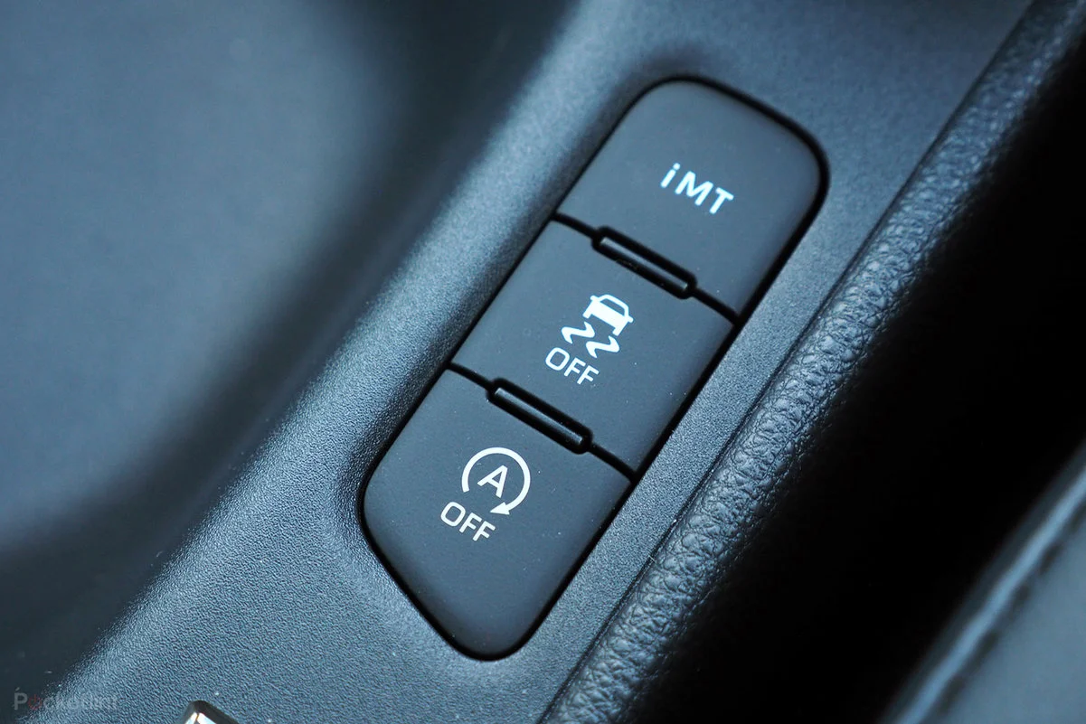

TC is the first thing I turn off when I jump in the car. I can't even remember what it's like with it on. 😄
Press and hold the middle button for a few seconds.
