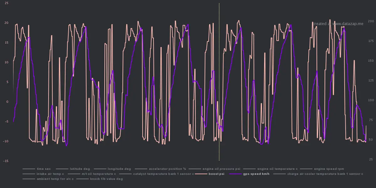

Your data interval is 1s (try logging fewer things and you should be able to log at 5hz), so it's hard to make any conclusions but it looks like boost was still rising the two times you were at 100% throttle. Not sure what gear you were in but boost in 1st and 2nd seems to be lower (around 15psi)So I bought a OBDLink MX+ and have just been waiting for the car to play up so that I can log it. Today I managed to log full throttle with the issue. Timing advance seem to be ok and commanded/actual boost are withing 1-2 psi of each other but around 7 psi lower than it should be. Below is a link to the log. Maybe someone else will see something in the data that I can't.
