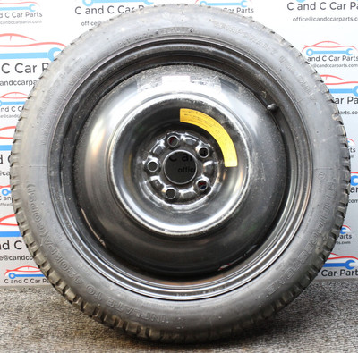

This Wheel Turned up on Toyota Direct Parts, without Rubber.
I was wondering if this fit our GR86s and is a space saver spare. Doing a search on the SKU Part number yielded nothing concrete.
Yes it should do, unless you're running a big brake kit. I had a space saver that fit my GT and it now fits my GR.

Get a spaace saver wheel from the Impreza STI with 5x100 bolt pattern. I had the foresight to do that on mine as I had fitted brembos. The wheel is old now , so you'll need a fresh new tyre too, I wouldn't feel happy running a 20yr old tyre even as a temp spare.
