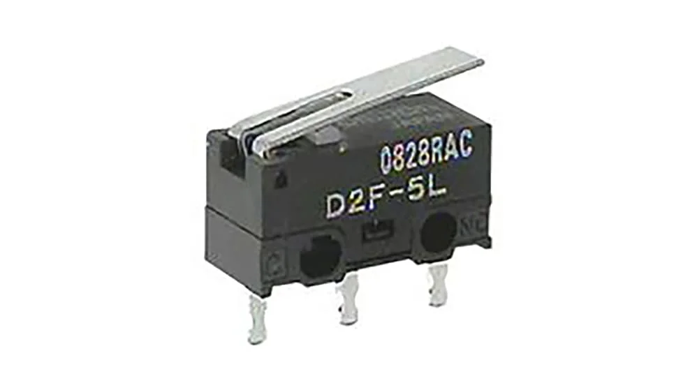

Do you still have access to that manual? Does it say how many amps and volts the DAT8 paddles have?
One doesn't really need a service manual to answer that one :)
Paddles don't really have volts or amps, they're just simple switches telling the ECU what you want to do, not miniature power stations waiting to light a bulb. If you're asking about current draw, it's down in the 'hardly measurable' range.
I'd be careful here, if you're planning mods on that assumption, it's a bit like trying to measure the temperature with a ruler. Probably best to get a clearer picture of how the system works before reaching for the soldering iron ;)

because I saw some paddles with micro switches (large ones, for example 250V 15A) and I had a doubt… wondering why they used such large switches if it's not necessary… let's say that I already know how to make the modification and I know very well how to make the connections etc. but I was stuck on the choice of the size of these micro switches…
Edit: Some people put the first ones and I don't understand the point of putting them so big, I was thinking about the second ones... much smaller but also with a lower "capacity"

In 12V cars you normally won't see more than 12-14.5V on control circuits, so any switch rated for that will be fine. The current flow across the switch is typically only in the milliamp range, so even a 1A switch is more than enough. That said, car electrics can throw the occasional voltage spike above 14.5V, that's why using automotive parts is safer bet as they're designed to handle it.
It's also worth paying a few euros to check the manuals and see how the paddle control circuit is wired. Additional components may be needed to make the circuit work properly. I only buy access to the manuals when I need them.

The circuit works with just 1 of those for each paddle... nothing else is needed, there's no need to check the entire control circuit... I know because someone else did it for me 😂... I bought aftermarket paddles that work great on my car but I don't like some details, so I took them apart and disassembled them and looked at the components.... Precisely because I don't like the aftermarket ones, I want to make my own... but I was wondering why they used such large microswitches on such low currents... because if I could use small ones, it makes the design easier... but do you think it's better to stick with the larger ones like they did? But I'll try to look at the circuit on the site you gave me, I hope to understand what it's for... 😅
Edit: I'll explain everything briefly so we can give context to this thing: I have a disability in one arm (I can't move my left arm)... so I looked for a WRC style paddle (you pull to increase the gear, push to change the gear)... but it's not easy to do in such a small space and no one starts making them because it's a niche product... but I found a company here in Italy that was designing them (RSI C6), they made them in 3D printing... problems right from the start, quite hard to press, if you press the paddle on the tip up or down it flexes but you can't make it click (maybe the magnets are too hard for it to be all plastic)... I agreed with them after the summer we would meet to solve it... in the meantime I had another problem, when you pulled to increase the gear, sometimes it blocked and you had to push to make it go back (maybe because of the heat that modified the plastic?!?!)... from there I wrote them a thousand messages and a thousand emails for assistance and to solve the problem but they disappeared... paid (450 euros 1 double paddle)... so for a challenge and out of anger I started looking at how theirs are made and I started designing my own version to then make them in aluminum... and the last unknown that remains for me is that microswitch... they used the big ones instead I wanted to put the small ones to solve the space problems that their paddles have... but I'm not overly expert so either I follow their circuit (which I know works) or I try my luck with the small one...
