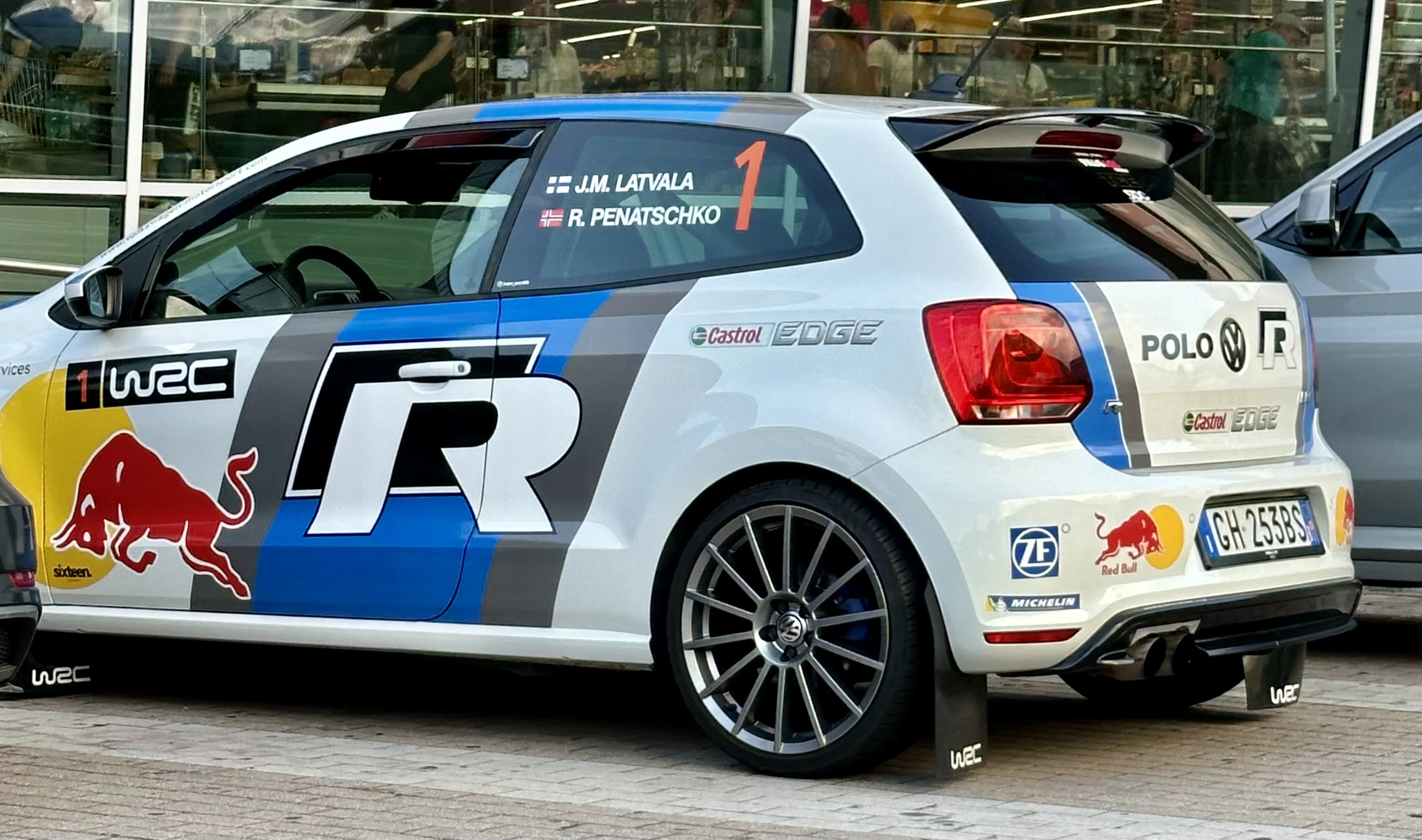

Saw this car yesterday in front of my supermarket. Unfortunately I didn’t look him up right then&there, but did today:
„Starting in 2021, he (Latvala) served as the team principal of Toyota Gazoo Racing WRT, replacing Tommi Mäkinen.[1]“(!)
Damn, I’m still so ignorant about WRC and GR‘s history…
Should have asked him about the eternal manual vs AT debate😉
I’ll keep looking, maybe I’ll see him again…
That's so great! Keep a closed eye on it, and wait for the driver to come pick it up! :D
