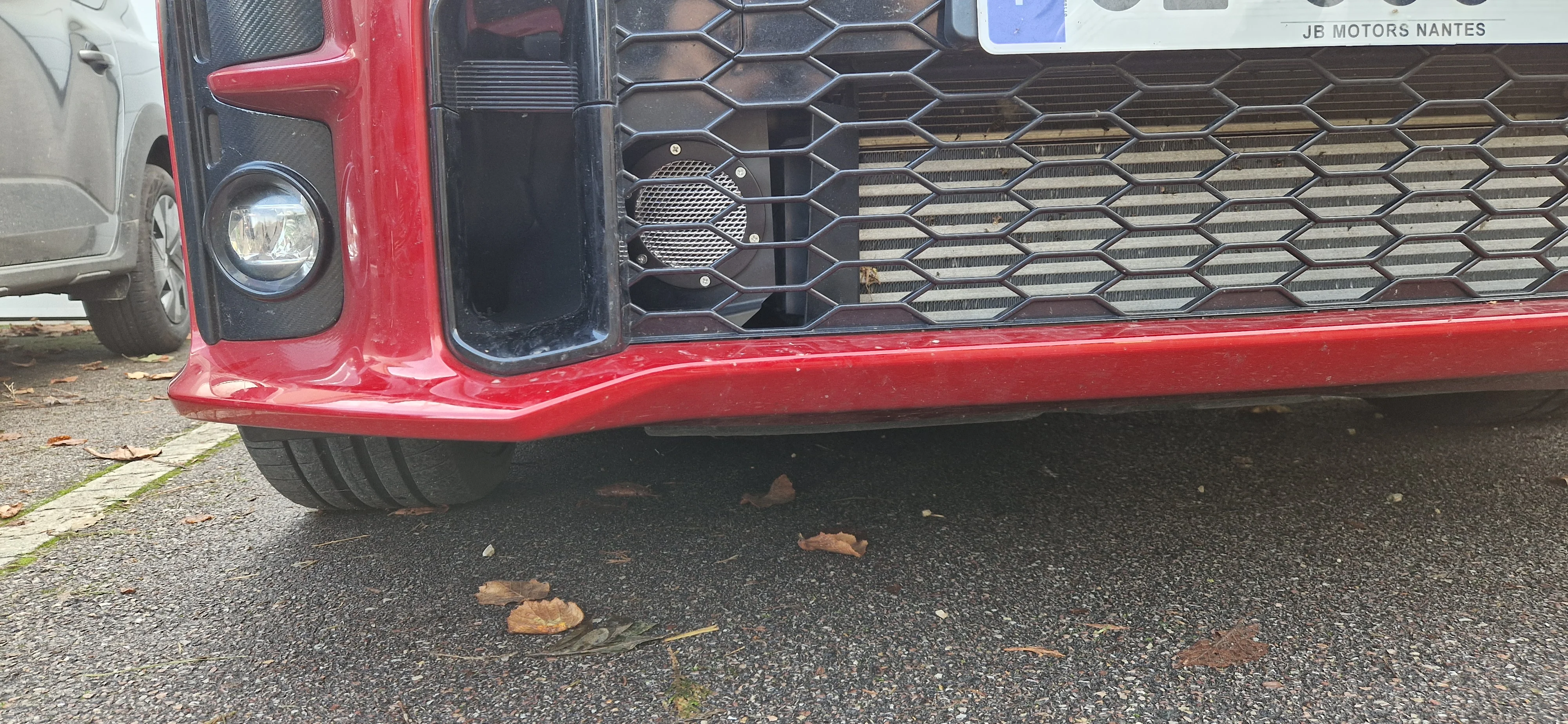

Finally did the DIY air duct ! Very happy with how it looks. I have yet to try getting the car warm enough to see an effect since I have also done pads, brake fluid, good cleaning of calipers & discs. I need to bed in pads properly so no blasting for now. We measured discs and they are not wrapped. So far, vibrations are gone !
I can say that the car still warm up at the same speed at 14° ambiant.
