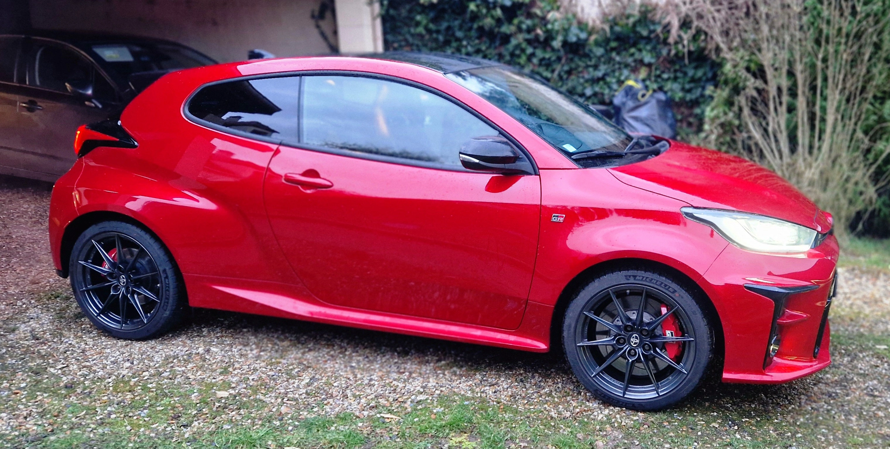

Hey everyone,
New GR Yaris from France here!
Full stock except tegiwa mirror riser.

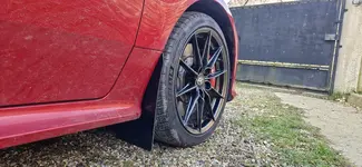

I am probably going to keep it stock except for the torque mount insert and mud flaps. As you can see in the second picture, I have a few opportunities to drift it in the mud and I noticed 2 small stone chips after a drift session...
So rallyFlapZ are coming. Probably installing them this weekend:)
Hey everyone,
View attachment 34172View attachment 34174

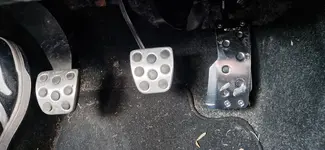

Also fitted a cusco pedal extension prior to the trackday. Easy to fit, really good, finally I can heel&toe properly with this car. The turbo lag make it a bit harder than my previous DC2 ect but it's fine.
