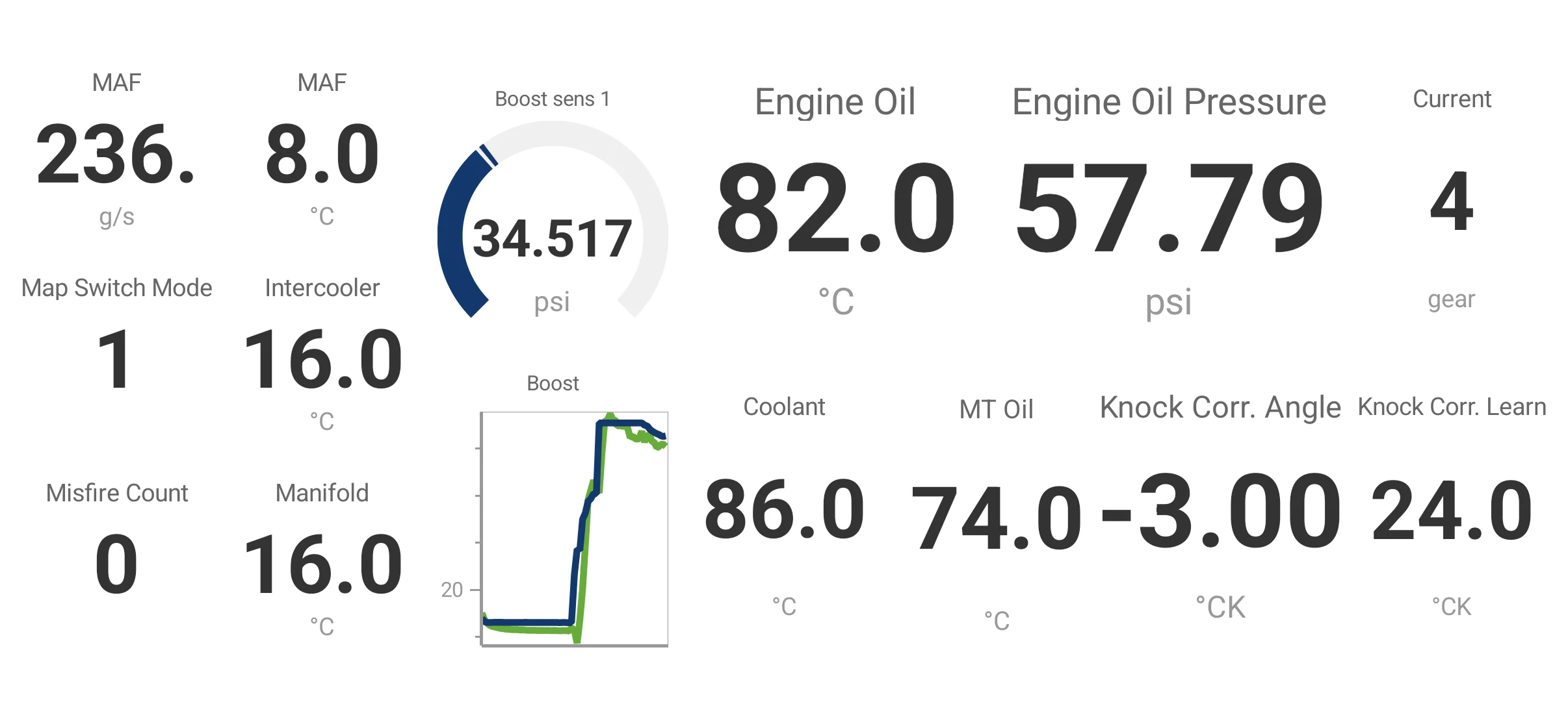

Logging any Knock?Now this is interesting. I do have strengthened gearbox fitted along with a new clutch (Exedy?) but pretty sure they left the OEM flywheel. Hmmm!

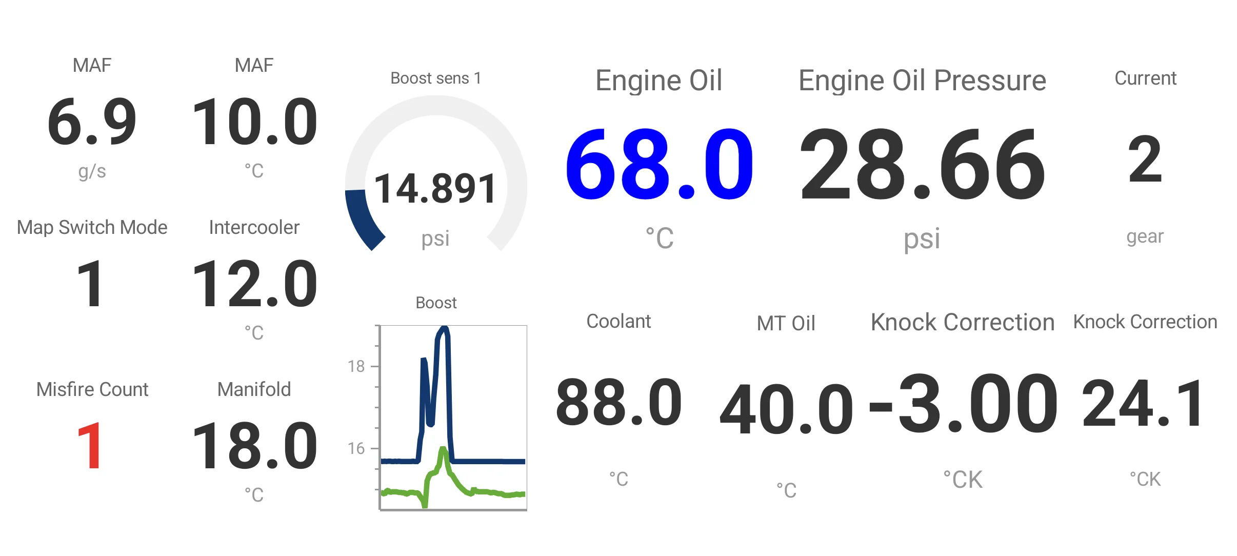

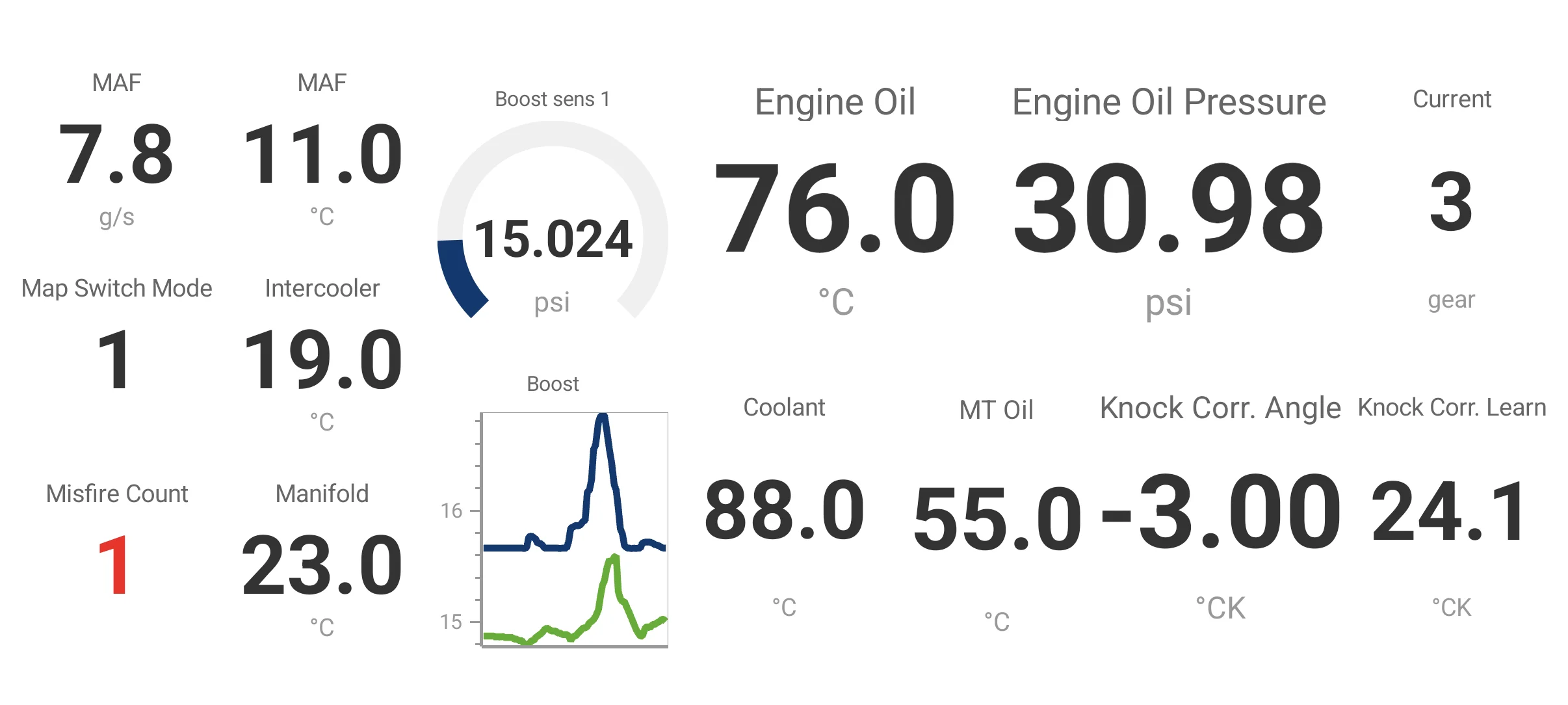

I am getting some random misfires in the 1-2 range when I’m engaging the clutchNot at idle but what if you lift the clutch to bite and inch forward or back? You might need to let it warm a bit first and try a few times please. I'm really hoping this is normal![]()
Tuned or standard?I am getting some random misfires in the 1-2 range when I’m engaging the clutch
Good to know, thanks! I think this is nothing to worry about.I am getting some random misfires in the 1-2 range when I’m engaging the clutch
Tuned with Artec turbo and A camsTuned or standard?
