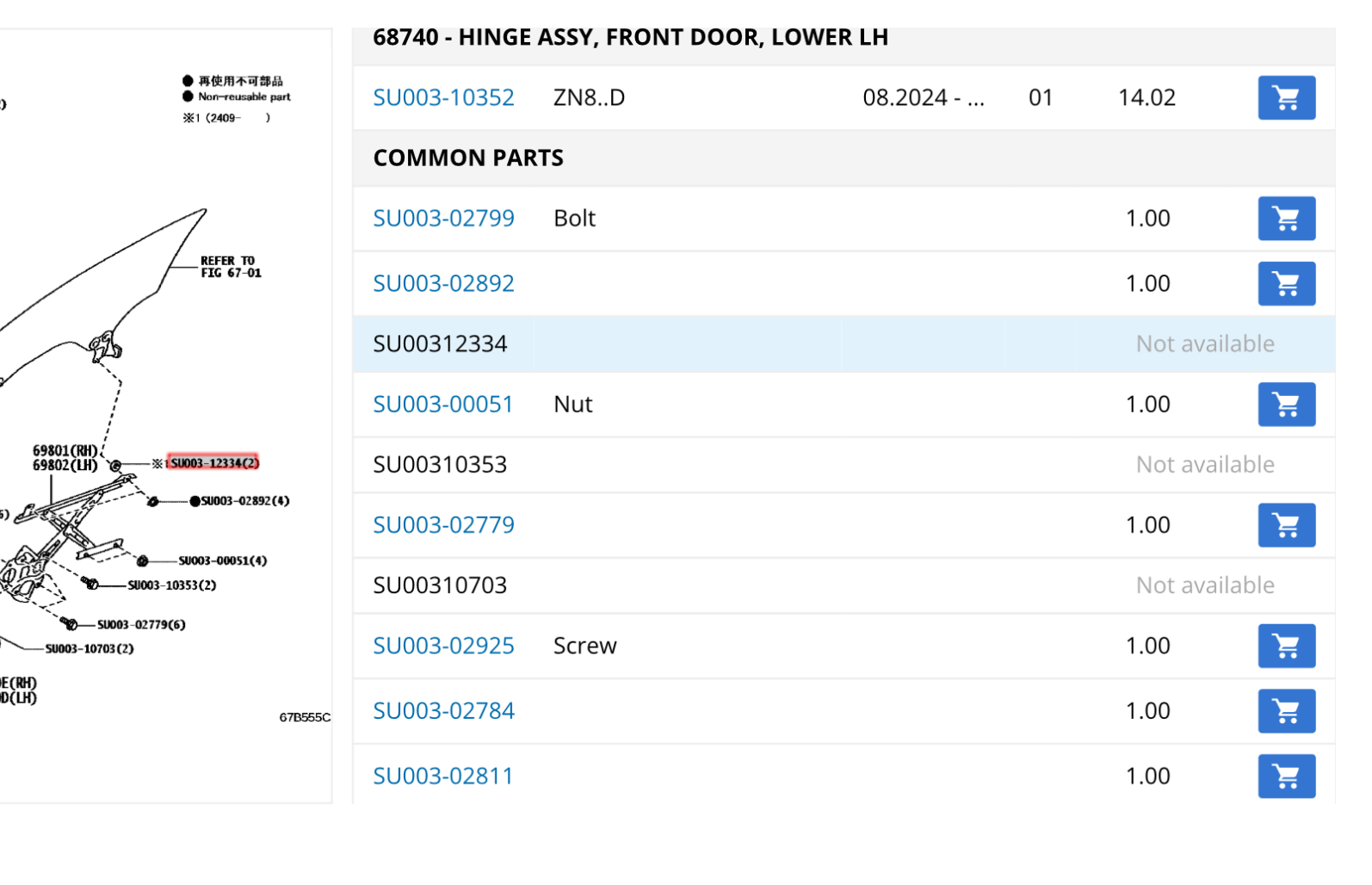

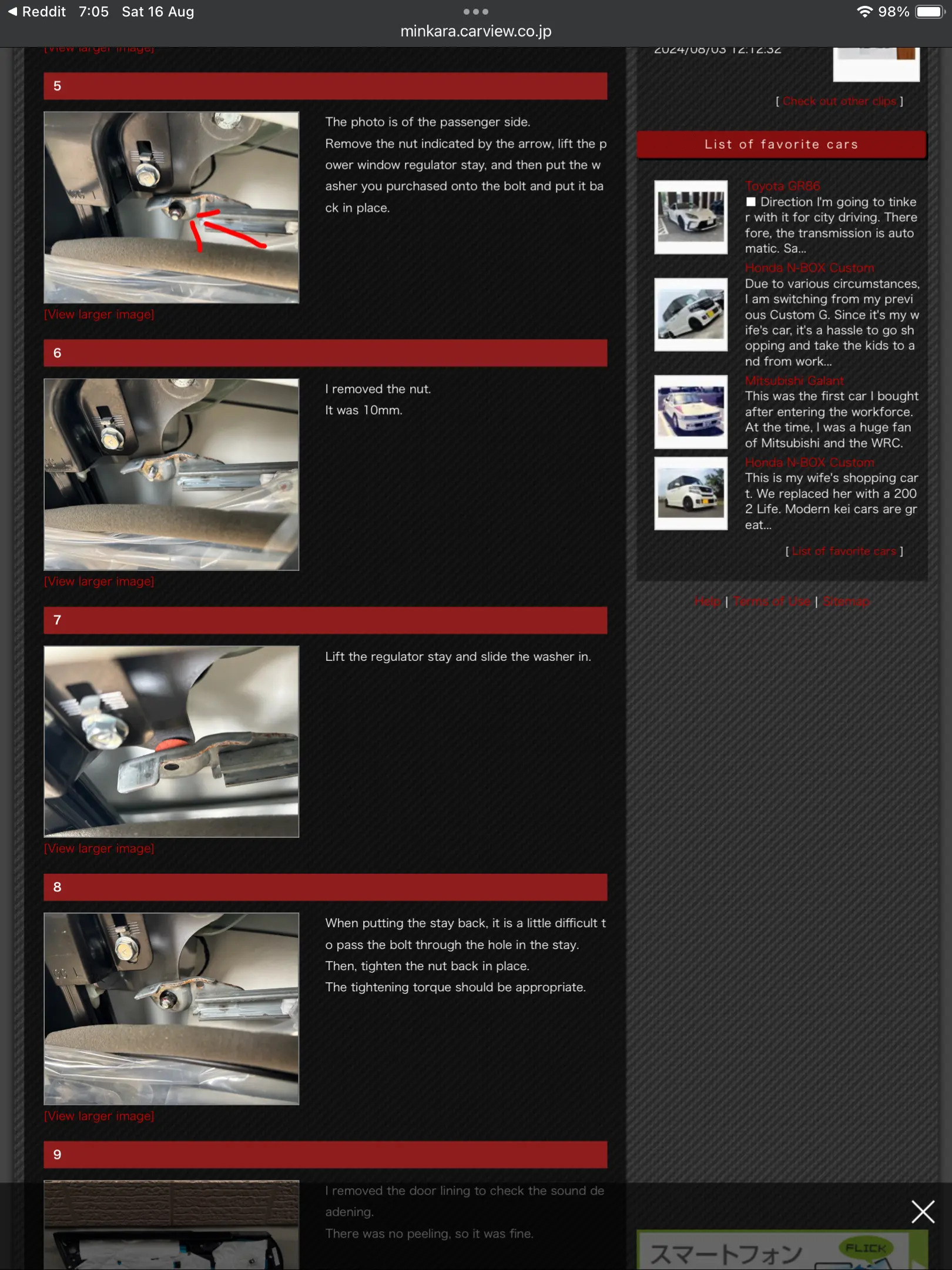

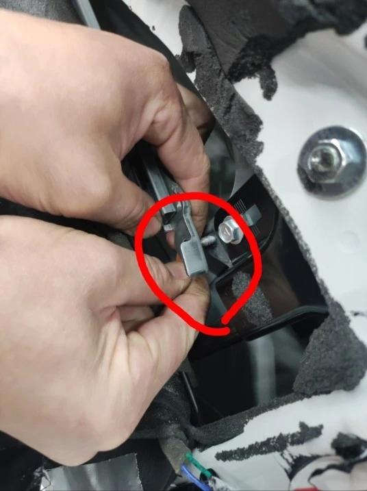

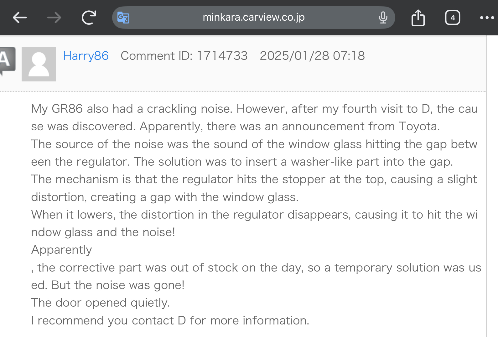

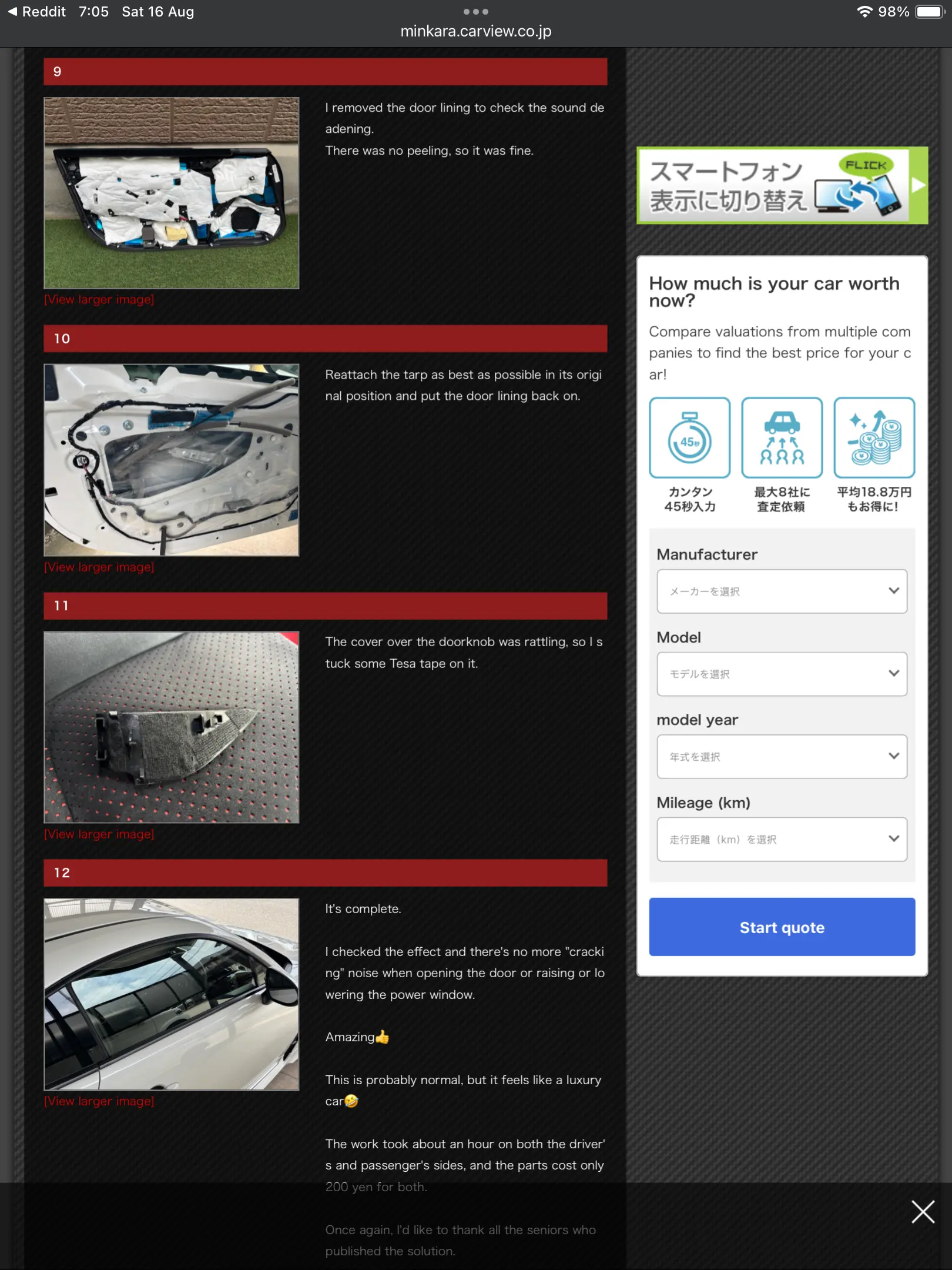

Let us know if they come back to you. Although it looks pretty straightforward, it does mean peeling that weather liner back and that's not something I want to do several times as eventually it might break down enough not to stick. So if it's possible to get hold of the new part easily I'll wait, rather than just attempting it with a standard washer.Ah this is great. So glad there is finally a fix for this, and also one which is so ridiculously simple.
I've sent an email to Toyota Direct Parts to see if they can get hold of SU003-12334, with the hope they will stock it so we can just buy it straight off the website.
I must be the only one with this happening to my passenger windowAs an addendum, I wonder why it only ever seems to be one window which clicks, and why it seems to differ by region. From everything I've read, it always seems to be only the drivers door at fault, whether LHD or RHD. Obviously the window regulators must be handed depending on their fitted side, but if the flaw is to do with the design of that specific pivot point, you'd expect it to affect the same side for all cars. Curious.

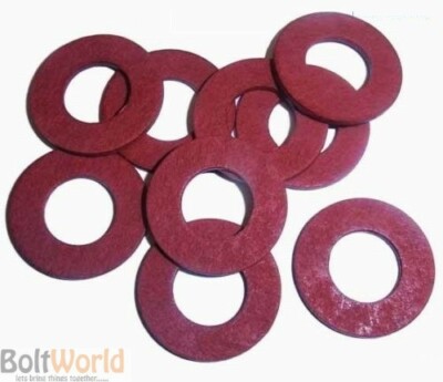

Yeah, I think I'll just pop to B&Q and get hold of some nylon washers.
