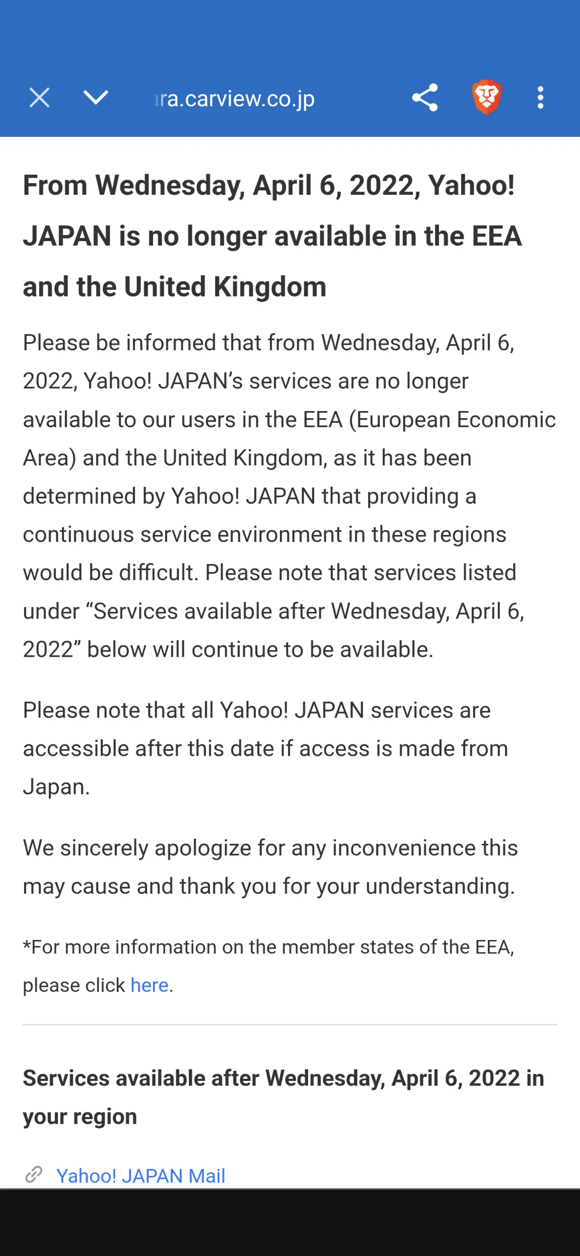

Does anyone have a VPN? Because there might be a potential solution. Someone on Reddit posted about the issue and a Japanese user responded that it's an easy fix by changing a washer for a revised version on the window regulator...
I replied and asked for more detail and he gave me a link...but when I click it it doesn't work because....
If someone has got a VPN and could access that link and perhaps translate or get the images downloaded, and we can find supplier for the part number he mentions, maybe we can try fixing it ourselves.
