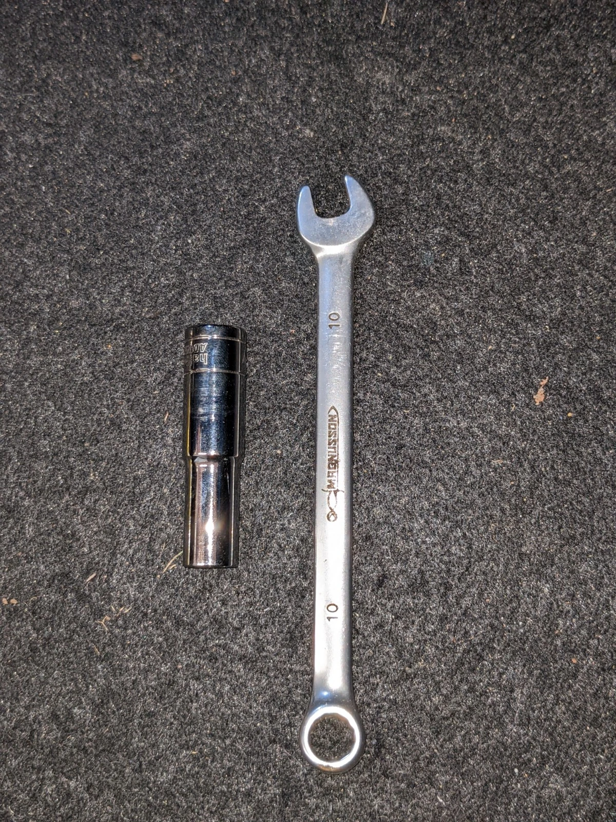

Recommended Tools and parts:
This is a recommendation, this could be done with far less then recommended,
  • 1 x boot strap kit (comprising 1 strap, 1 bolt, 4 washers and 2 nuts)
  • 1 x 10mm spanner
  • 1 x small trim removal tool
  • Choice of:
  • 1 x socket handle with 1 x 10mm long reach socket or
  • Additional 10mm spanner
  • View attachment 15543View attachment 15544
If you don’t understand the tool list then read the rest of this guide as it will become clear why you need them and when you could use a different tool.

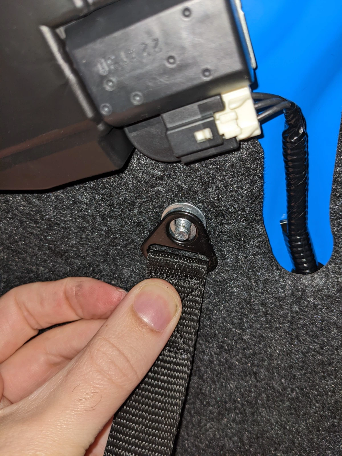

Step 1:
Remove the boot lid liner by the removing the 7 pop clips.
Use the trim tool to gently pry the centre of the clip until is pops up, then gently remove the entire clip.
Do this to remove all of these clips and the boot lid liner should be free.

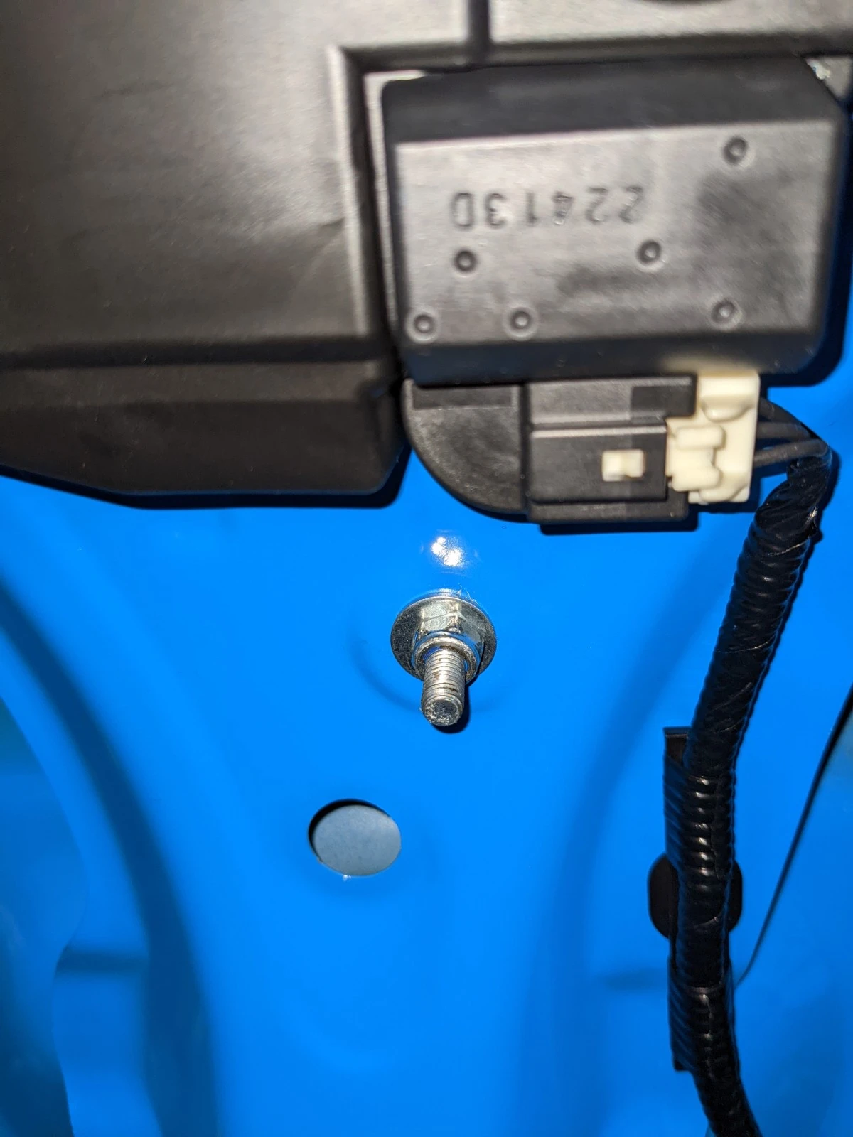

Step 2:

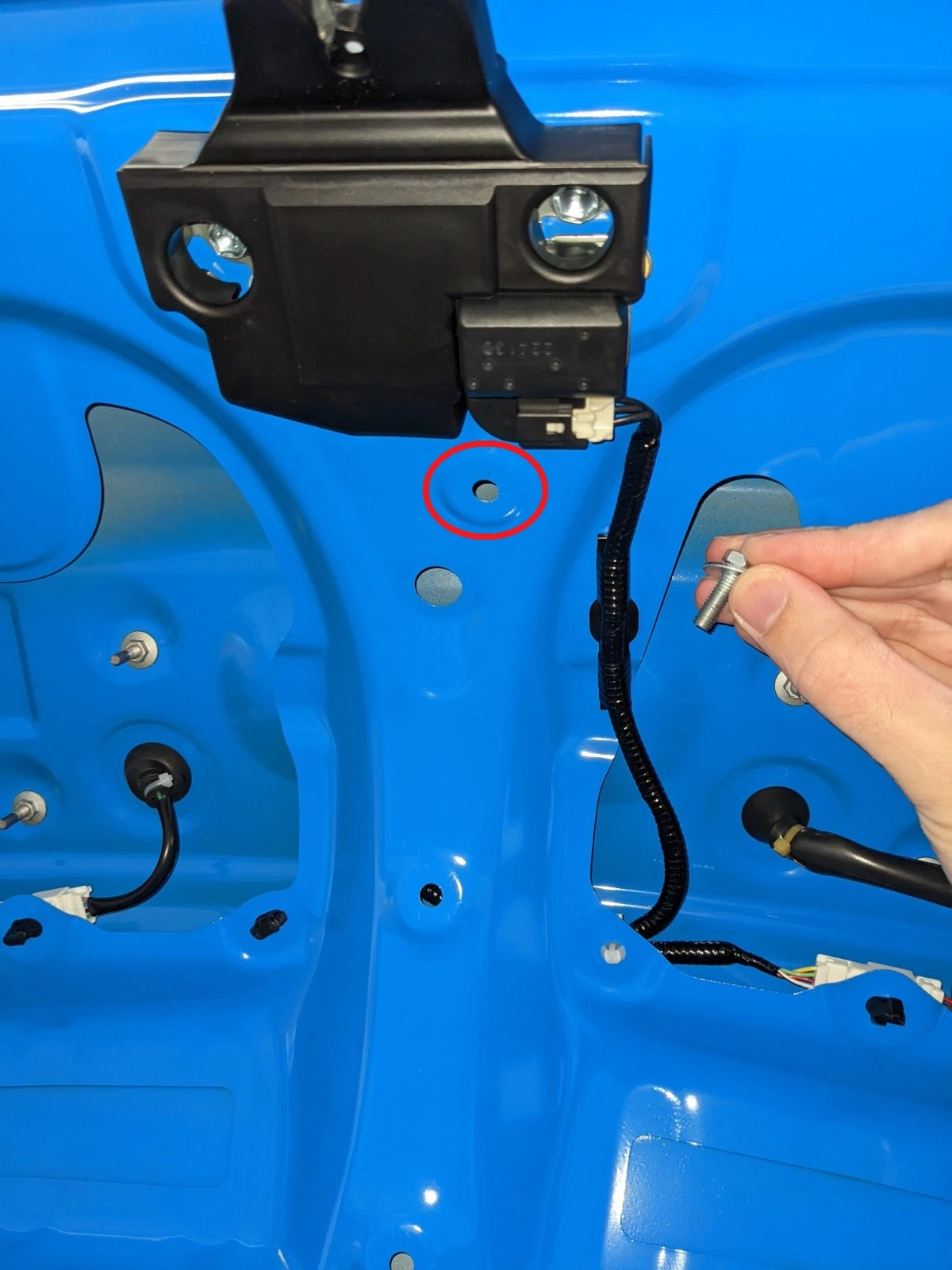

Locate hole and install bolt.
You are looking for the top middle hole as marked here.

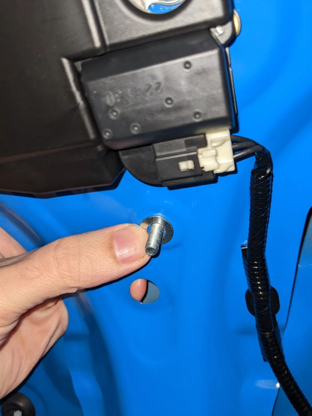

Take the bolt, place one washer on, and thread through the back as pictured. Take your time, you do not want to drop anything, trust me.
With the bolt in position, place the 2nd washer over the bolt
Then the 1st nut over this
Tighten enough to prevent rotation.
Note: As nyloc nuts are used, you will not be able to thread the nut by hand onto the bolt.
Therefore, carefully place one spanner over the bolt head from behind (to stop it moving), while using another spanner (or socket wrench) to tighten the nut.
Step 3:

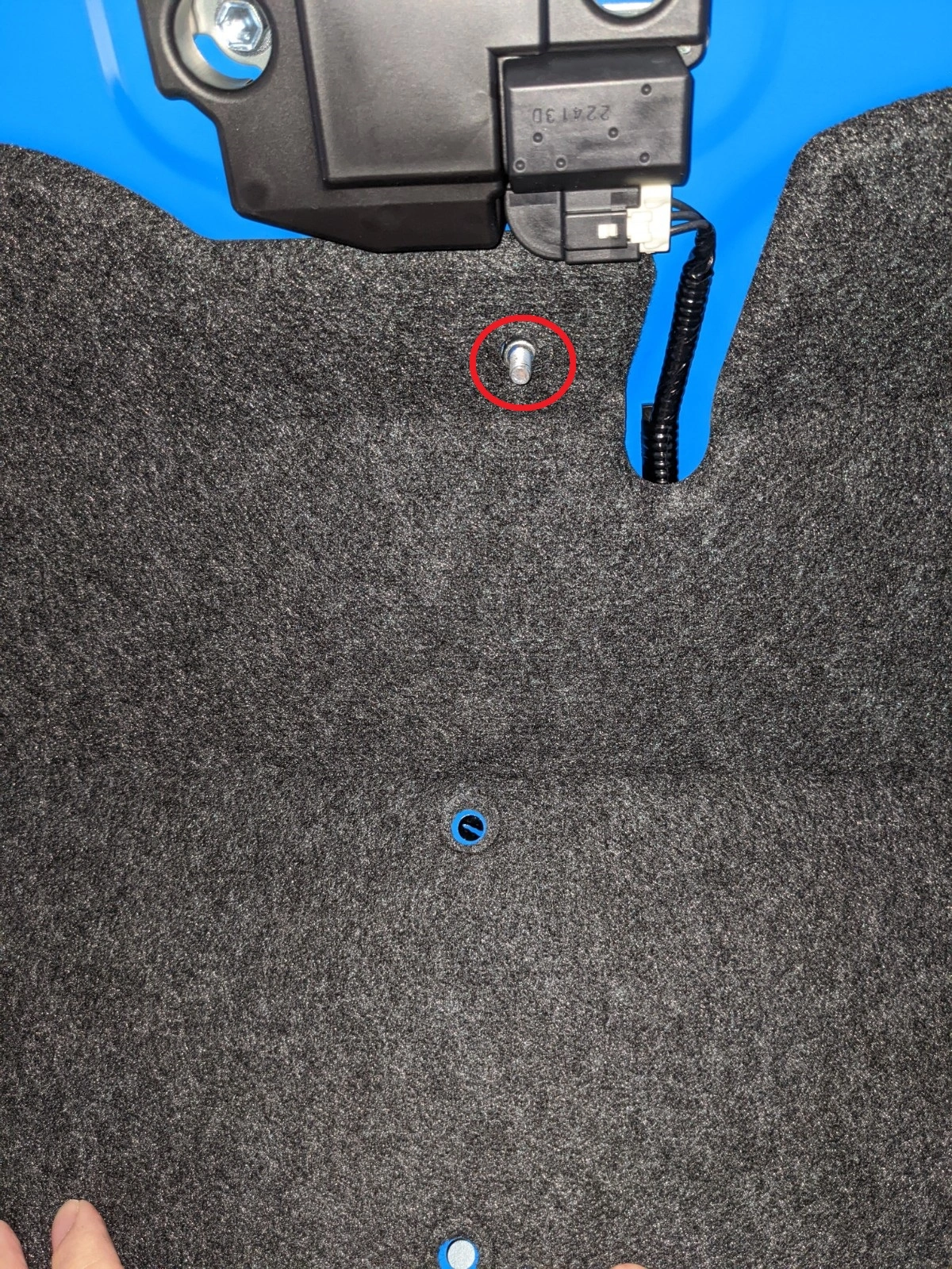

Re-install the boot lid liner as it was, threading the bolt through the top middle existing hole as marked below.
Then put the popclips back, place it in the hole, then press to clip. Do this for all 6 clips
Step 4:

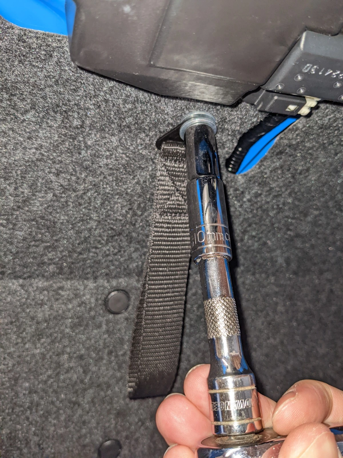

Install the strap. Place washer 3 over the bolt, then place the strap over that.
Then place the 4th washer and 2nd nut over this.
Tighten the nut
Boot strap is complete! Enjoy closing the boot without getting dirty hands or marking the paint work!

Finally got round to installing this today.
Thank you @PVGR 🙏

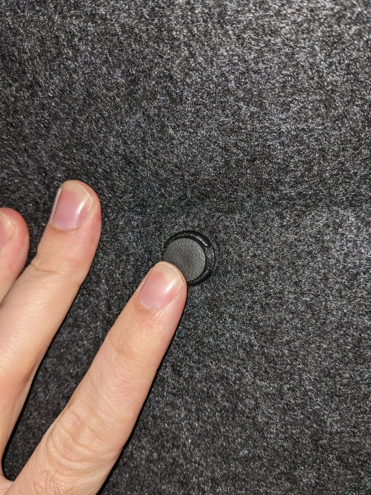

Took the liberty of adding a final little mod to satisfy my OCD. A black plastic nut cap to cover the bolt 🤣🤷🏼
Job done ✅
Haha mine too. I preferred the look of it with the bracket facing outwards. Trouble is you still need to touch the boot to open it so would still leave finger prints.
I just fitted mine. Took care getting the bolt into position and with my small lady hands it was a piece of cake! Great addition (y)
