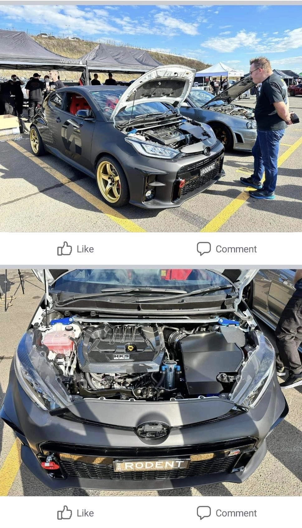

Well this is awkward. They're currently at the drag strip in Sydney and so far have done a 10.2, a 10.8 and a 15 where something happened on the launch. Still a good 8-10mph and half a second off the world record that Lamspeed set with about 530whp.
So far i'm unimpressed. Too much focus on a headline power figure and not enough focus on the launch or midrange maybe? Looks to go ok when up to speed but getting up to speed is an issue. The video I just got was a 1.99 60ft and 10.8 at 140mph, for comparison I was doing a 1.81 60ft with 340hp and a car 60kg overweight. I haven't seen the 10.2 run, just been told it happened before my mate got there.
**Edit- that's them wrapped up for the night. 10.2 apparently their best. Disappointing for a claimed 740whp...
