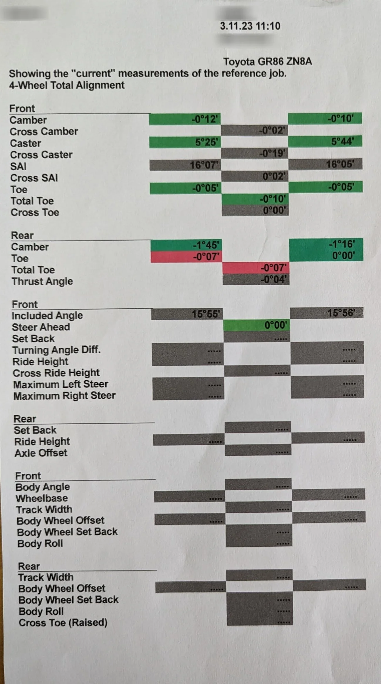

Picked the car up this morning after having an alignment and camber bolts installed at Abbey. Results below. First photo is how it was measured on arrival:

Apparently, it was a little more out of spec than expected, but they said that it seems the factory specs aren't brilliant for the car - something others in this thread have already noticed. The left rear toe was a fair way out and this tracks with how the car felt - generally it felt pretty good in the dry, but it sometimes felt a a little nervous when accelerating in cold and wet. I had lowered my tyre pressures a tad, which seemed to help a little, but not completely. It didn't feel quite as planted as the old GT86 (also aligned by Abbey, but with no camber bolts).
This does make me feel a little better considering the off I had a couple of weeks ago, knowing that the rear wasn't totally stable. Although I won't be complacent; ultimately it's still on me not being careful enough.

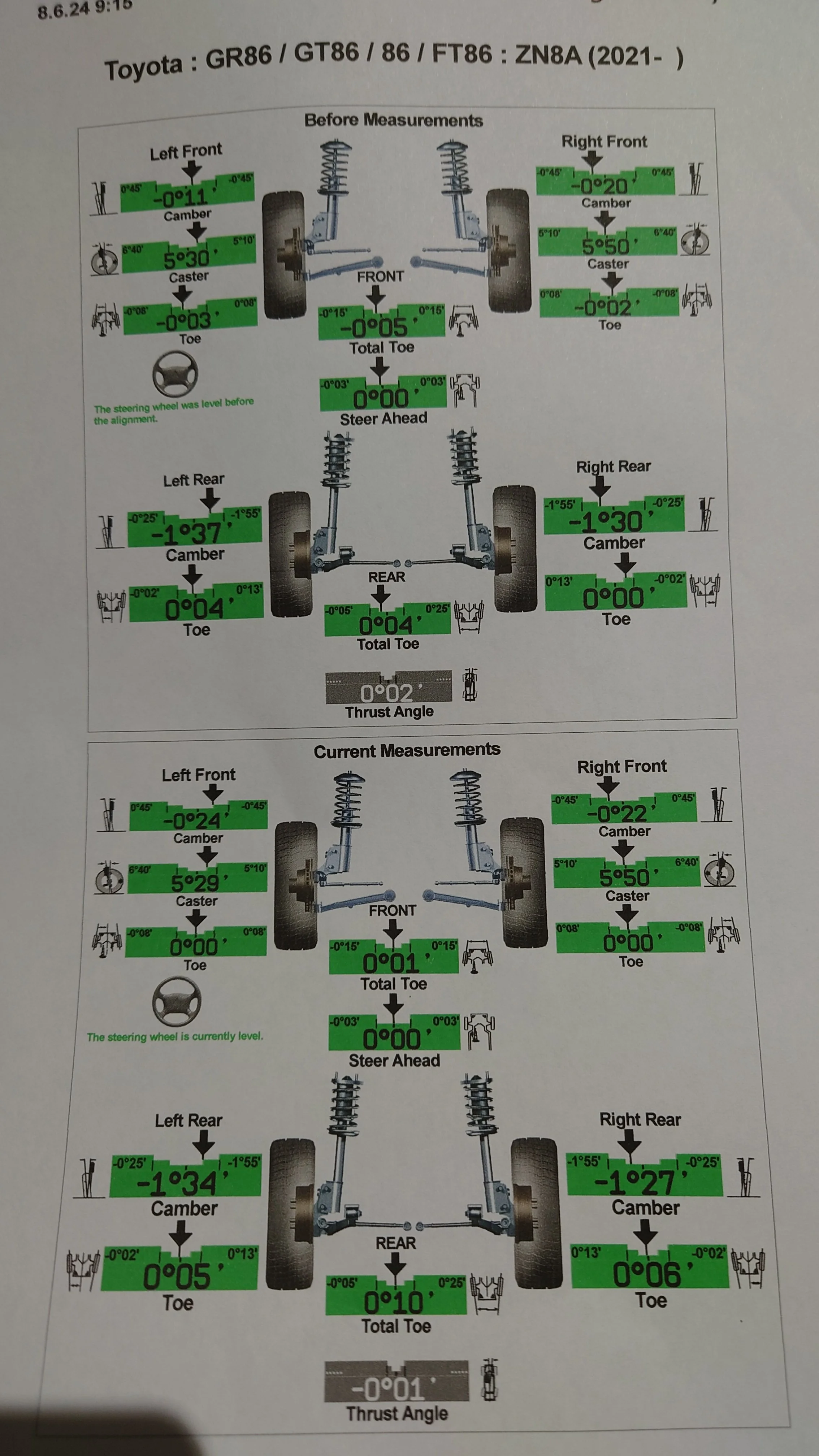

Mine is booked in for its post-coilover fitting alignment on Saturday morning. I’ll be going for around 2 degrees negative camber on the front (not sure exactly what the rears are at now but probably in that ballpark) and ensure it’s still 0.1 degree (or 6 MOA) toe in on the rear.

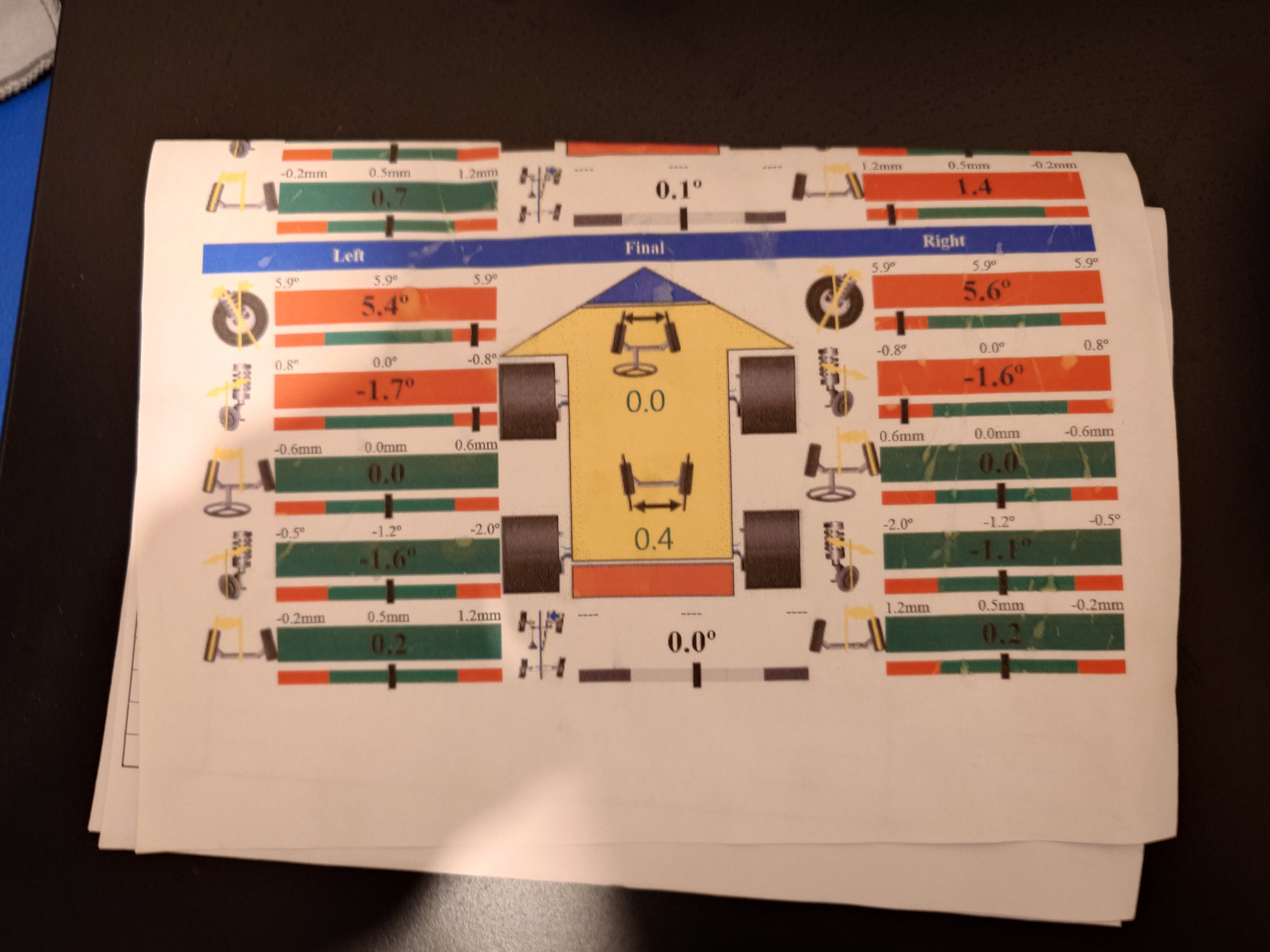

Visited Abbey Motorsport this morning for tracking check. Before and after shown below on stock suspension and wheels.
No great changes to the settings simply making them match side to side. Immediately noticed smoother steering when moving from the straight ahead, and weirdly a firmer, more positive brake pedal. Not sure where that came from, probably my imagination!
First visit to Abbey, chatted with Mark for a good while. Well worthwhile.
Fortunately my camber was bang on and less than 0.1 degree different across the back.
Now running 2 degrees rear and around 2.25 on the front using just top hole camber bolts (didn’t have to touch the top mounts). They only had to adjust the toe.
It’s a tiny bit more vague around the straight ahead but the added bite when cornering is worth it.

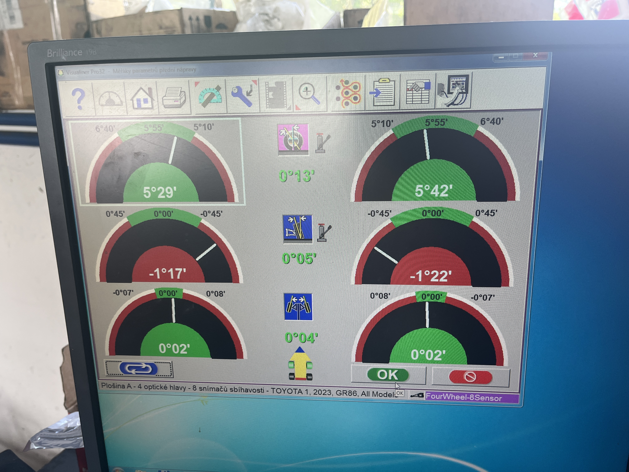

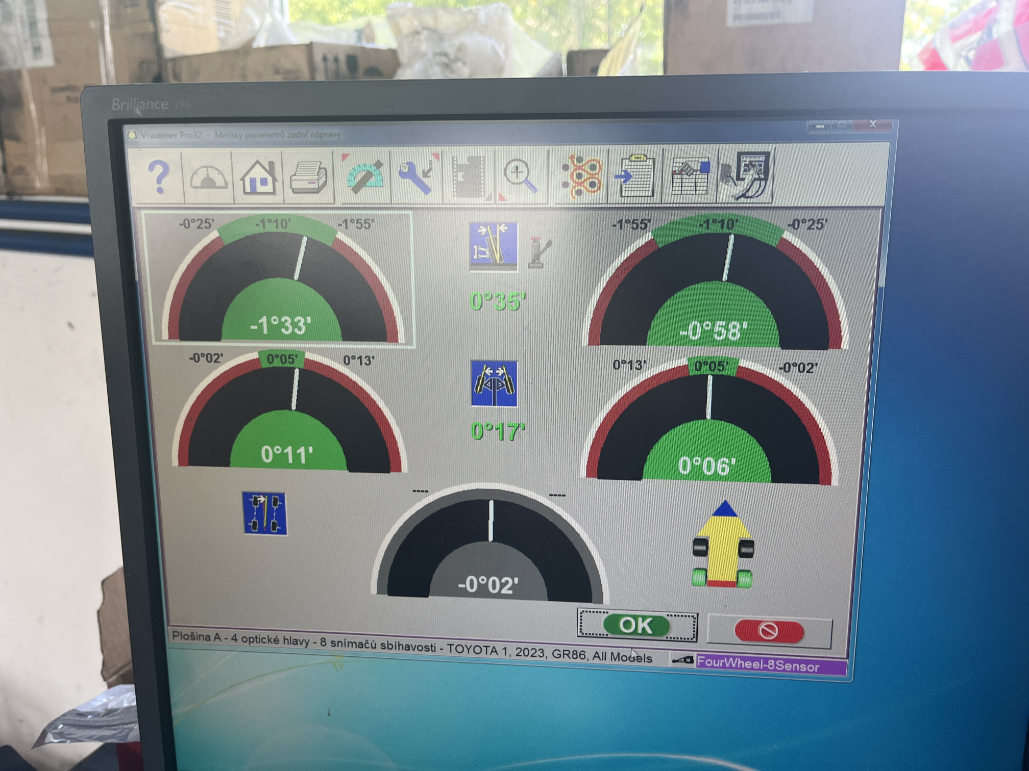

I changed the front camber by 16mm top bolts and maxed them out. The geo machine showed -1deg L and -2deg R. After like an hour they managed to get it -1.2deg on both sides. Hoped for -1.5, but that is life.
The big difference kinda suprised me. It seems like a good idea to do a proper alignment after the change and not just max it out at home and call it a day.
I also have the back side unbalanced. Company doing the alignment did not want to mess with it, since there is almost no way to change it without camber bolts for the back. But honestly I think they just did not want to spend time with it. Next time I will visit some other shop...
