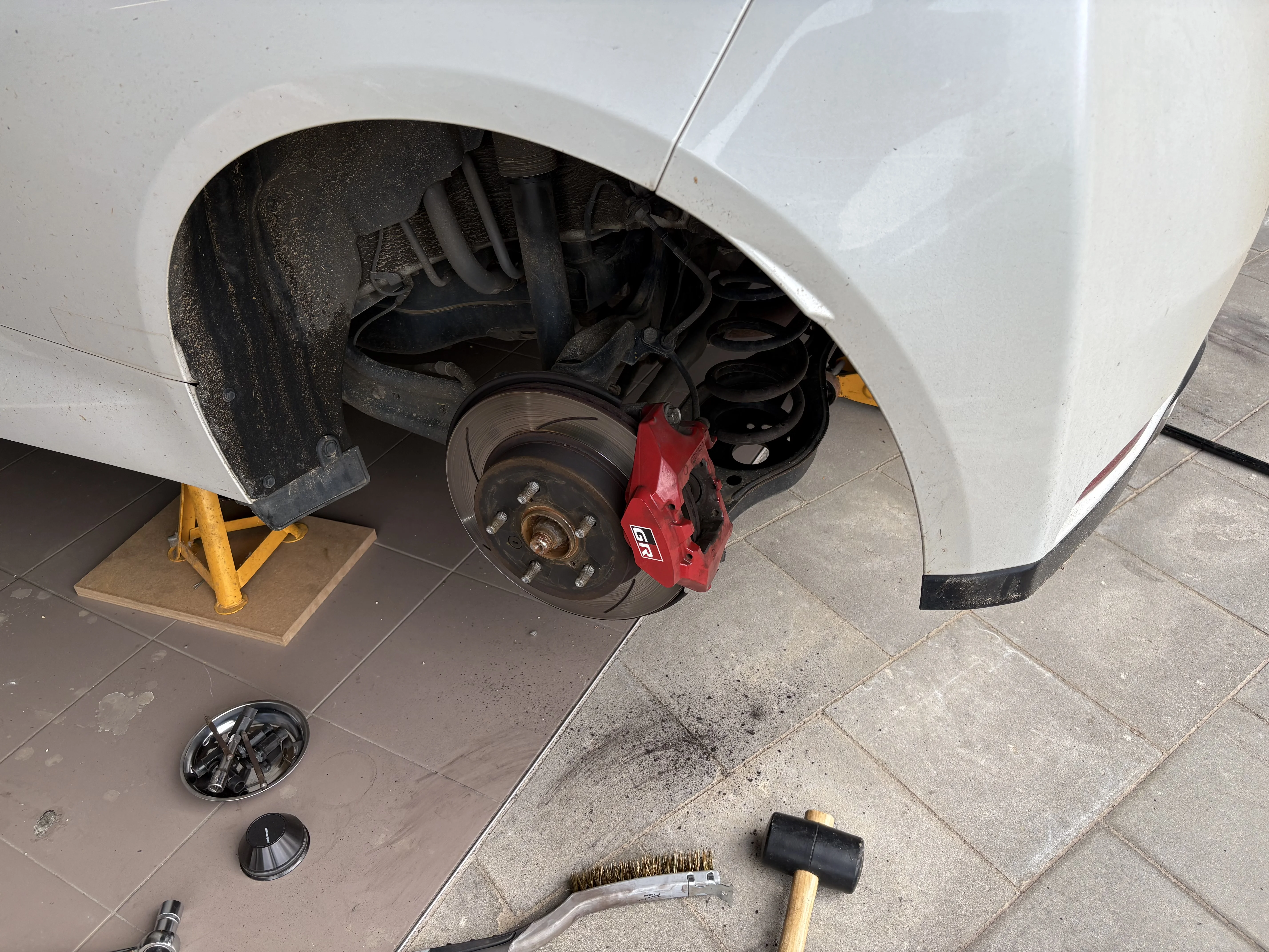

And rears done, fitted OE-spec Brembos, let’s see how they hold up.Changed to fourth set of pads at 77,000 km, DS2500 again as they have been brilliant.
Front discs have some life left in them yet. My digital calipers “broke” (thanks, son!) so I can’t be super accurate, but with a steel rule and a steady eye they look to have at least a millimetre left.
The discs have been on since January 2024. The first set lasted nearly two years so this pair look to be lasting about the same*.
Will check the rears tomorrow. Have pads, but they weren’t needing done last time I looked.
*Edit: New thickness is only 28 mm (I thought it was 30 mm) so they have a bit more life left in them yet (my bank balance approves!). Will need to measure the thickness properly.
I could’ve left them on for a bit yet I reckon, they don’t get anything like the abuse of the fronts and these have been on for over four years.
Wear was pretty even although one pad, the right one above, was almost completely jammed by old brake dust so that it clearly wasn’t moving fully.
It was wiggling a bit but I couldn’t get the purchase on it to pull it fee. Had to remove the caliper to knock it out, scraped all the crud from the inside of the caliper while it was off.
I won’t leave them so long next time before removing, cleaning and refitting.
