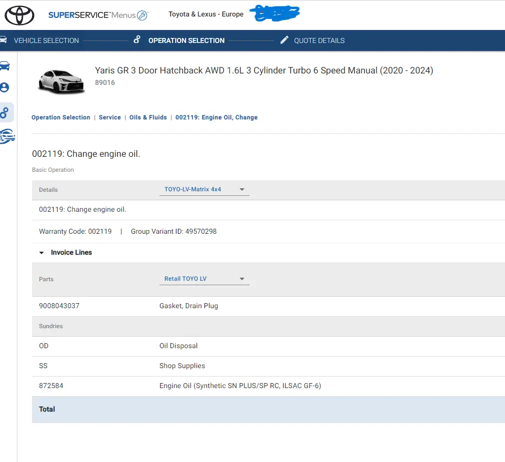

This is the oil our engines require. Unless it’s an equivalent spec or better, it’s not good enough.
08880-84106 or nothing 😊
It's a shame certain dealerships don't know this
They really should only be using what the newish Superservice menus tell them to use, or a self provided alternative up to spec, if they are supplying a different Toyota oil, either something really messed up is going on at the particular dealership, or the oil is in short supply.
See for reference:

I’m sure most do. Problem is, they’ll have barrels of 0W-20 GF5 oil in the workshop. Why go to the expense of ordering some fancy-pants GF-6A in when the stuff in the barrels out back ‘will do’? Boils down to profit /lack of care or knowledge.
Apologies for sounding so cynical but it’s the most likely answer.
We’ve got to remember that this particular engine is unique to the GRY & GRC.
See for reference:
I'll be honest with you. Mine has only gotten services with the good stuff because I brought it to them.
Otherwise they would have used whatever 0w20 they already have in their workshop.
