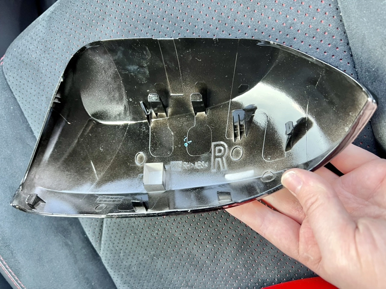

did you take the mirror caps/covers off? I tried taking mine off and worried I'm gunna break them so gave up :LOL:, any pointers if you took them off? thanks
Step one is to remove the mirror glass, which I discovered watching this video:
It pops off fairly easily, you just need to try and maintain an even pressure on it to try and avoid cracking it. After that, it’s a case of finding the little tabs that hold the cover on and releasing them. And then at one point I admit just pulling quite a bit…
In hindsight I probably should have just left them as they were as I dropped and chipped one of the covers when taking it off, so I had to commit to the wrap after that.

Perfect 👍, I'll have another go later. Thank you.
If it helps, this is the reverse, so give you an idea of where the tabs are, that’ll need pressing in to release it. Bit annoying that they are completely different to the standard Yaris!
