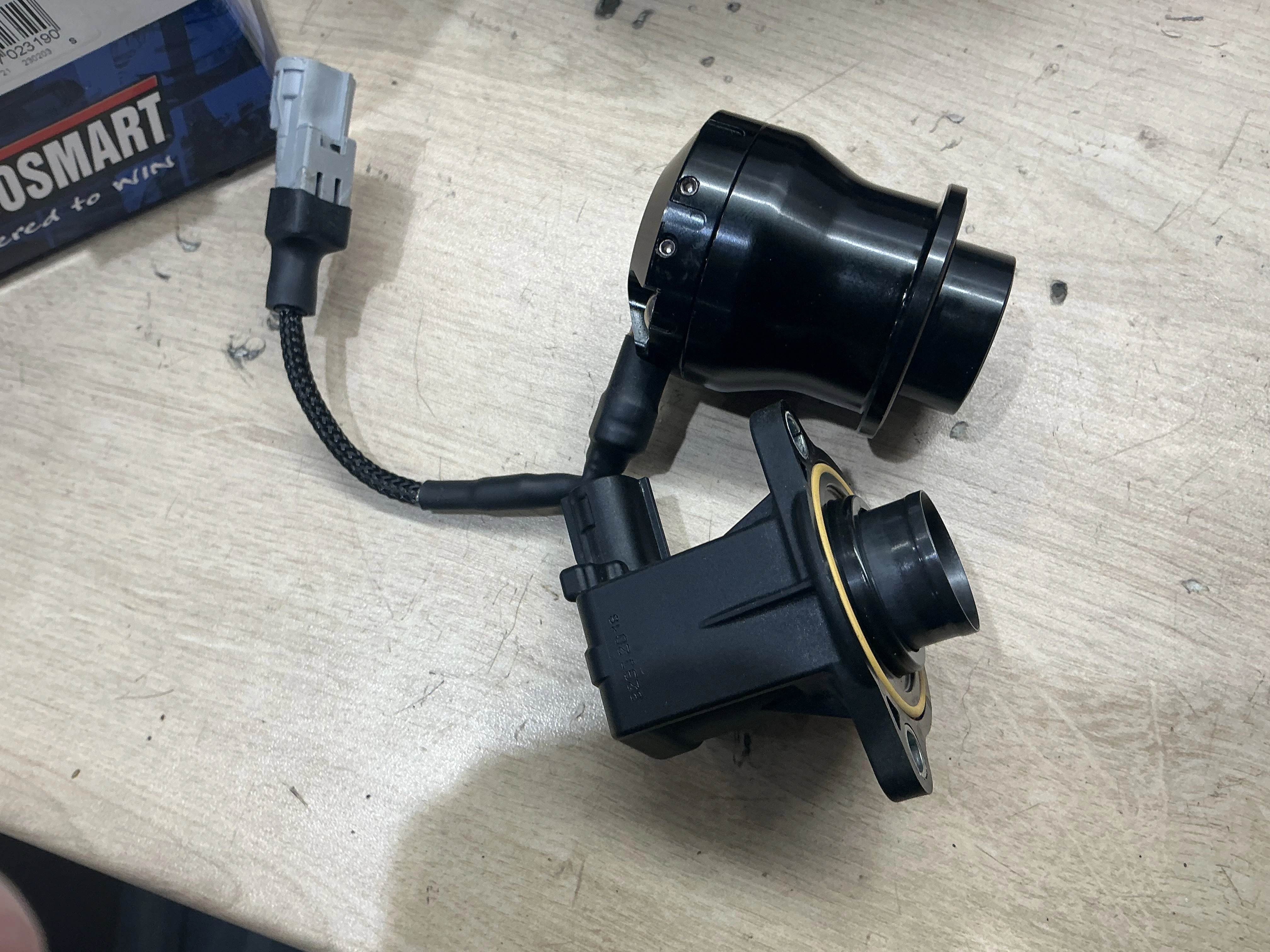

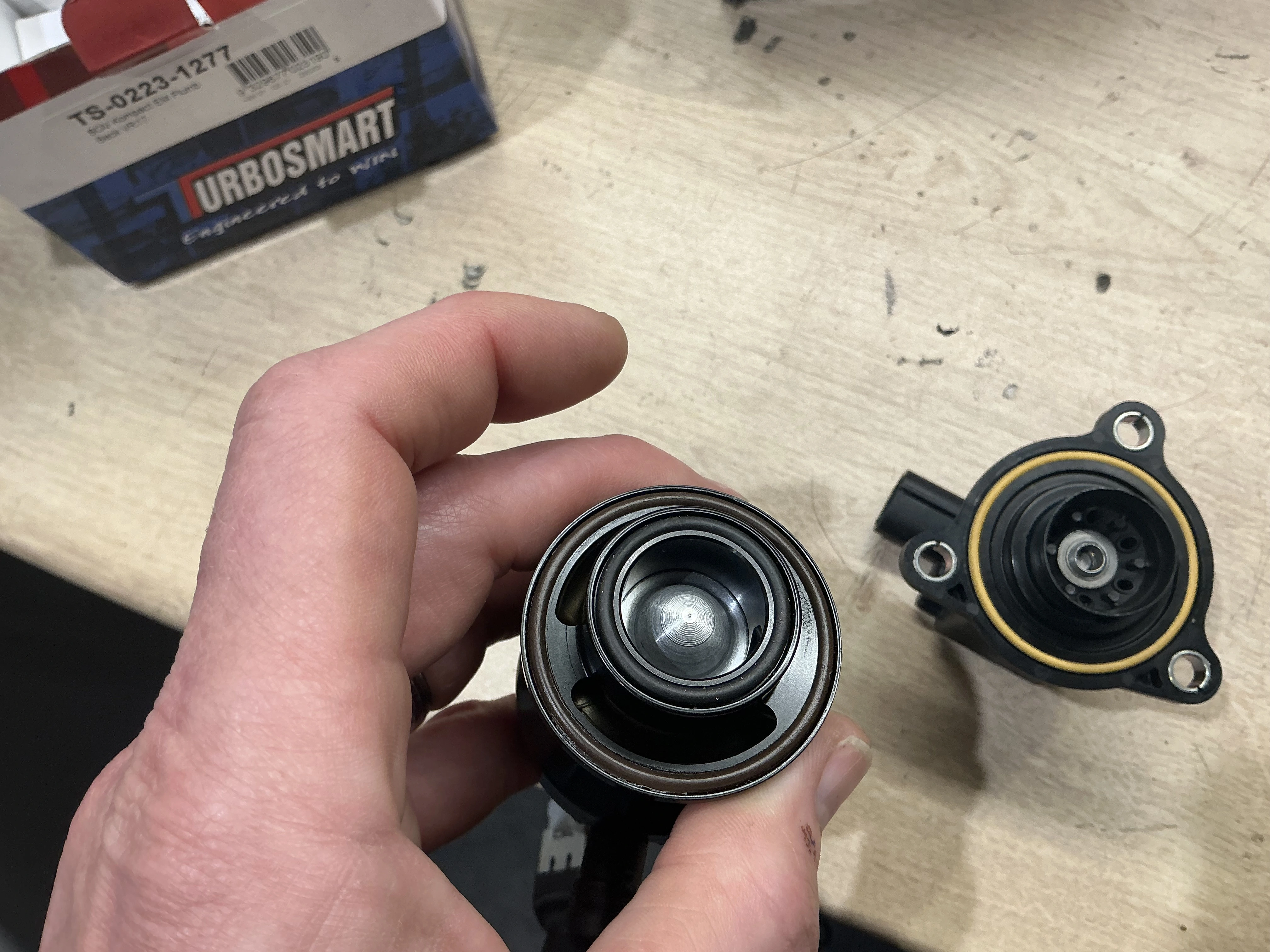

Is there any performance or reliability gained using TurboSmart Plumb back valve? Have noted some of stock valves being damaged, turbo smart would be more robust.
I have tried both the plumb back and the dual port. The OEM valve certainly does leak and opens earlier than the turbo smart valve with a remapped car. The plumb back version is actually a little quieter than the OEM and it does not open as easily. I get more turbo flutter with this valve. When you shut off it opens and dumps the boost instantaneously. The boost gauge in the car (scientific I appreciate) is like a switch. The dual port is a lot of fun but it does open quite easily. Every gear change above about 3000 rpm pshhhhh pshhhh. It’s not quiet……..pshhhhh 😁…….and from the passenger seat “you’re a knob” I ended up putting the plumb back on as one it felt like a race car, 2 I was tired of being called a knob and 3 it would sometimes run rich off throttle with the resulting pop and occasionally a little hiccup when getting back on the throttle. The plumb back does not do that.
