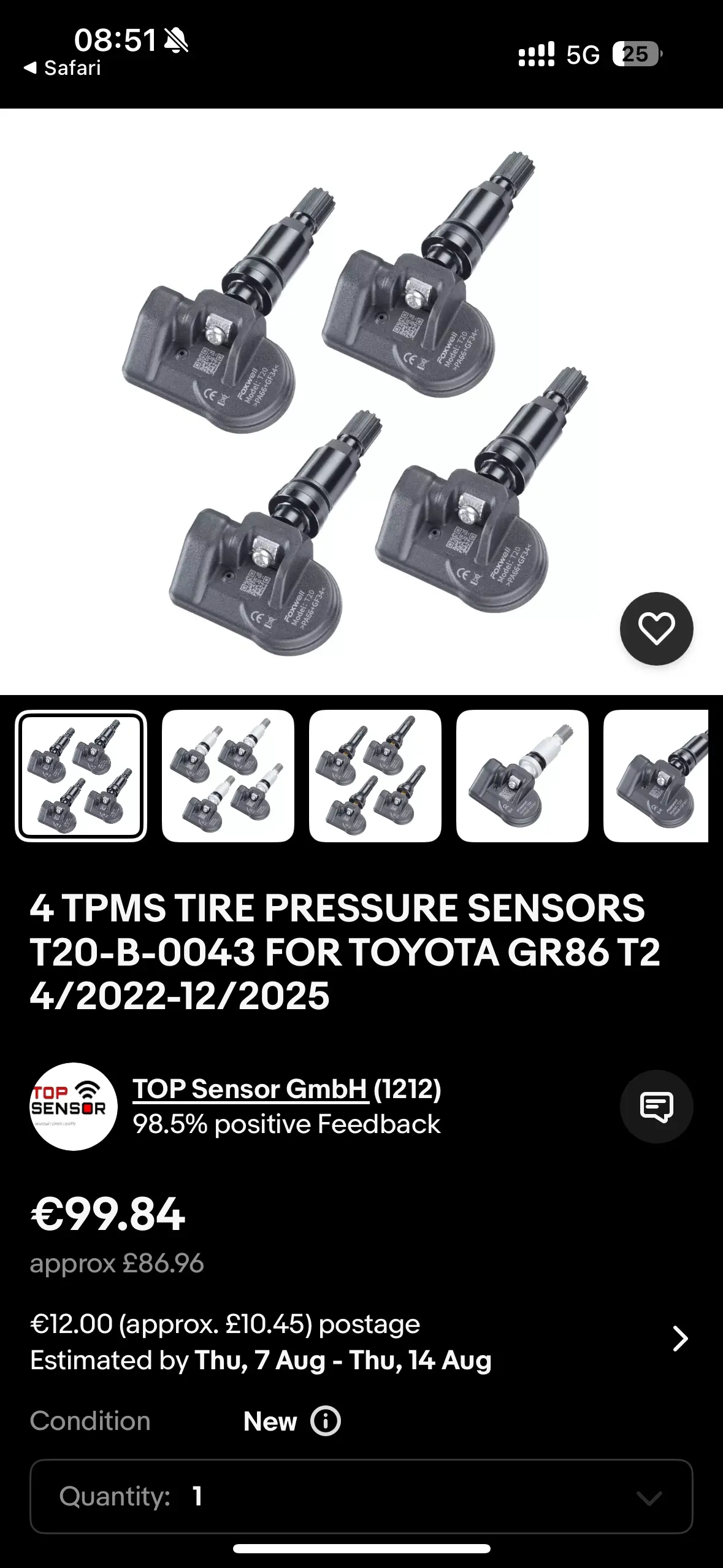

Anyone tried these?
Tempted to do a buy for the winter set
How do find out the current sensor ID's - can it be done without having to remove tyres to get an eyeball on the existing sensors ?
The ID's can be read using a programming gadget. No need to remove the tyres. A good tyre fitter should have a programmer.
But beware, as I understand it, some sensors cannot be read by another brands programmer!!
If going to a tyre fitter, best to ask them in advance to discover what they can do.
The fitter I use has programmed two additional sets of wheels for me using the same codes as the OEM wheels. I just swap the wheels over, press the button and go for a drive. He supplied the sensors too.. at some expense, but less than Toyota.
All sensors can be read, it's universal format. But you need the same brand of programmer and sensor to be able to code them.
