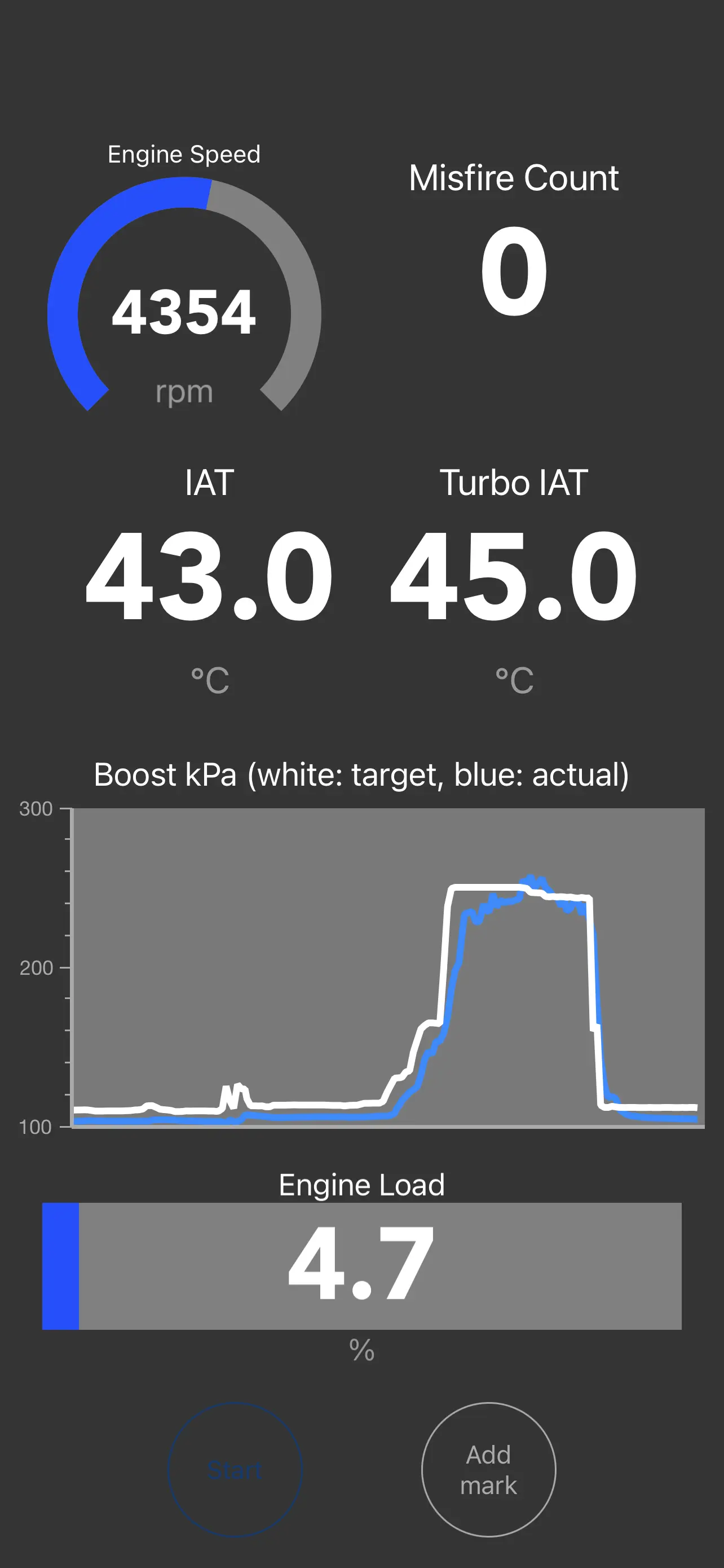

Been playing with the dashboard function, very flexible. There are over 100 parameters that can be displayed, and the screen configuration can be as complex or pretty as you like.
Impressive.
Yes. It works even without an Ecutek remap, but you need their OBD dongle.
It's a lot more expensive than the normal ones you get one Amazon etc., but having used it I can see why. So much faster and has access to vastly more parameters, and you can log them all over time and export to CSV for later analysis.
If I'd seen it in action before now then I may have bought one anyway, even if I wasn't going for a Ecutek remap.
