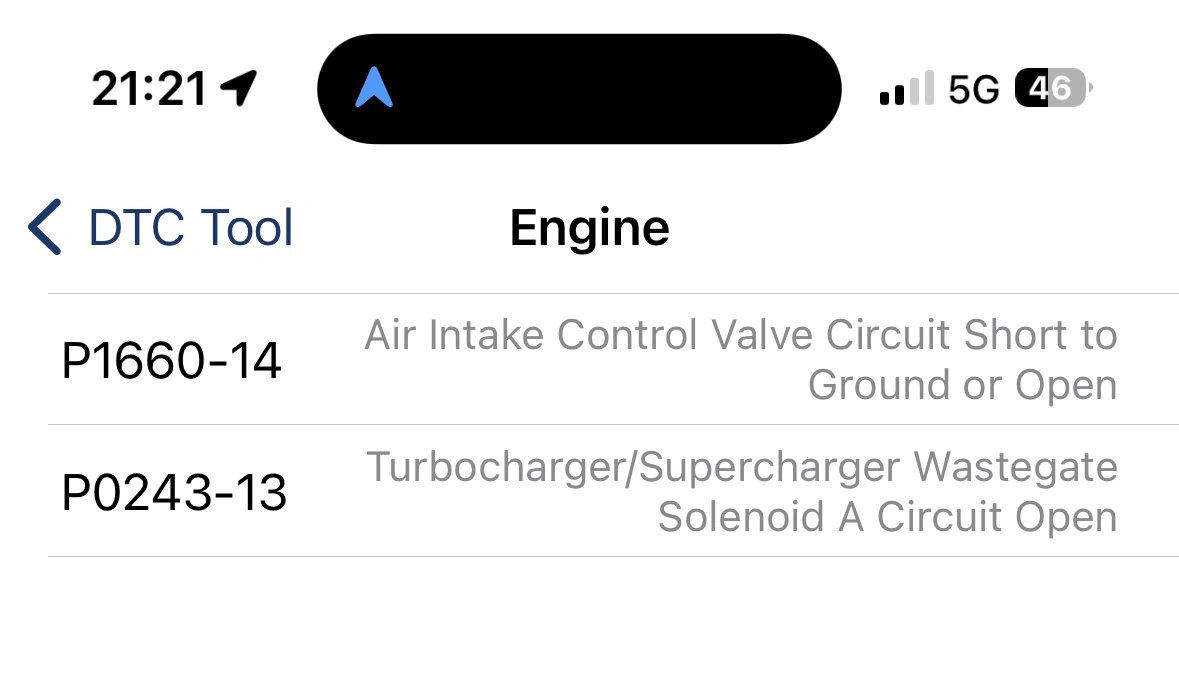

Started my car up tonight and after touching the throttle to gently pull away after cold start cycle the car immediately showed the “reduced engine power. Visit dealer” alert which scared the poop out of me tbh! It didn’t display again though following an ignition cycle but looking at the DTC part of the EcuTek app I’ve noticed the following. Is anyone able to tell me what these codes mean please?
Both are controlled by the vacuumpump/lines. If it worked fine after, report it, could be just a glitch hopefully.
