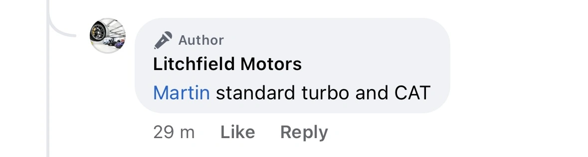

Well I am surprised. 380 FWHP out of the OEM turbo?
The thing is IHI don't publish Compressor maps which is a problem when your chasing all the HP you can get.
When I first look at the OEM turbo ages ago and I was looking at Turbine and Compressor wheel sizes and it was somewhere between a Garrett GTX 300 and a GTX 350.
Theres no doubt the IHI has a higher efficiency than the GTX but those power figures really surprise me.
Next question, whats the boost pressure.
Their figures seem optimistic, 250whp as mentioned on the previous page for their stage 1 means this would be about 290-300whp with similar drivetrain losses. Annoys me a bit when companies crop the whp figures out.
The tunes themselves are probably great to drive with but i'm not sure about the claimed crank figures.

The OEM MAP sensor is only 2bar so in theory no more than 2bar. With the cams it’ll flow way better at the top end and being on a dyno means they can time the shit out of it too. I wouldn’t expect remote tuning to go as far as that though as they can’t afford to time to the absolute limits with listening for knock live. TeamViewer is ok for mapping but you’re relying on sensor data rather than actually listening live.
As for the turbo, yeah, it must be screaming at that power level. 380hp in a car that does the occasional dyno pull or posts a spec list in the window at cars and coffee is a different world to 380hp in a car that does 20 minute track sessions flat out all day long. Watching with interest at longevity stuff as it’s a big unknown at the minute. Mine is “only” 400bhp on the hybrid turbo but I reckon there’s another 30-40hp to be found with an extra few psi and more timing. I just can’t do that until I drive to Italy 😂

It’s running the Akro exhaust so might retain the CAT but that exhaust replaces the very restrictive GPF doesn’t it and is practically a straight pipe? The Akro strictly isn’t street legal for that reason either is it? Funnily enough when I was talking to Iain the other day making enquiries he mentioned they had achieved that figure with a standard cat and to watch their socials. It was part of the reason that convinced me to part with my money, but yeah I imagine with the cam work it’ll rev and rev and make lots of top end power without engine damaging big torque levels?
It still revs to the same rev limit from what I can see but yeah the cams will improve the efficiency of the top end, the 267-A cams are worth a good 20-30hp.
The cat is still a massive restriction though. Personally I’d be watching EGT’s like a hawk because the standard car doesn’t have a sensor for them, I think they’re just calculated. I run a dedicated sensor on the Syvecs and I know how hot mine gets even with a notcat
