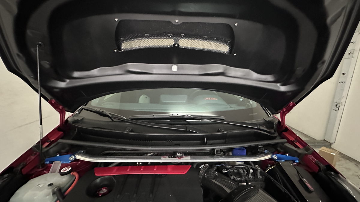

Ladies and gentlemen, this is a picture taken from the vent, so it should be clear where the rain will flow to, personally, there are no important electronic parts in these locations, so there is no need to worry about failure.
In addition, the interior of the engine cover can be clearly seen to have a fixed lock point to lock the cover plate, which is very good in a rainstorm, can effectively prevent rain intrusion, and the relative vent has no effect.
For those of you who are worried about dirt, you can clearly see that the engine room is still clean after 5 hours of rainy driving with the vent open, and there is no dirt problem, so there is no need to worry too much.
I was looking at buying one, but realised there's nowhere under the bonnet to attached the bonnet stay or bonnet stay clip. How have you got round that? Have you got any close ups of how bad or good the weave quality and finish is (you say it's not good).
Also interested to see what the chicken-wire grill looks like too - does that also look cheap? ,
Last question i promise - when it rains, where does the water run to?
Hey, look at the photo I shared, the type-M has a relative position marker, you just need to punch the hole and move the original oem related items to the past

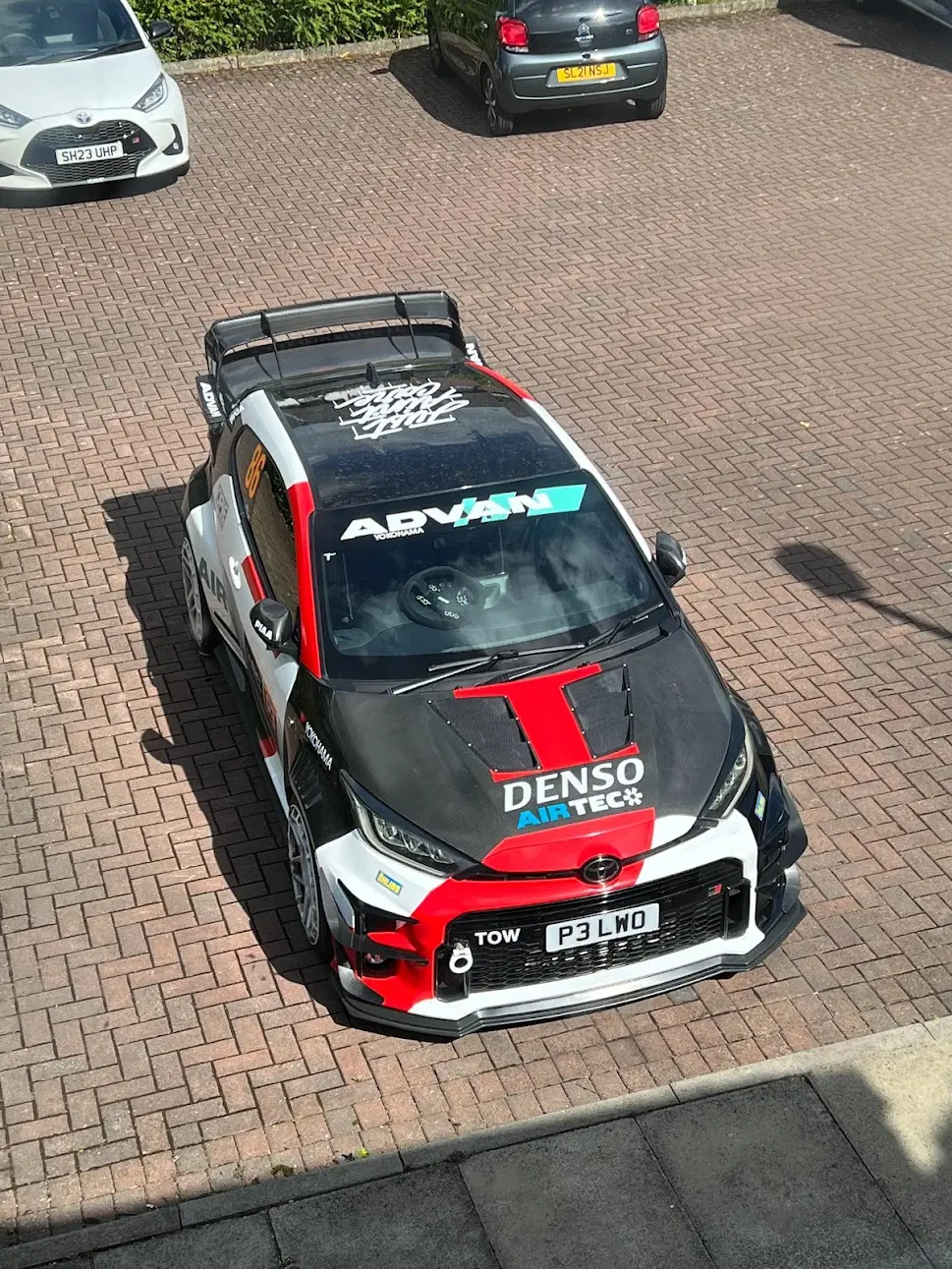

mean and functional look, very nice..!

Your Hood looks amazing, bro!
