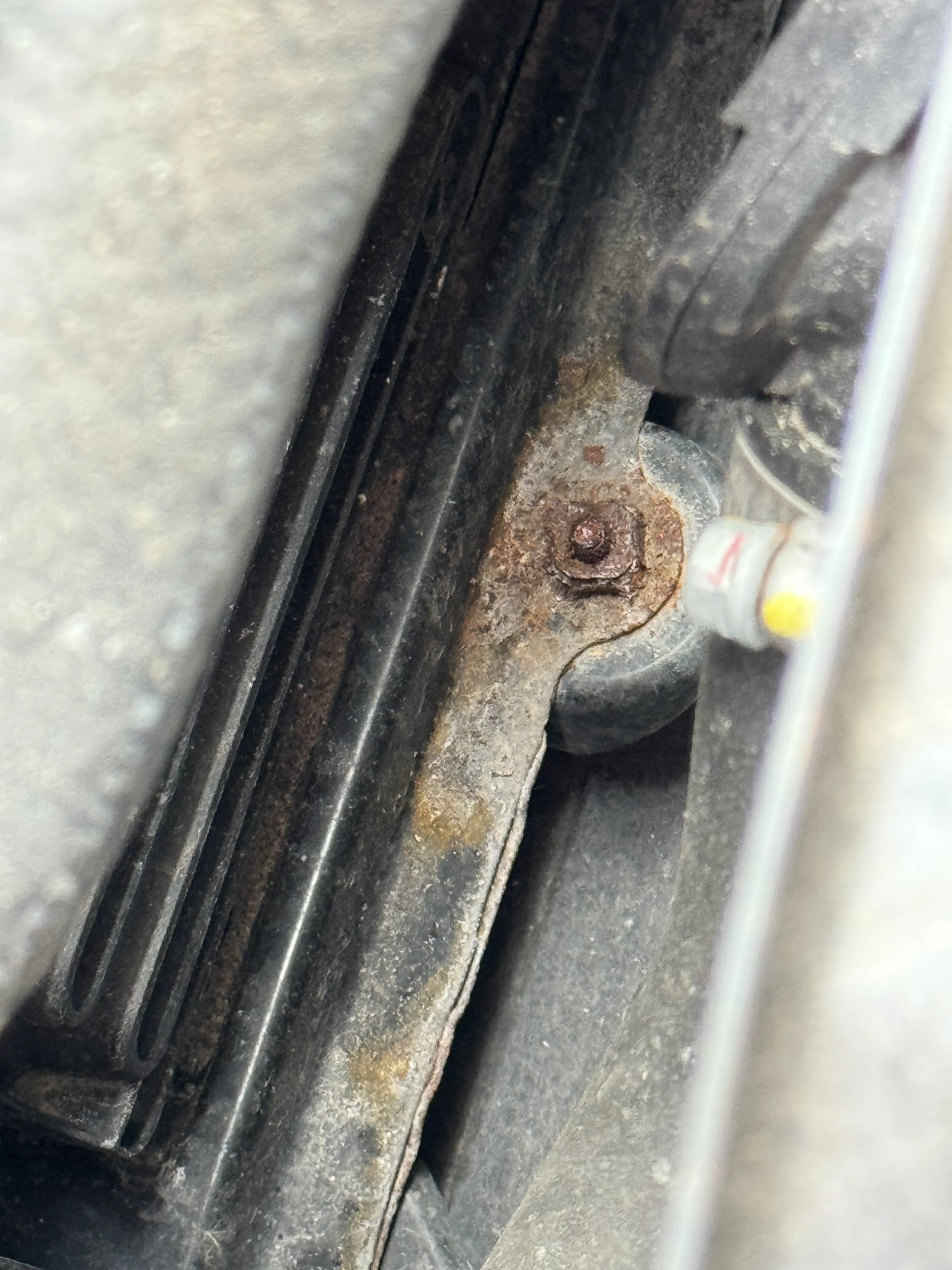

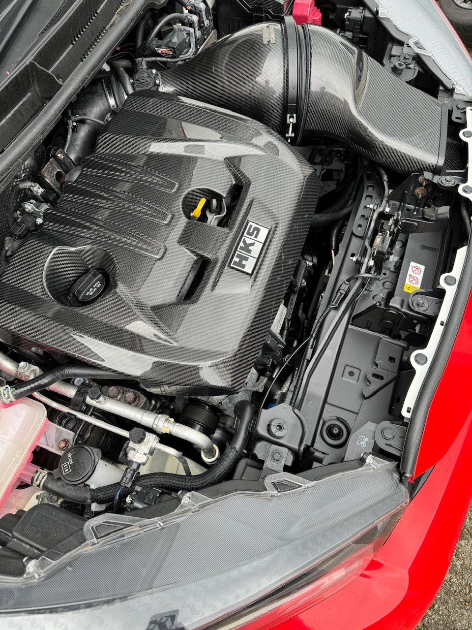

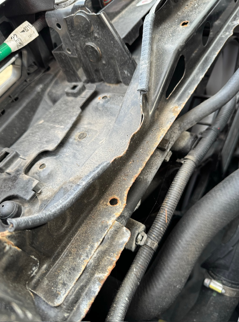

I'm glad I've never had salt on the car. I still remember the times when we imported Nissan Skylines (about 15-20 years ago). They always said "not from England!" they're all rusty. Which was true at least with the cars I've seen...Intake out for Eventuri pipe replacement, so a chance to look at the engine bay and give it a clean. Just a heads up, daily driver, 24k miles, salty British roads:
Seems to be quite a bit along seam edges.
Sorry, to see this, mate.
This is really not good considering the age of the car! How will the fleet of GR Yaris look in 5 years of daily use..? Getting concerned as Ive seen things on my car as wellIntake out for Eventuri pipe replacement, so a chance to look at the engine bay and give it a clean. Just a heads up, daily driver, 24k miles, salty British roads:

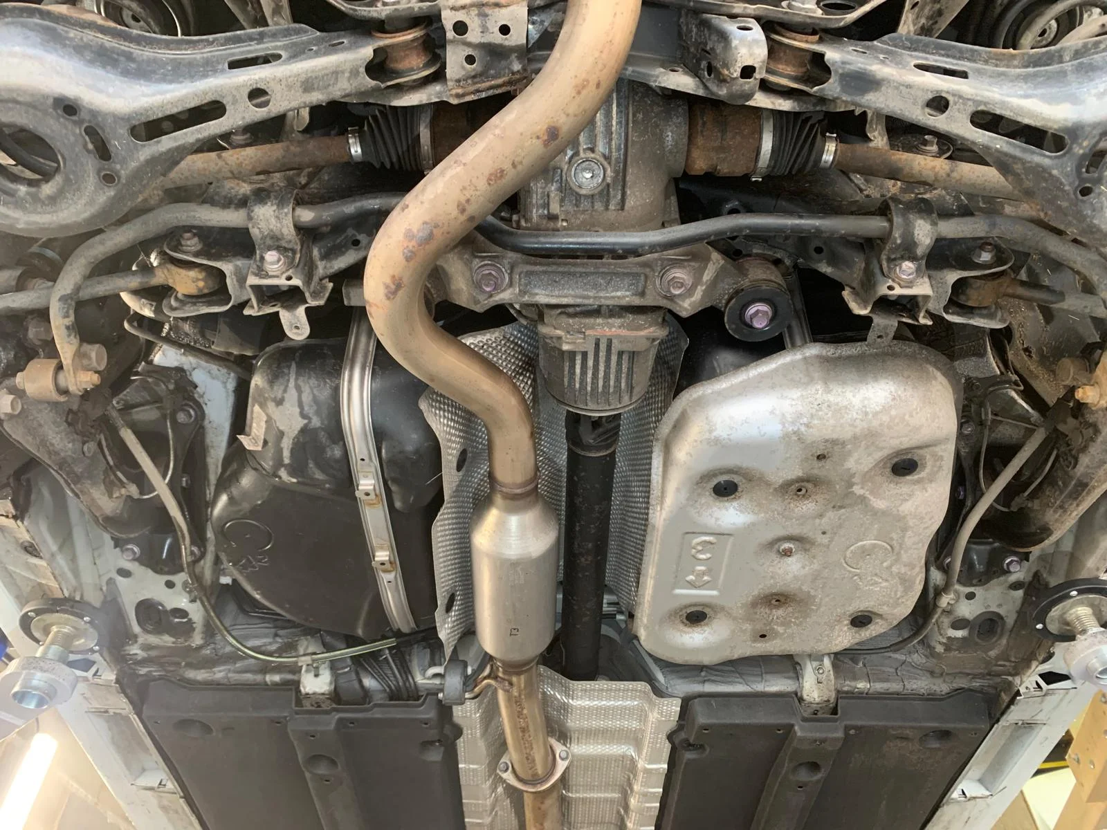

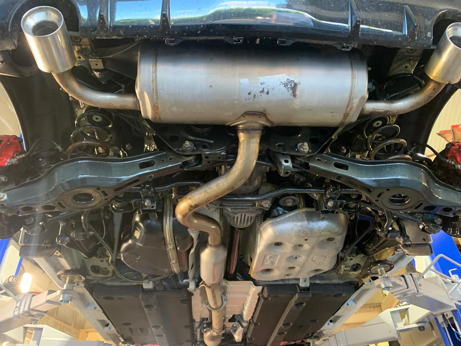

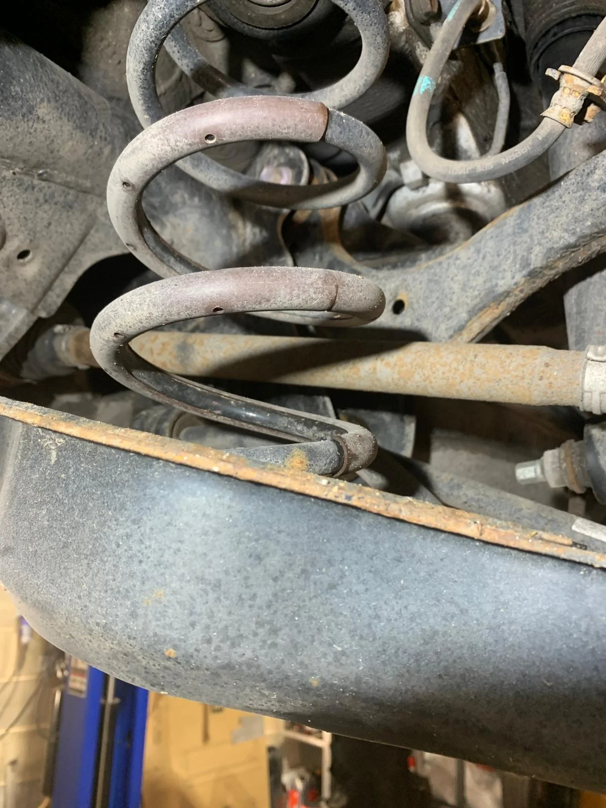

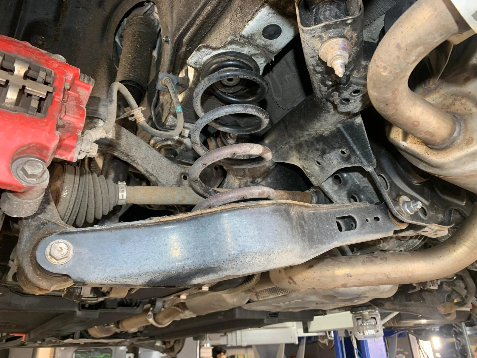

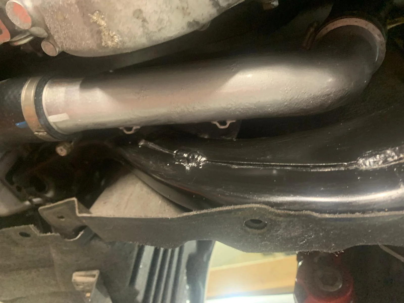

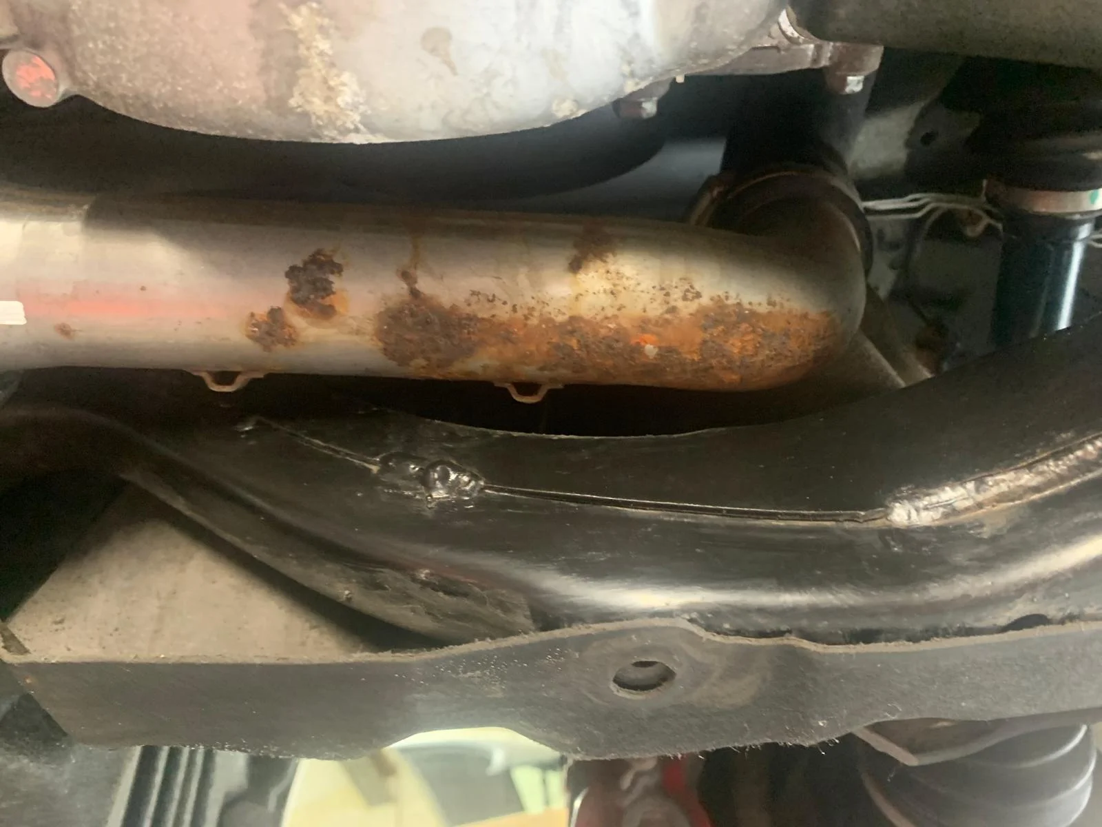

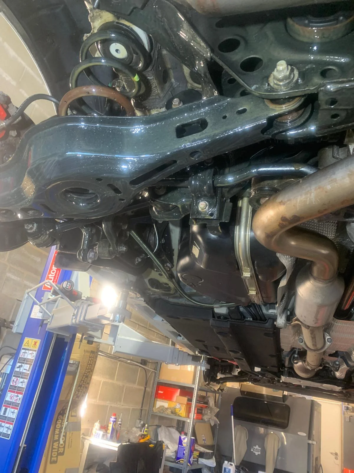

Good to know, looks like a great job, I said I'd do this from new myself, but never got round to itUK car, 3.5y old, driven in winter and no previous treatment. I'd seen some rust when it was on ramps recently but still surprised quite how much there was. Also see last 2 photos of a coolant pipe at the bottom of the engine (behind the cover), rust with early pitting. The rust was removed and treated before painting with Hammerite,
Work was done by John at Precision Blasting near Matlock, Derbyshire. I can certainly recommend his service if you're needing the same.
Precision Blasting
