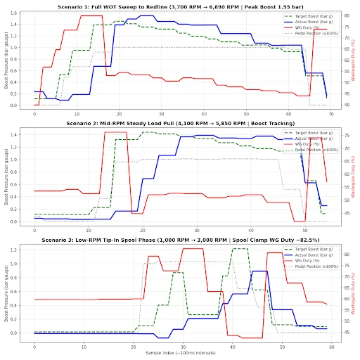

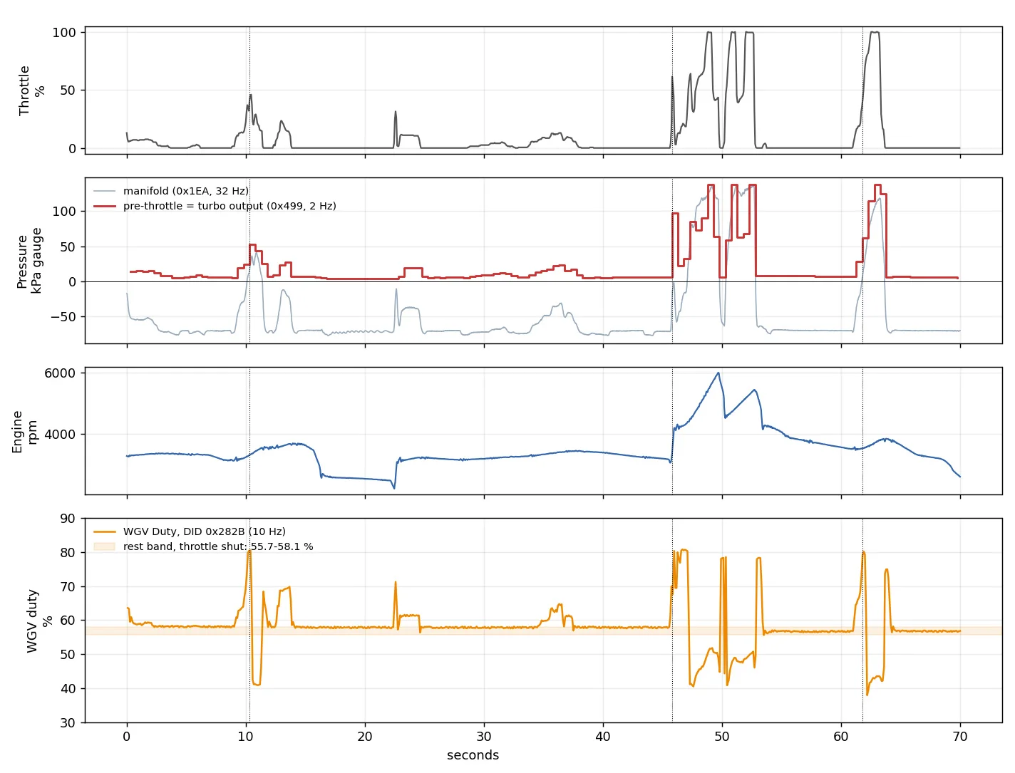

I believe I've found the actual wastegate duty signal.
Funny thing is - it's not visible in the Techstream (GTS) ;)
Wastegate Valve Control Duty Ratio
OBD2 Mode and PID: 22282B
Long name: Wastegate Valve Control Duty Ratio
Short name: WGV Duty
Minimum value: 0
Maximum value: 100
Scale factor: x1
Unit type: %
Equation: ((A*256)+B)*0.006103515625
OBD header: 700
Minimum value: 0
Maximum value: 100
Scale factor: x1
Unit type: %
OBD header: 700
Thanks.
I have put it in Torque Pro.
What do the shown Values mean?
The percentage opening of the valve? 100% full open or full close?
Max Value at full throttle was 88%
Minimum value: 0
Maximum value: 100
Scale factor: x1
Unit type: %
OBD header: 700
Bravo!
So we finally have the WGDC!
Thanks.
0% fully open, 100% fully closed
Apparently it caps at ~20% - 88% for practical reasons (e.g. protection from slamming the valve against its seat...)
I would be interested to know the Hertz cycle.
