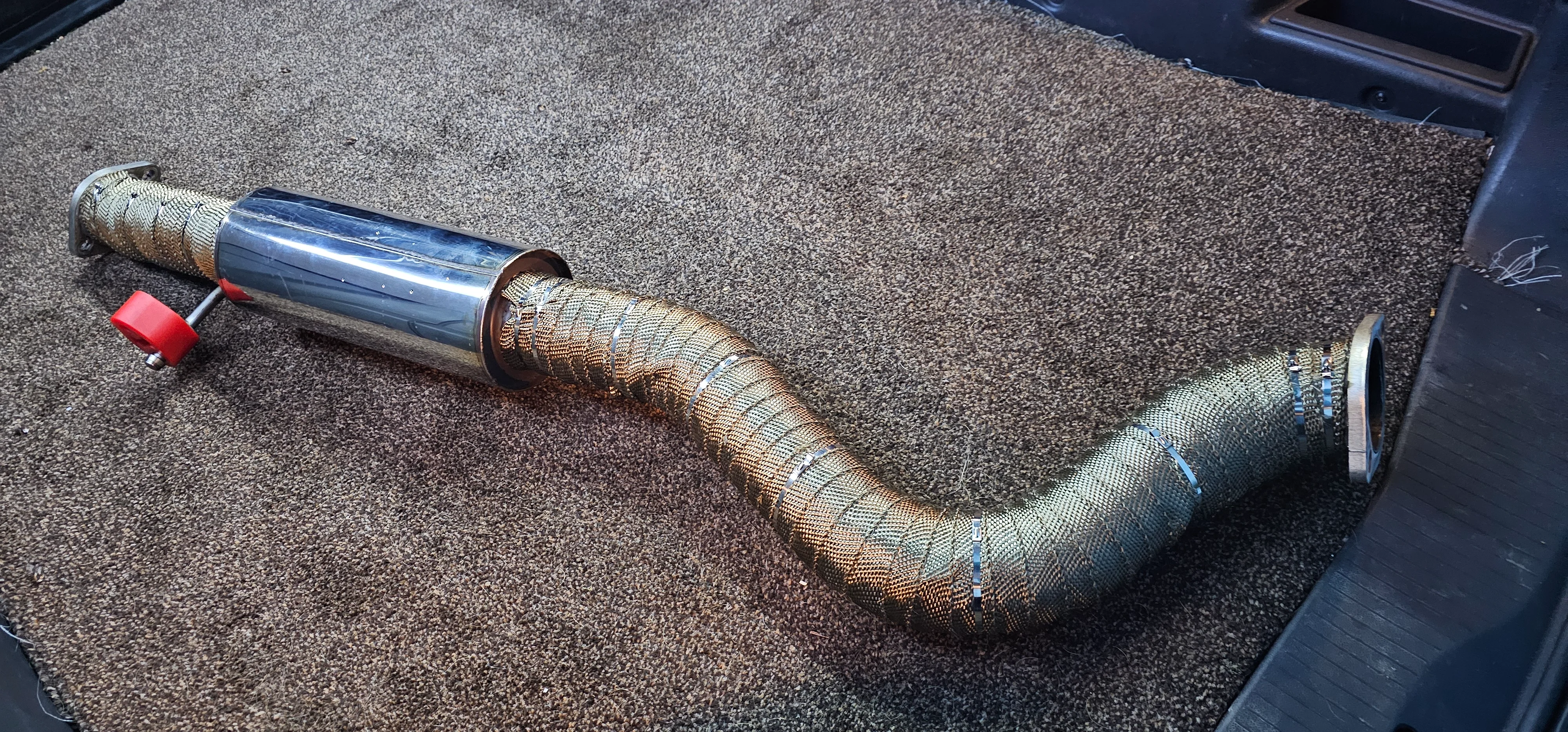

With the track season over last year... Decided to change all fluids, (engine/gearbox/transfer box/rear diff.) . lanoguard Bilt hamber dynax uc the underneath. (again) clean and wrap the exhaust near the Diff with funk motorsports titanium lava wrap.
Drys to a nice satin/matt finish..

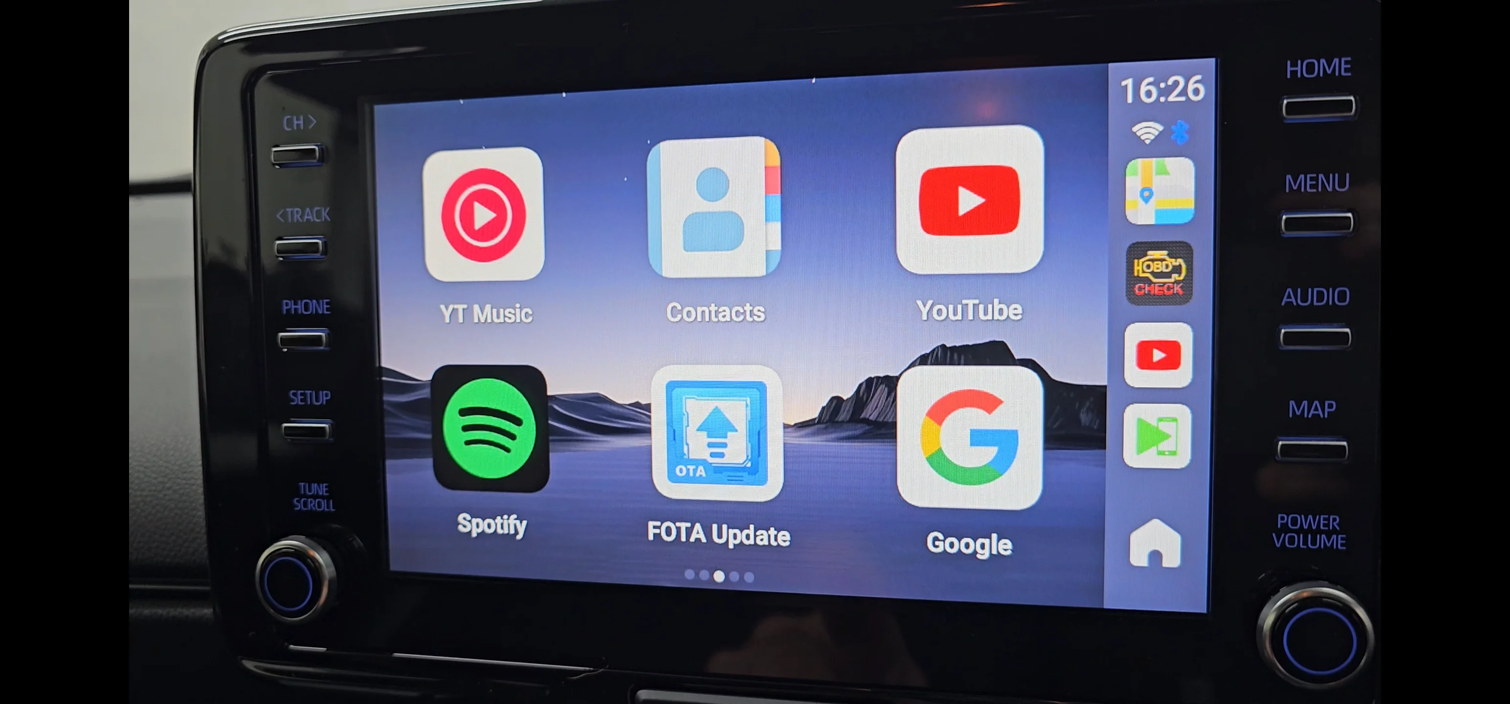

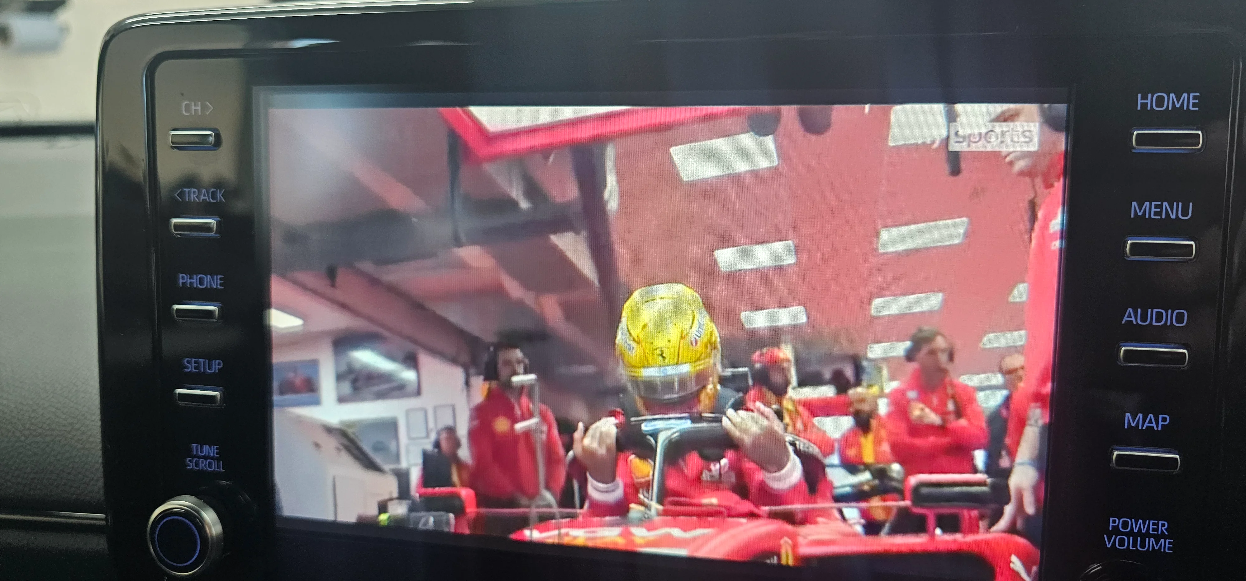

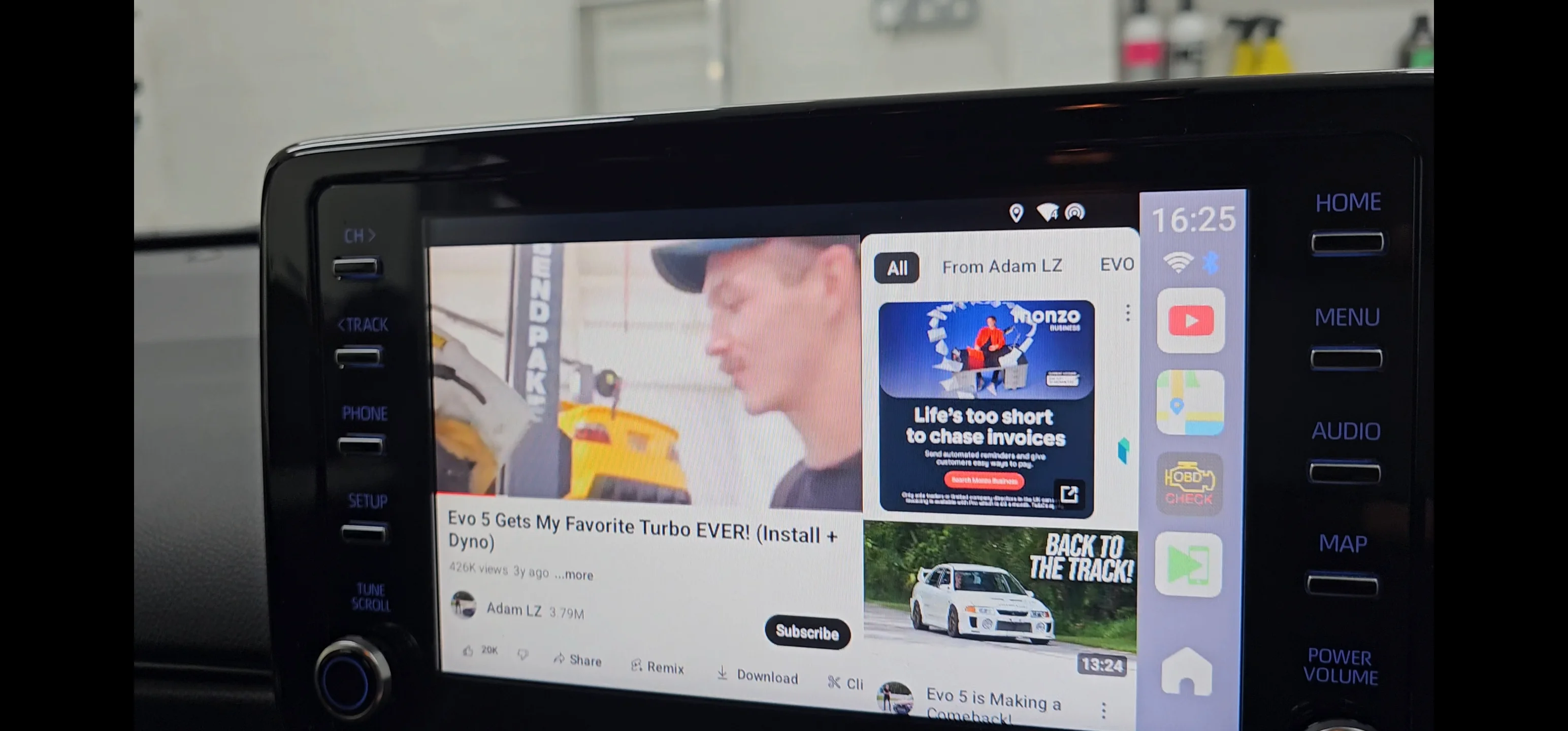

Next up... I wanted torque pro dials and more apps/info on my screen... So me and manwithastick looked into it... Chose one of the best rated android ai boxes... Carlinkit cpc200 T box plus.
Fitted and took a few hours to set up and put apps on. Had it a few weeks now... Very very good! Works perfect! 8gb ram.. 128gb storage! And fast. Wireless Apple carplay/android auto
Torque pro with downloaded gr pids
YouTube
Netflix
Music and films on memory card
All playstore apps.
Google maps
Waze
And much Much more.
Uses hotspot off your phone.
