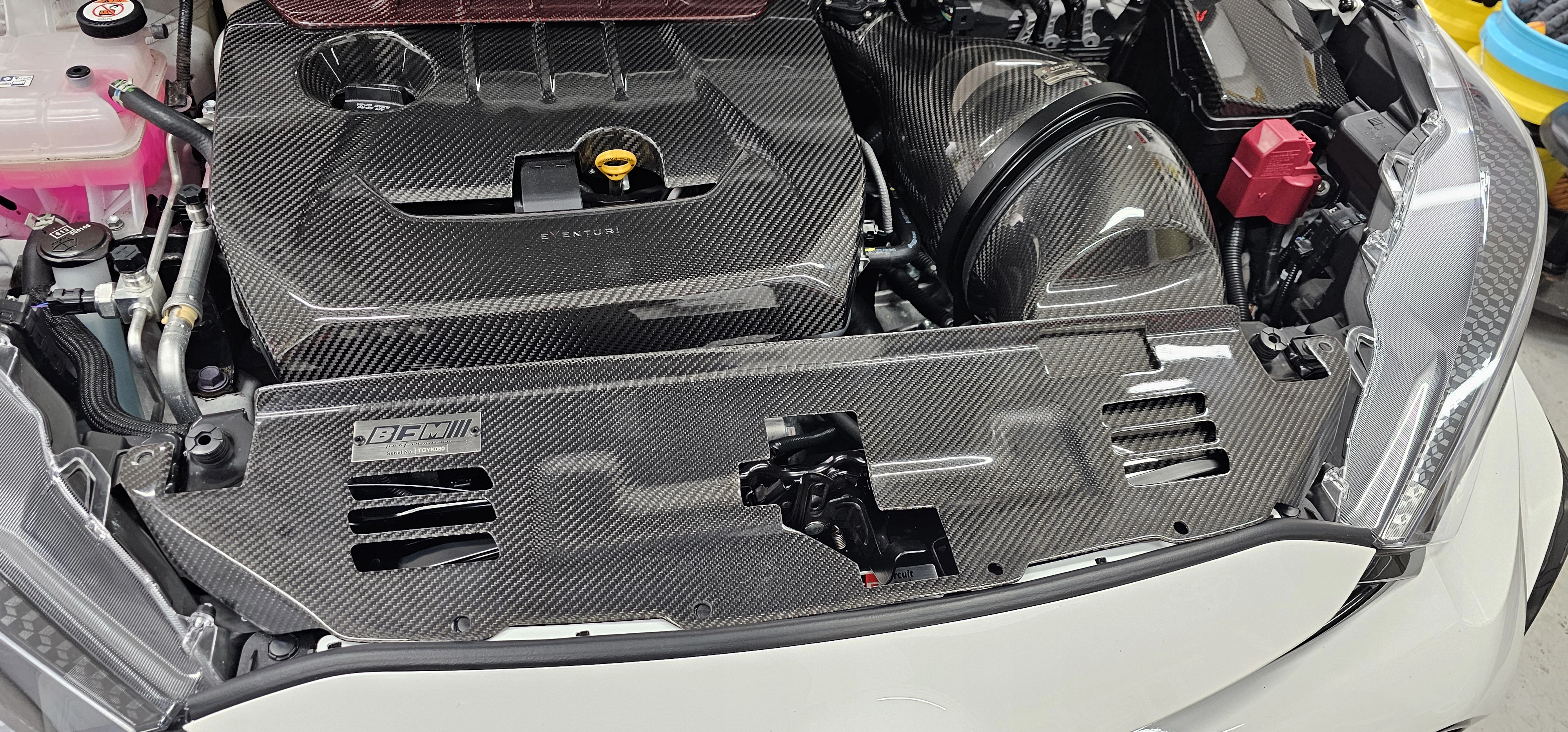

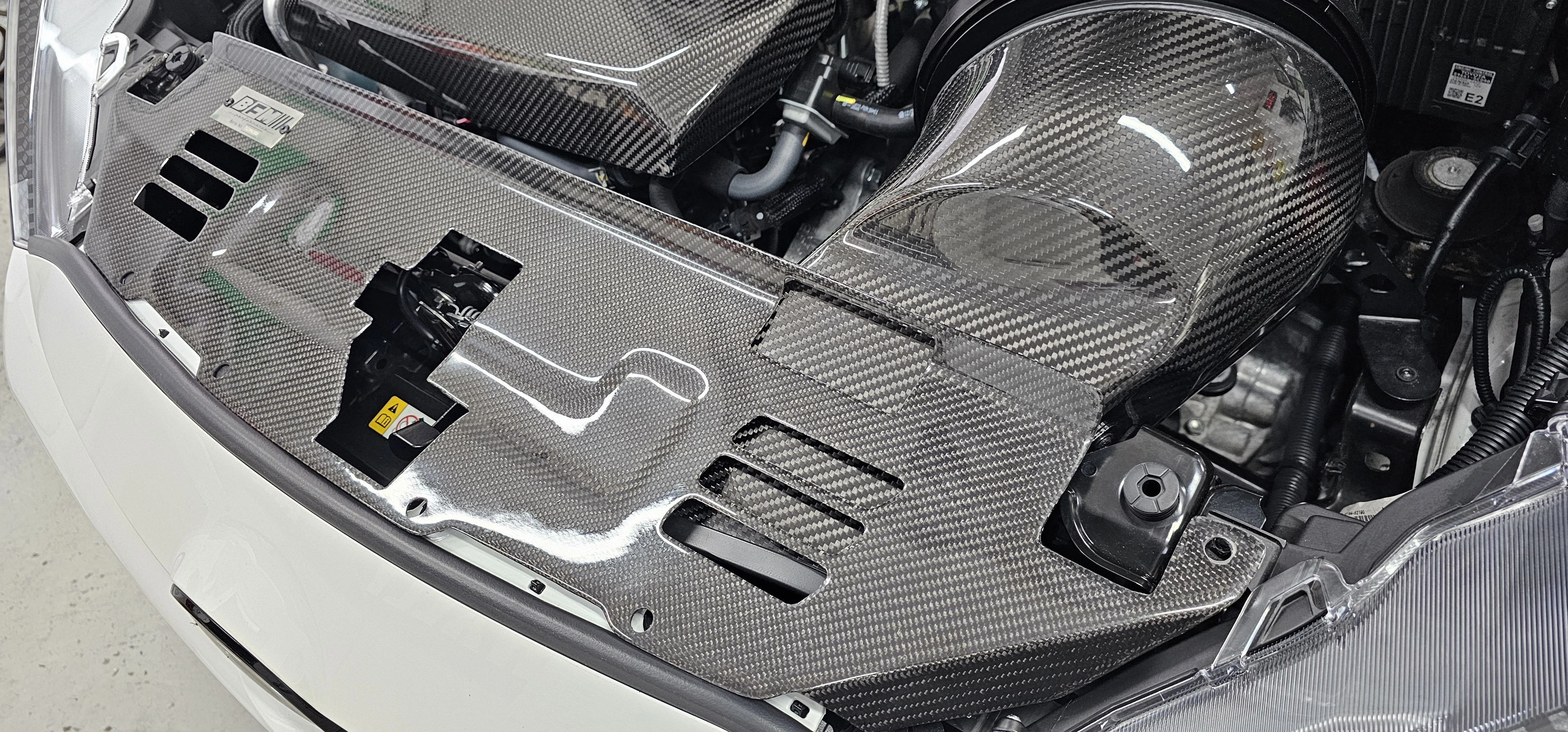

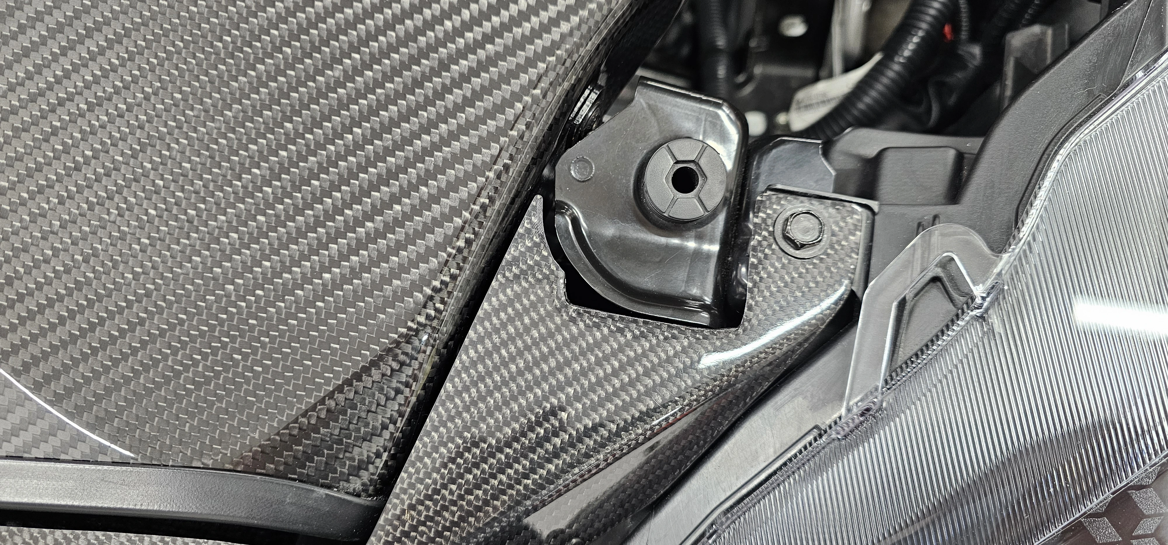

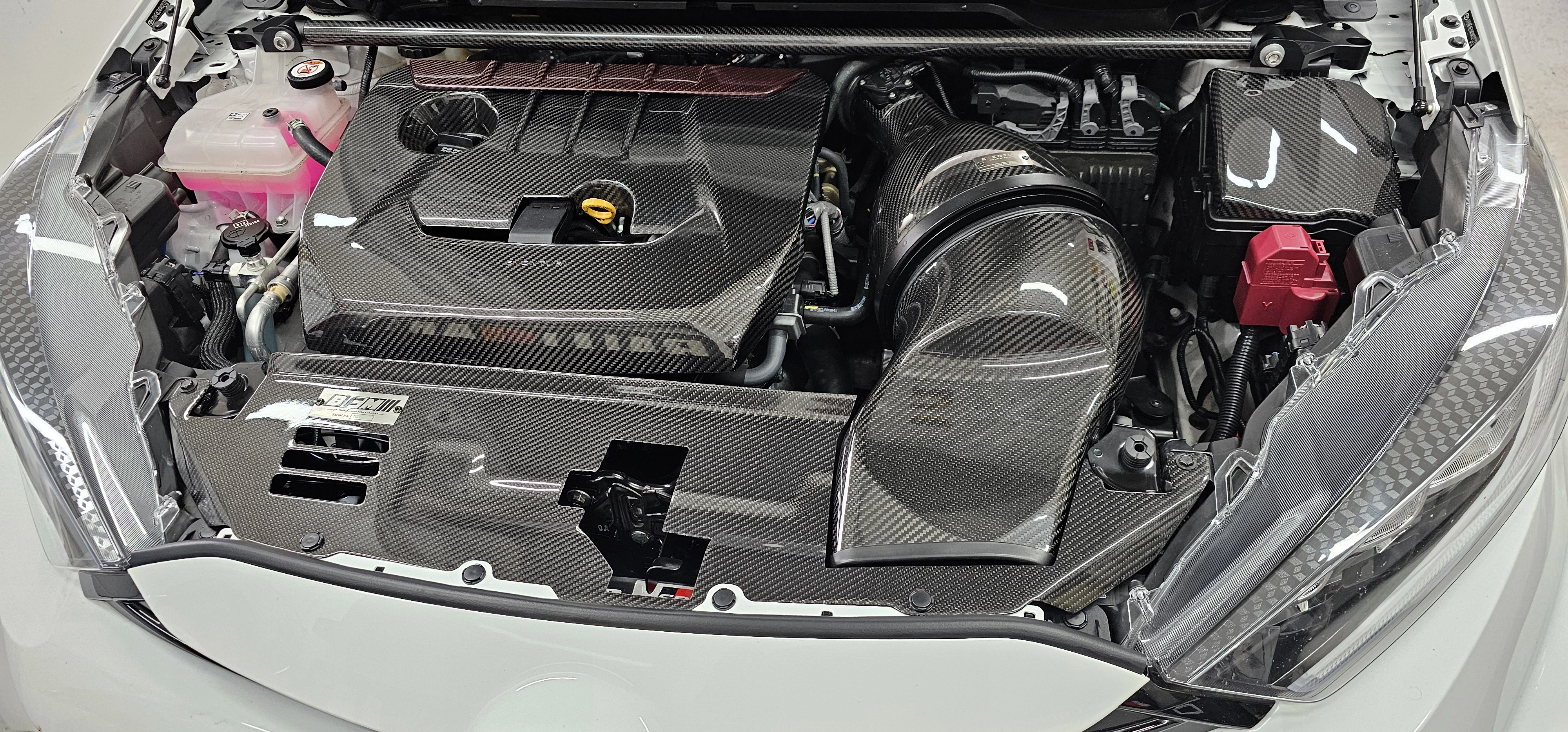

Next up... Carbon cooling panel.
It was for a standard car and air box... So sat on top of the Eventuri.😬... Some people were fine with that.. Not me. Hours cutting and trimming later...nice and neat around the eventuri., 😊
Trimmed....

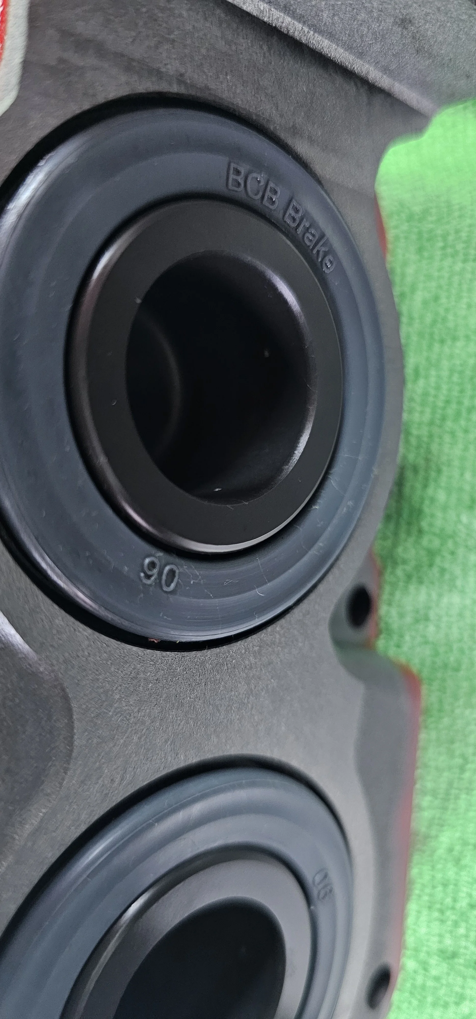

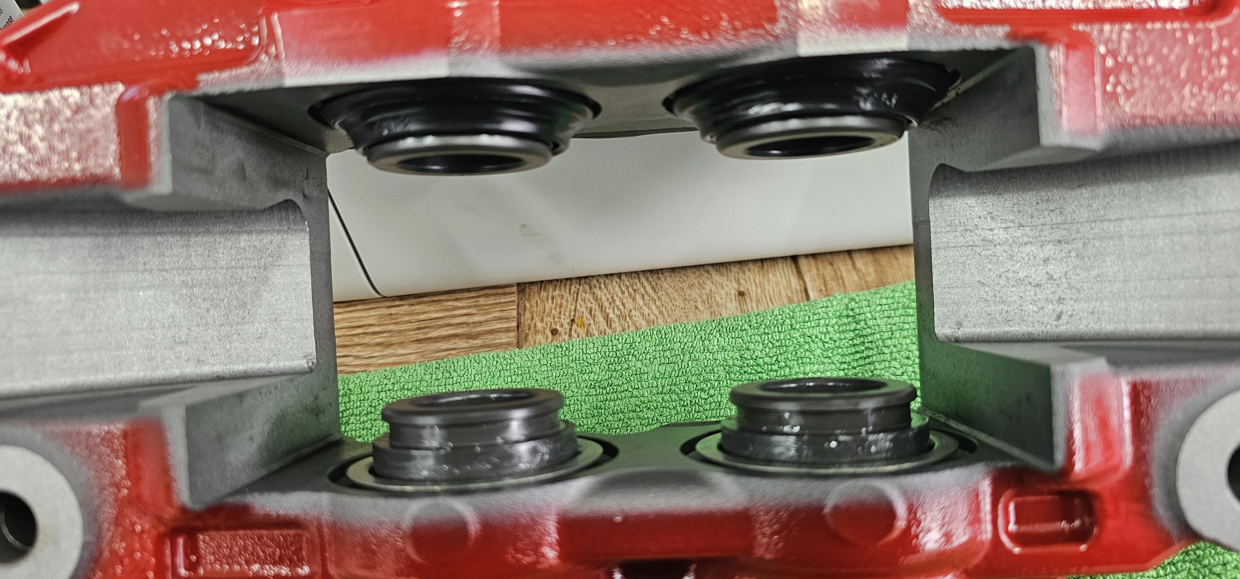

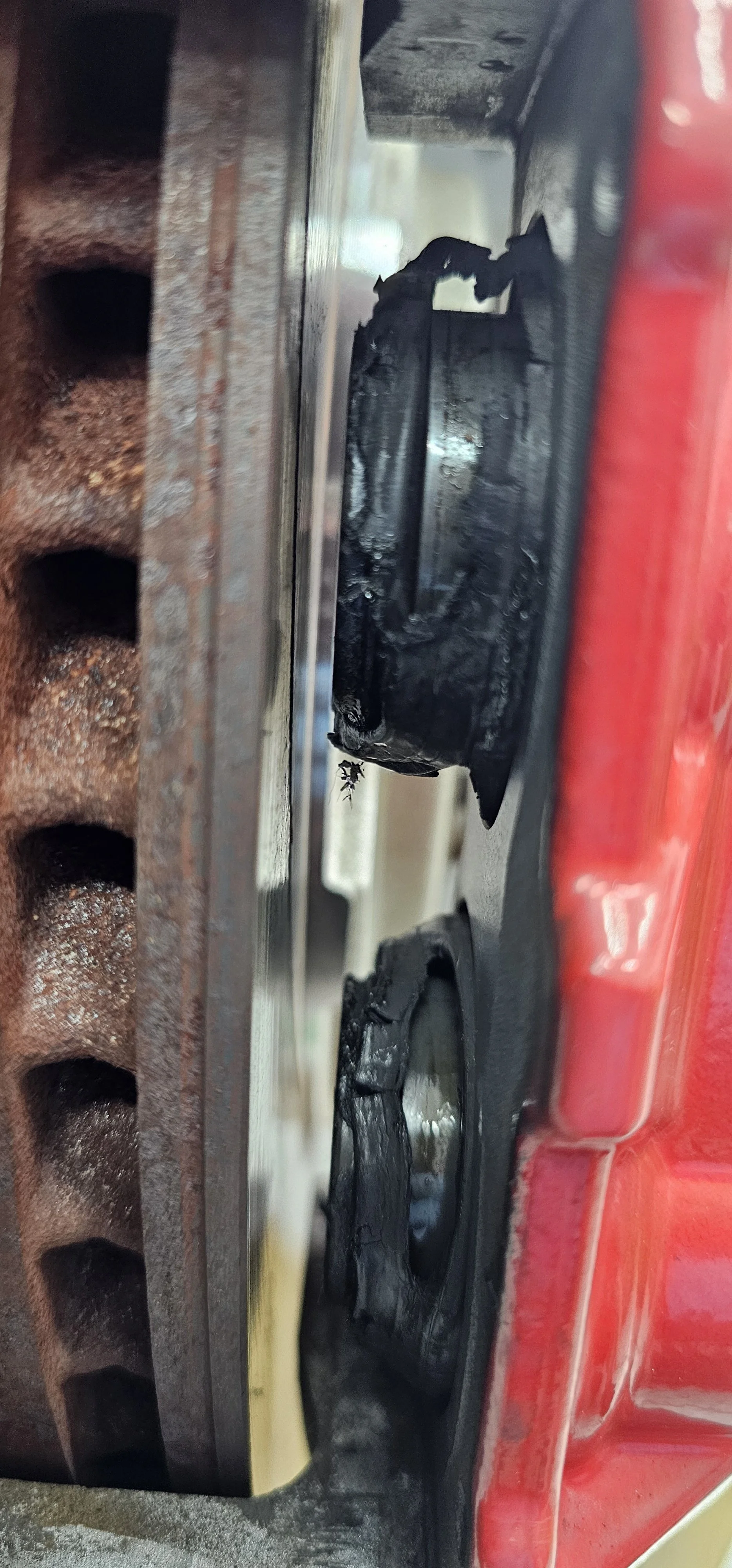

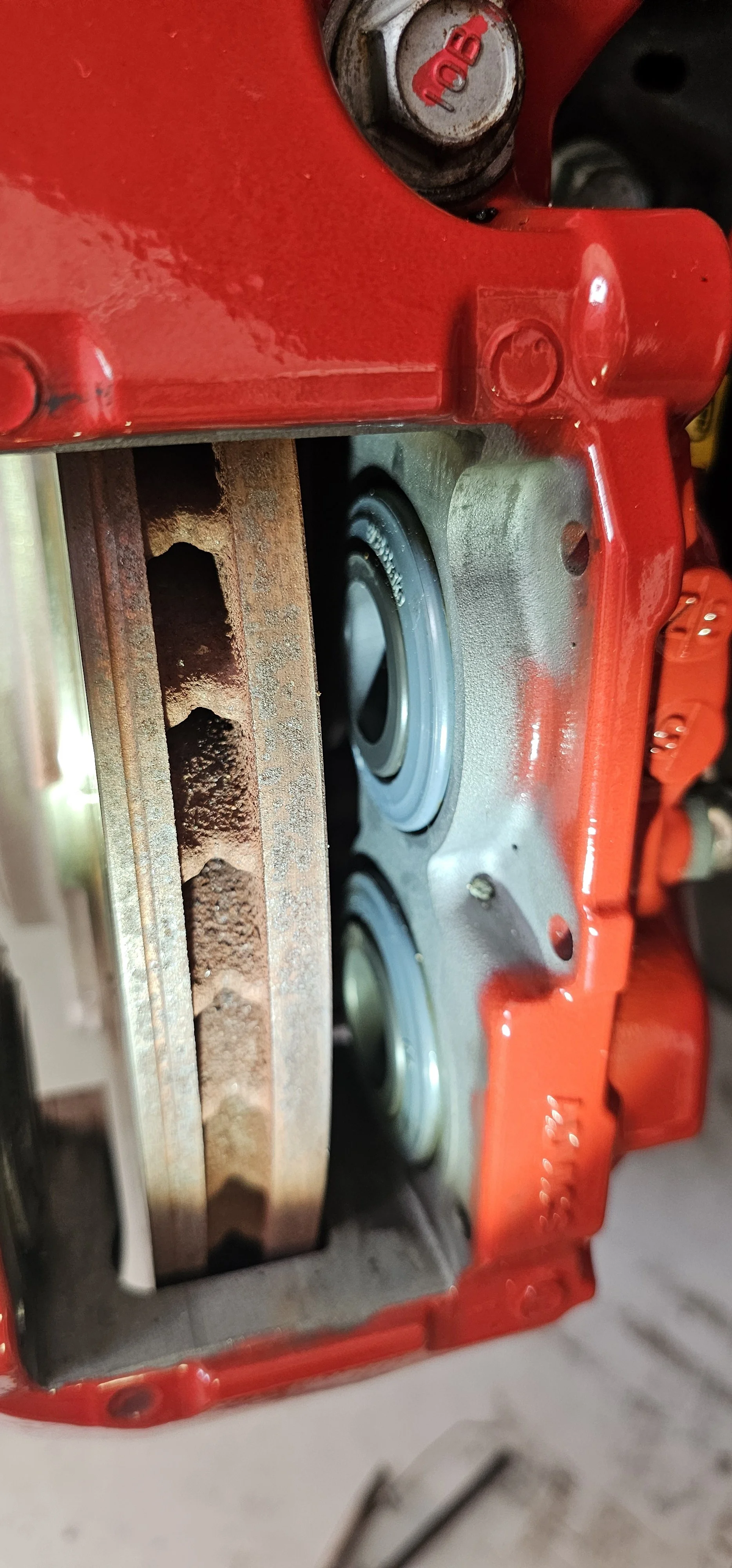

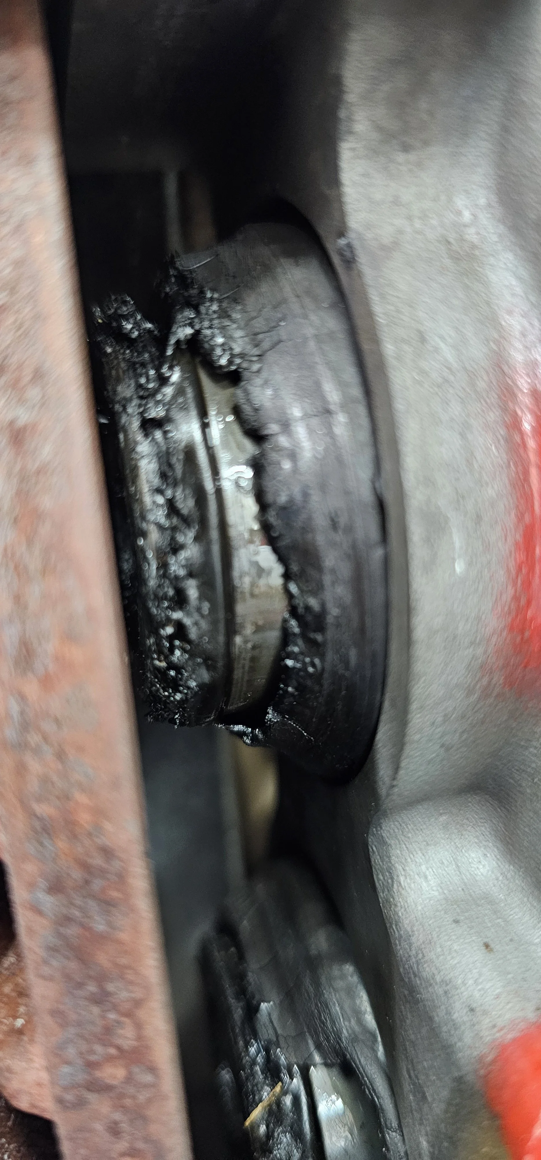

Without inspecting, are there any tell tale signs of specifically these seals having deteriorated?
Not really mate....pads out and get pistons pushed out a tiny bit to see the whole seal....see if they are melted/torn

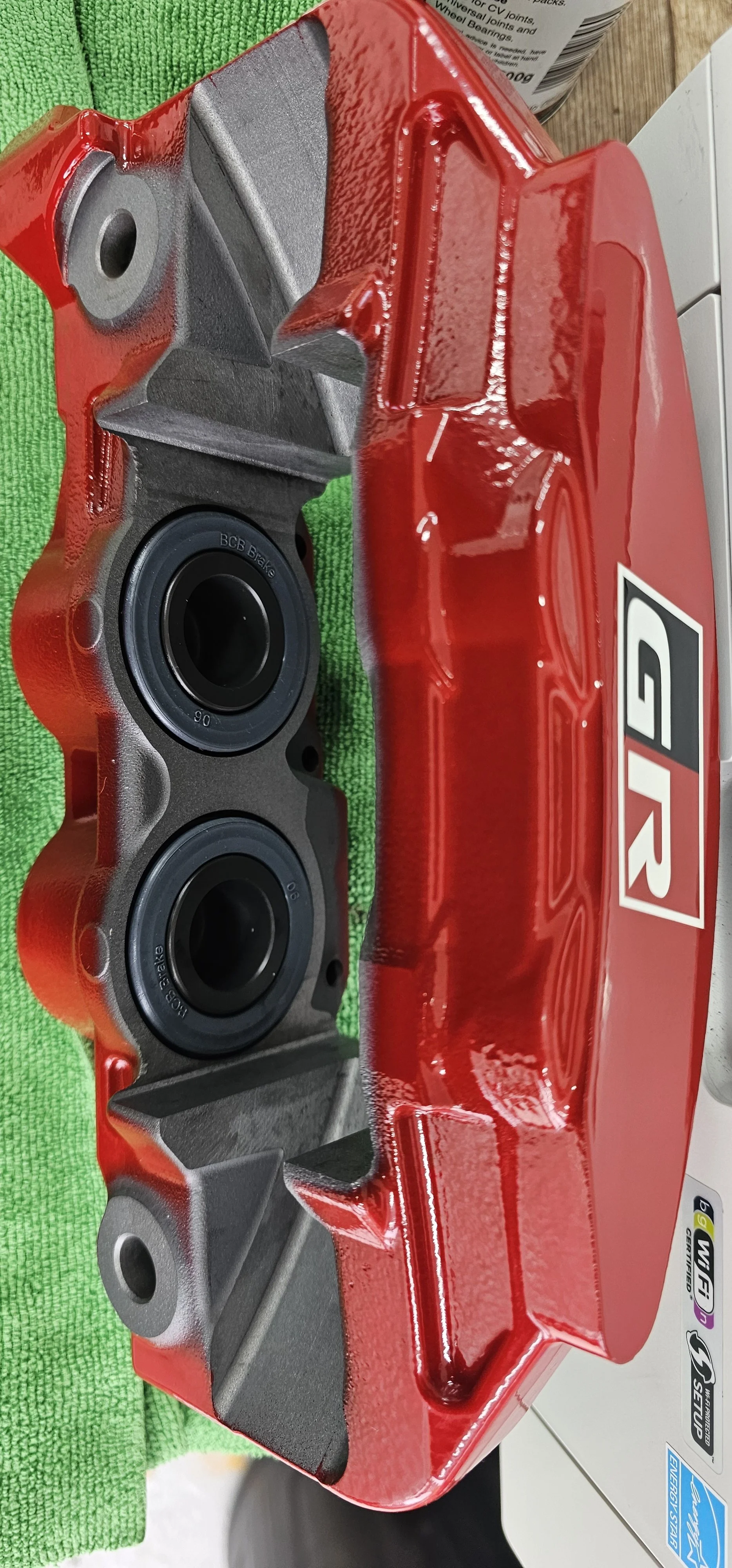

New calipers and uprated seals day. Very easy job... Pop the old seals out and put a tiny bit of red rubber grease on the new seals lip.. Massage into place. πŸ‘
Titanium shims and uprated brake fluid fitted too.

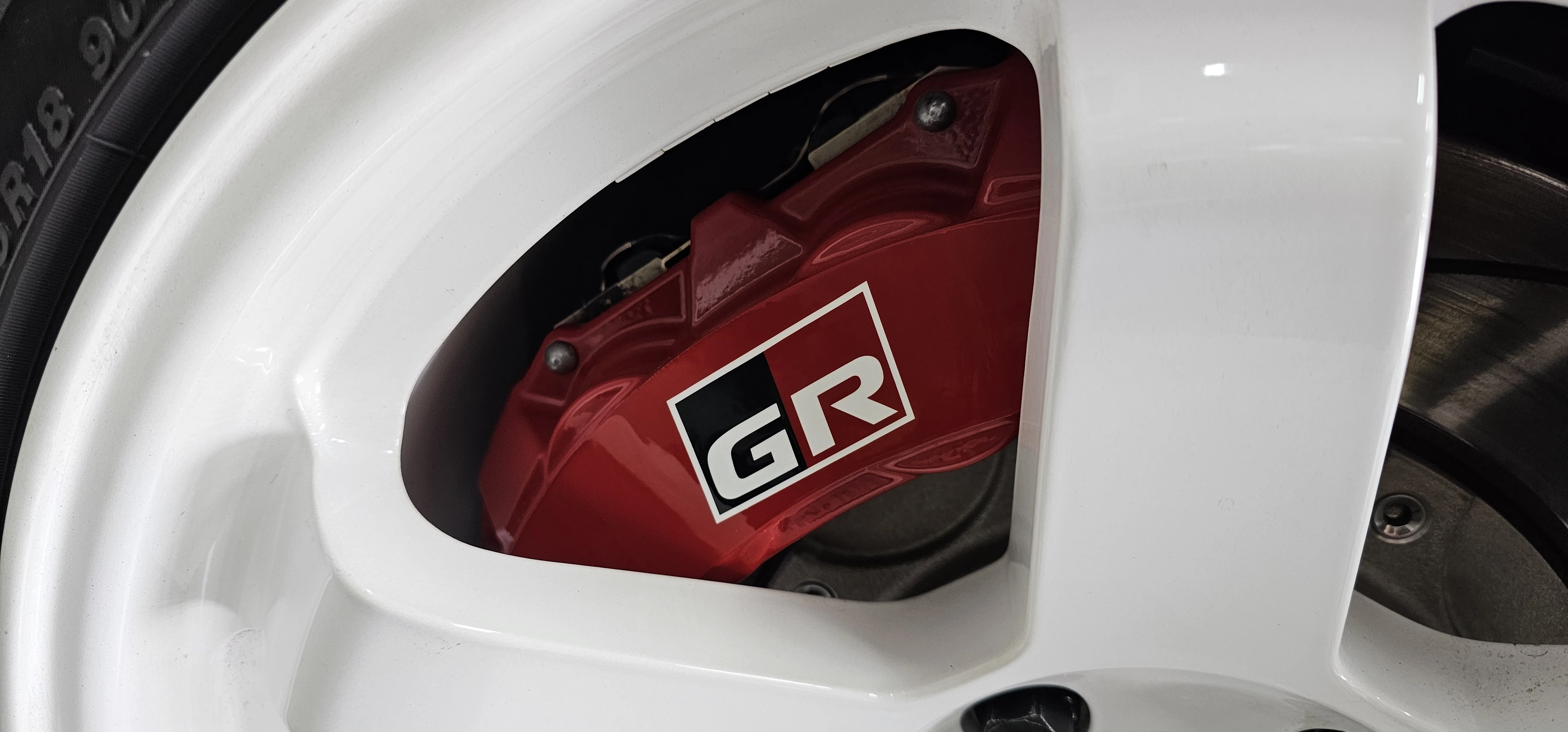

Calipers high temp ceramic coated.
Thinking that keeping a set of those seals handy might be a good idea.

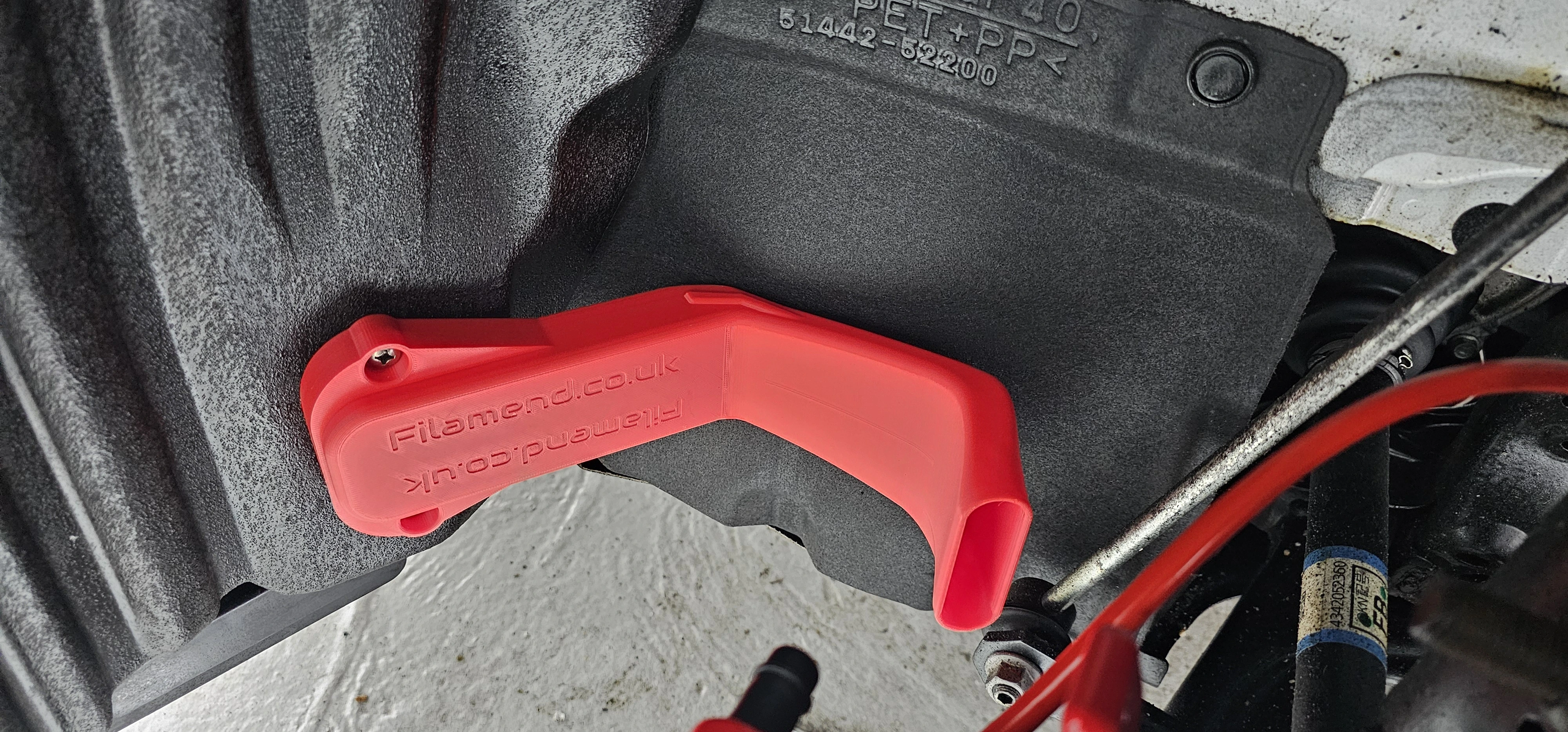

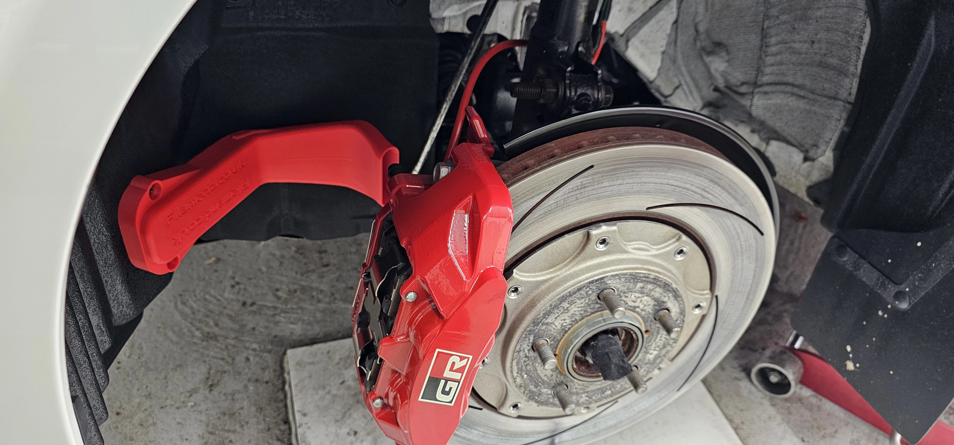

Bought some brake cooling guides after wards.... Fitted great.

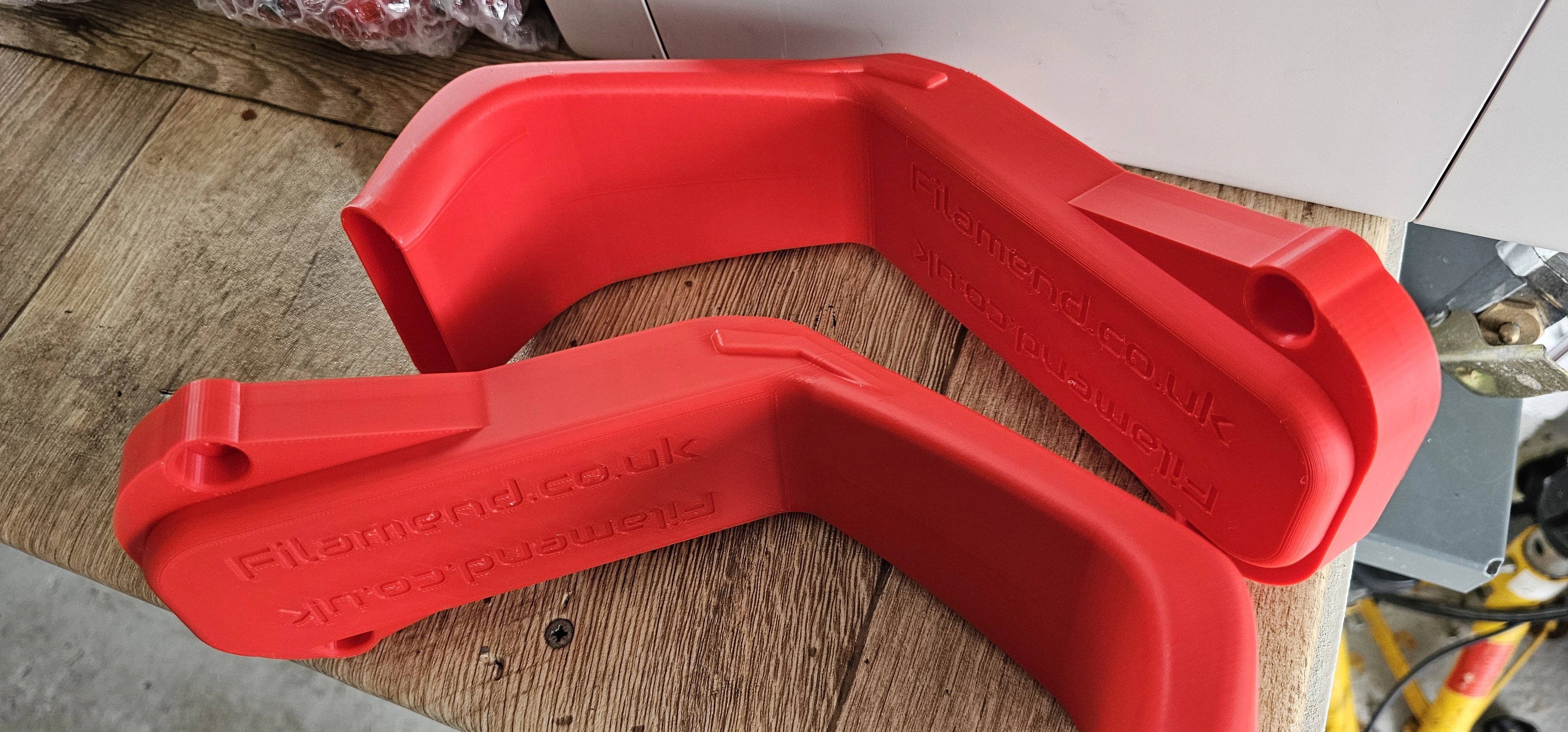

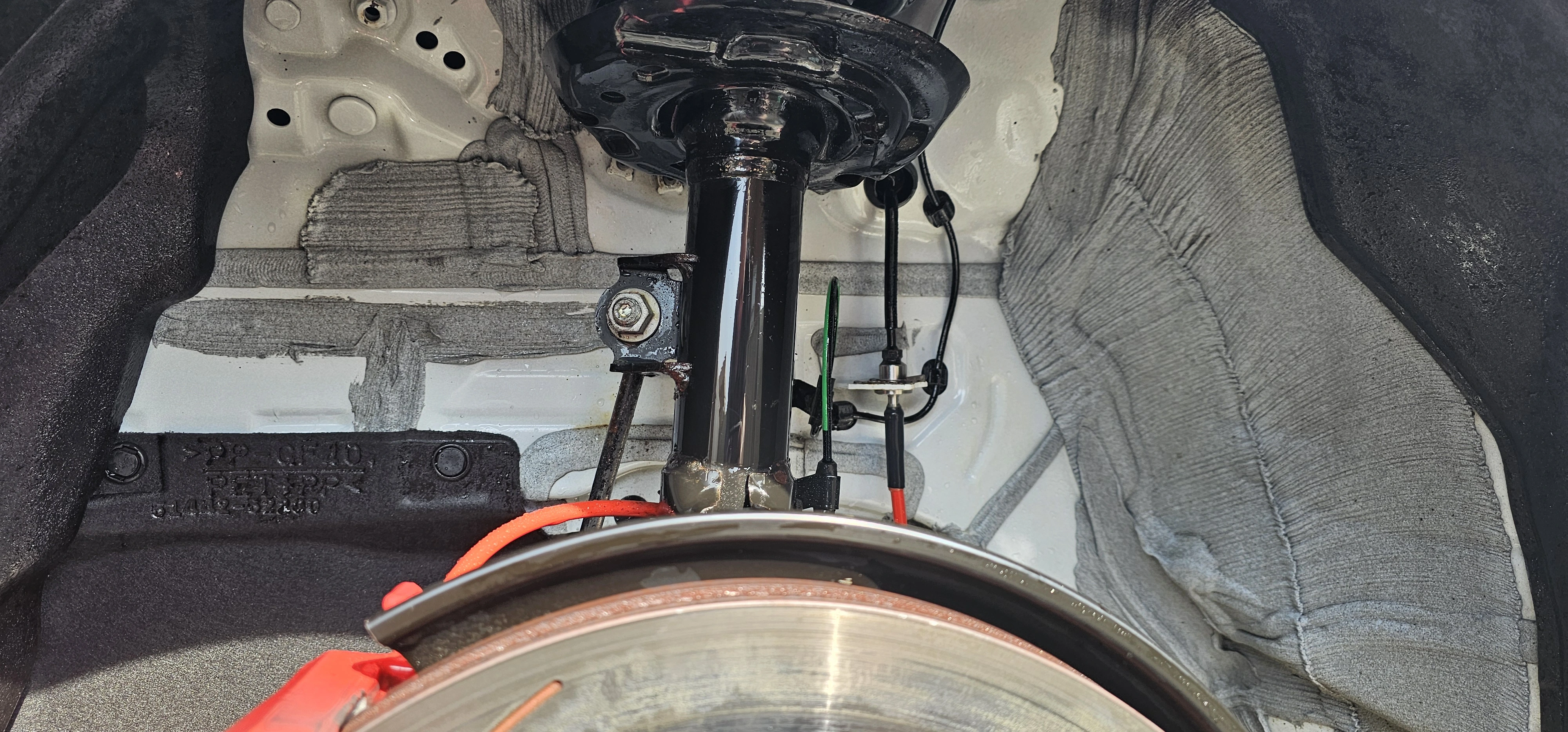

Any info on the brake ducts Phil? Look quality mate
They are from a guy in Ireland "filamend"..search on eBay........I think a fraction of the price of the scara ones
They fit perfect....I run 9.5 wide wheels and fitted on the ground at full lock there is no rubbing.
Thanks for sharing this with the rest of us.
Looks like a lot of shops claim those ducts as their product when there is a shared file for anyone with the right 3d printer to diy. Since i dont have a 3d printer (yet) i would also stick to buying a cost effective solution since the duct will be under some stress and have to withstand the abuse.
They also look much better (OEM) than the zip tying solutions with the usual red flexible fabric hoses. :D
direct link?
Would you care to share link the file?

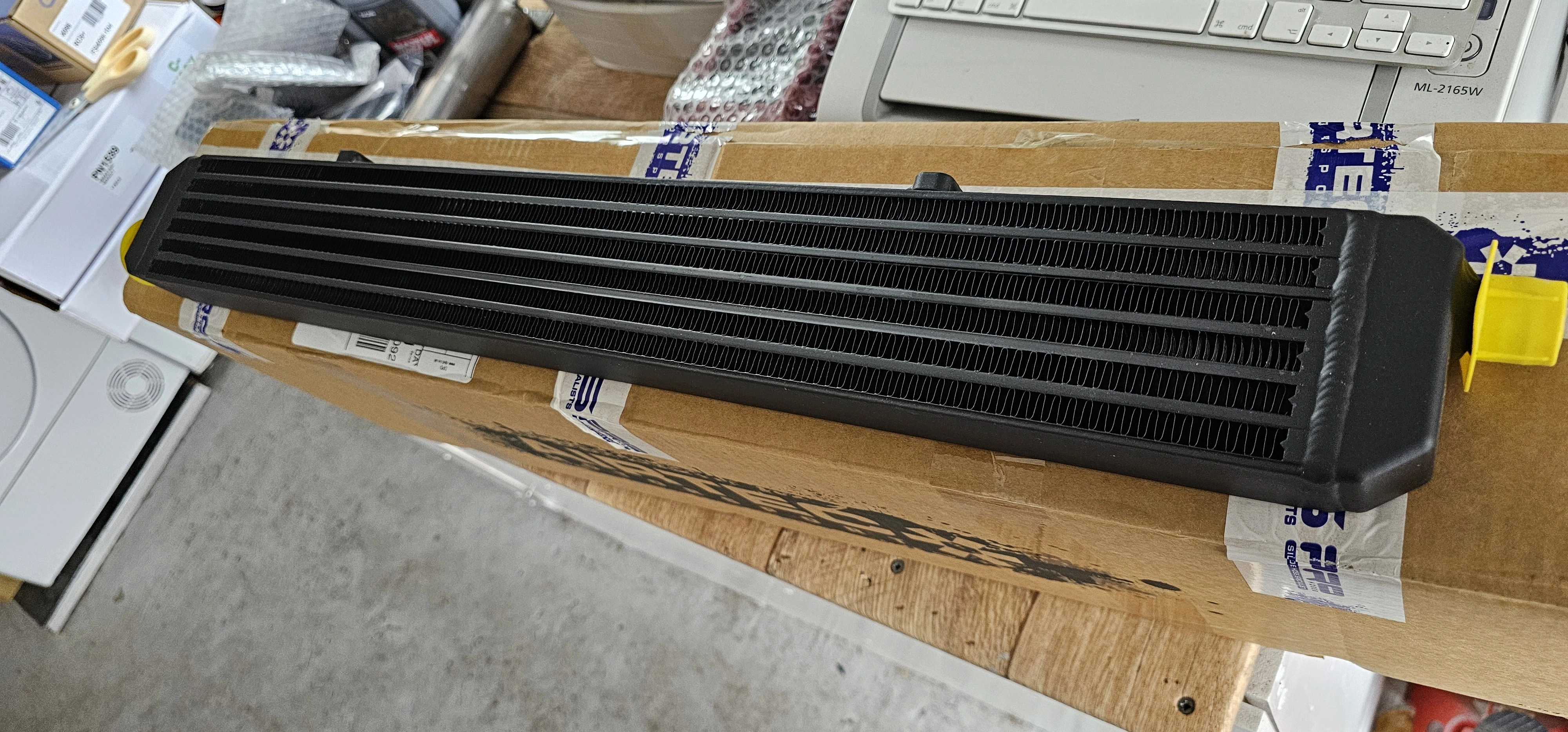

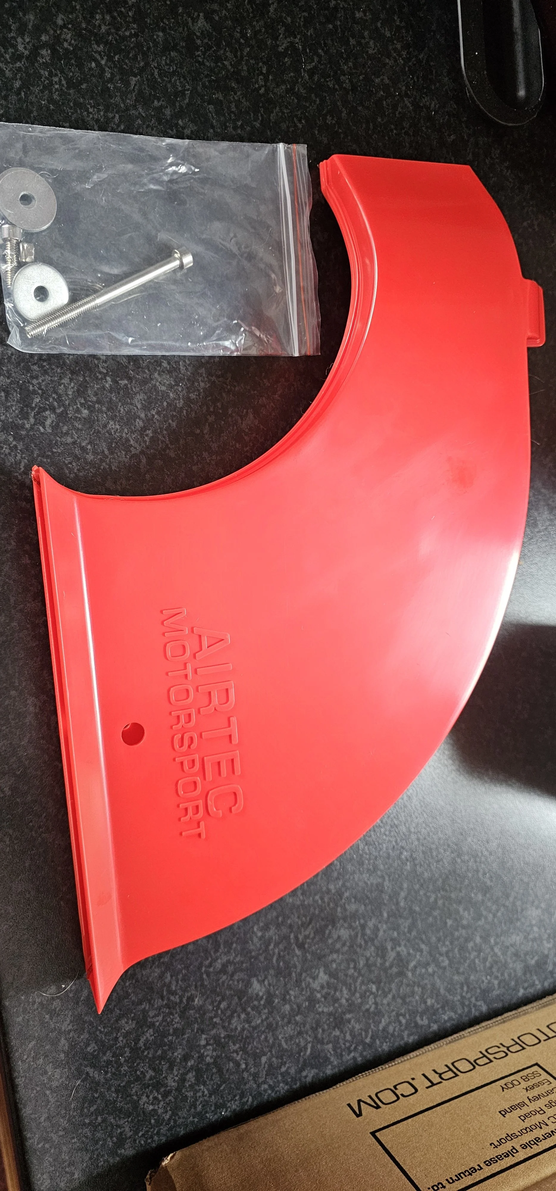

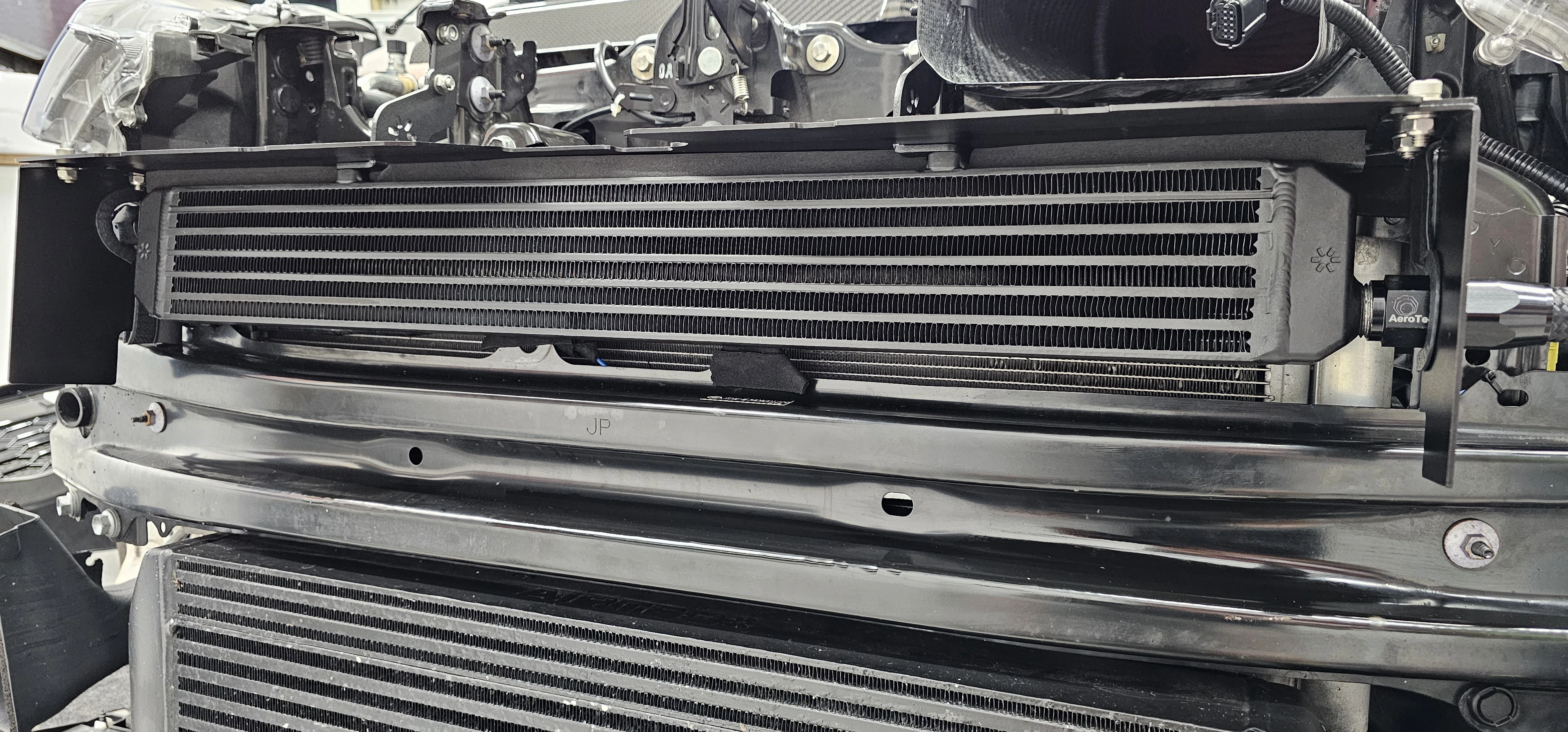

Next up... Bit more cooling for track work
Stage 1 airtec oil cooler off...... Stage 3 on. Massive!
