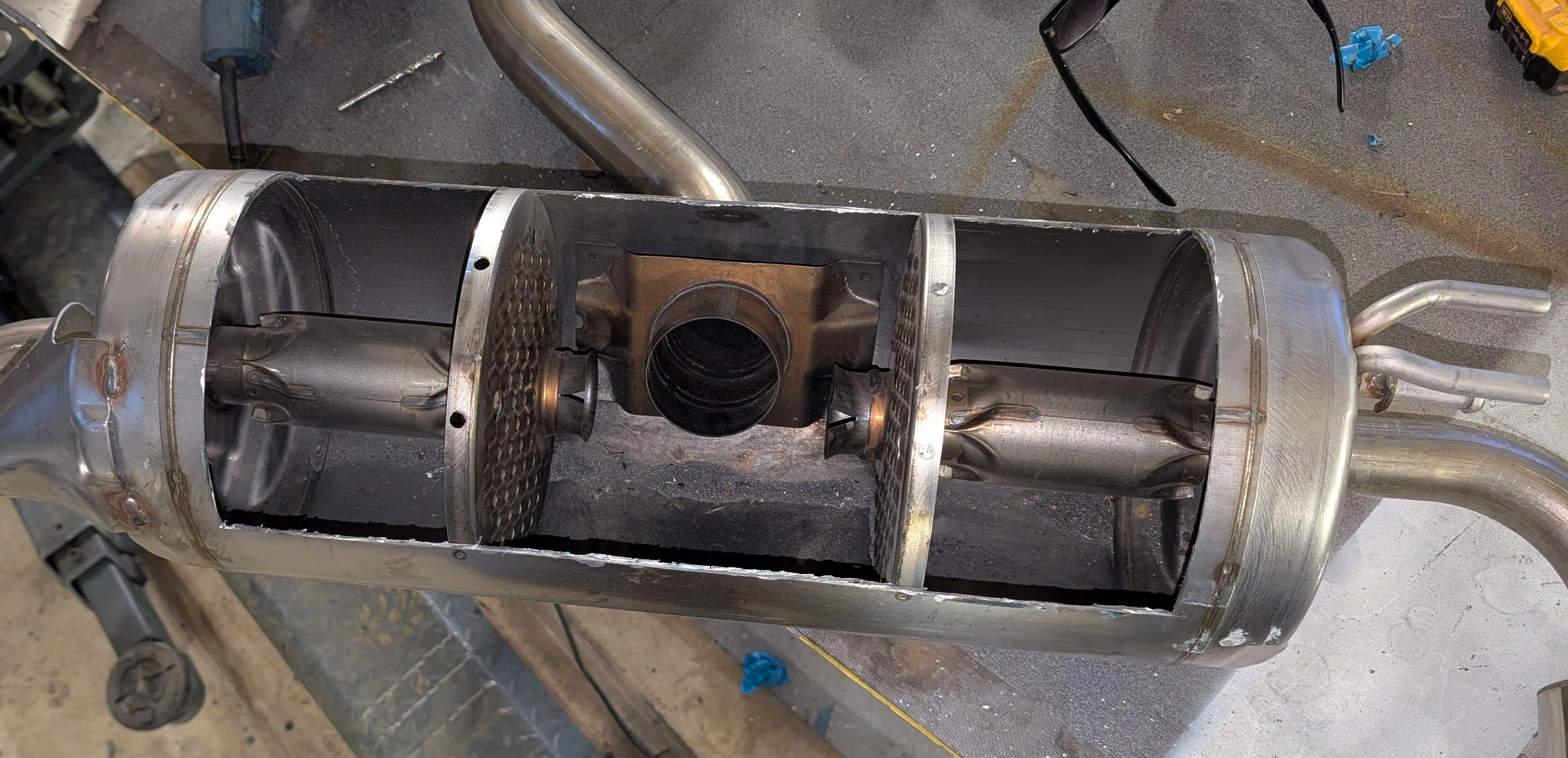

This is what greets you when cutting open the muffler. Take notice of the funny little pipes that come after the baffles (large sieves), they seem to be some sort of resonators.

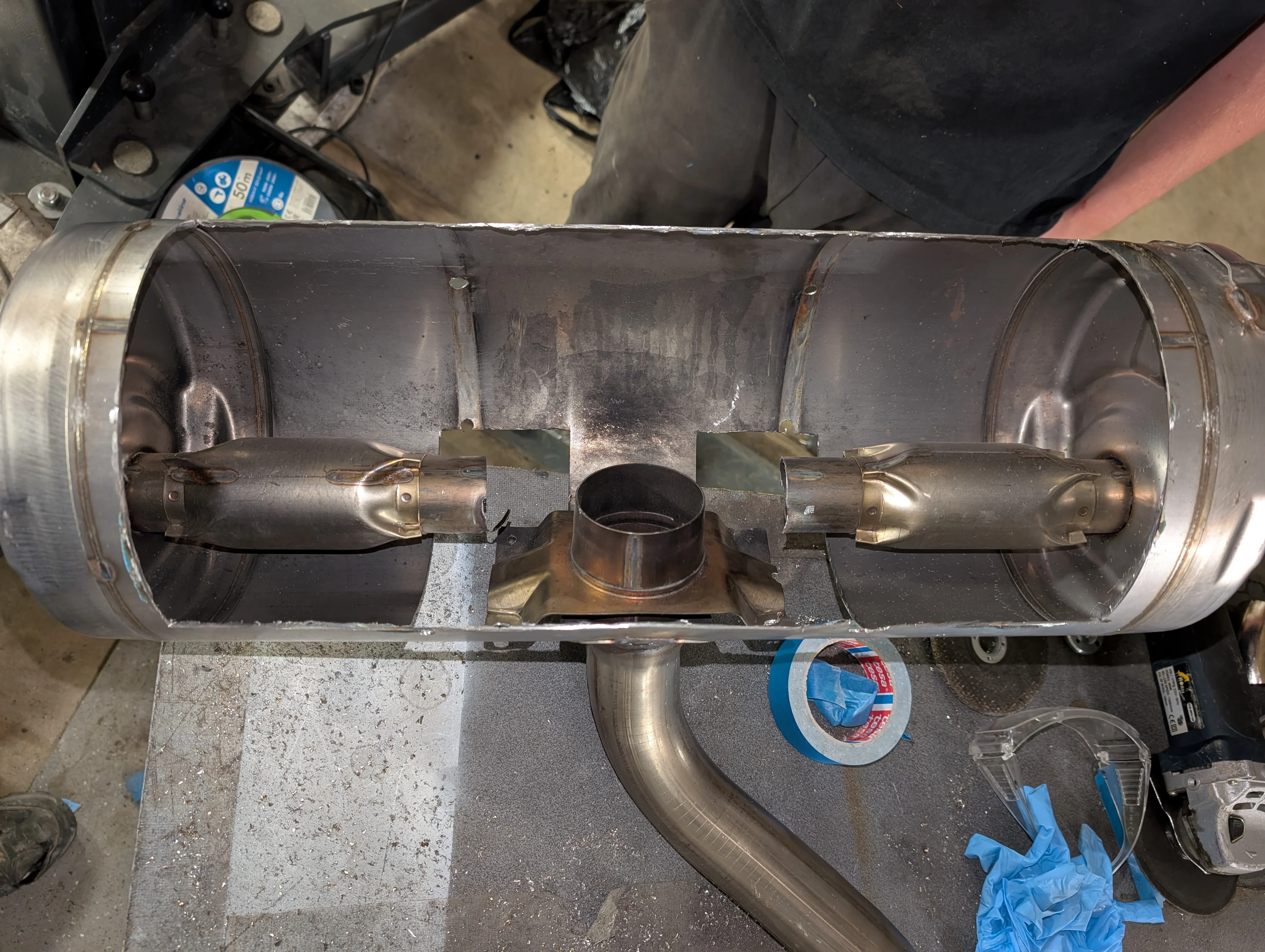

After removing baffles:
New "Y-pipe":

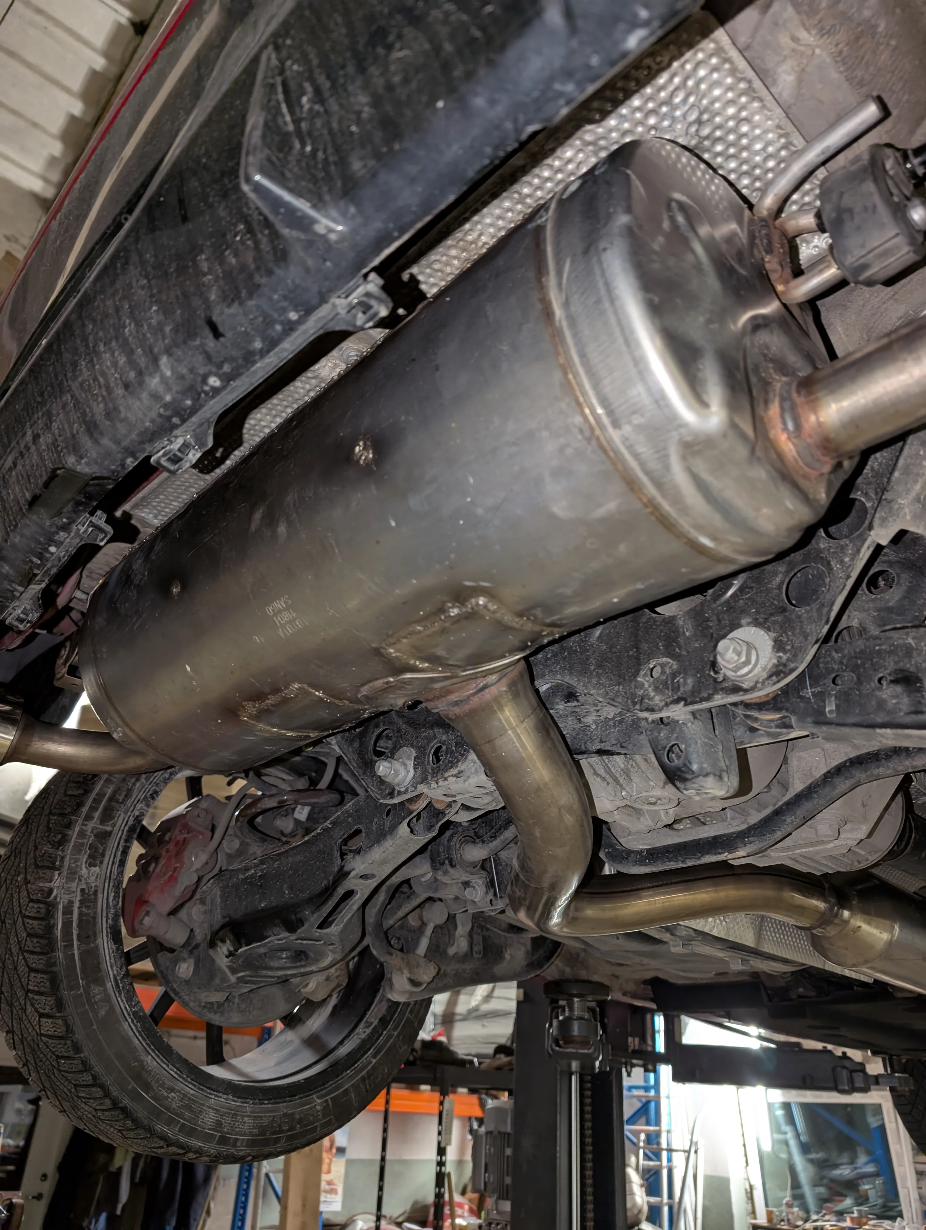

Welded all together and back on car:
New "Y-pipe":
