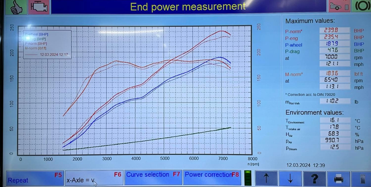

Hi guys, first post on here. Noticed a previous graph was posted of my car.
Dyno tested again a few days ago on the Maha dyno.
Wheel HP figures on this vs a dynojet are always lower. However these machines measure wheel HP and then the drag on the run down and then add it to the wheel HP to get the flywheel figure.
They are very accurate and consistent.
Dyno tested a Civic FL5 around 1 hour before and that made its factory figures too.
GR Yaris makes pretty much factory figures on this machine.
I’d say they are absolutely spot on with their figures.
Graph below shows a comparison of stock vs stock + intake system
Great graph, it’s a super impressive specific output for a stock car with a 10 year warranty. It’s getting close to 100bhp/litre and there’s not many production NA cars that achieve that.
What mods were made to the intake as a 10bhp gain is decent!

Thanks for that.
What's the difference in meaning between P-norm* and P-eng?

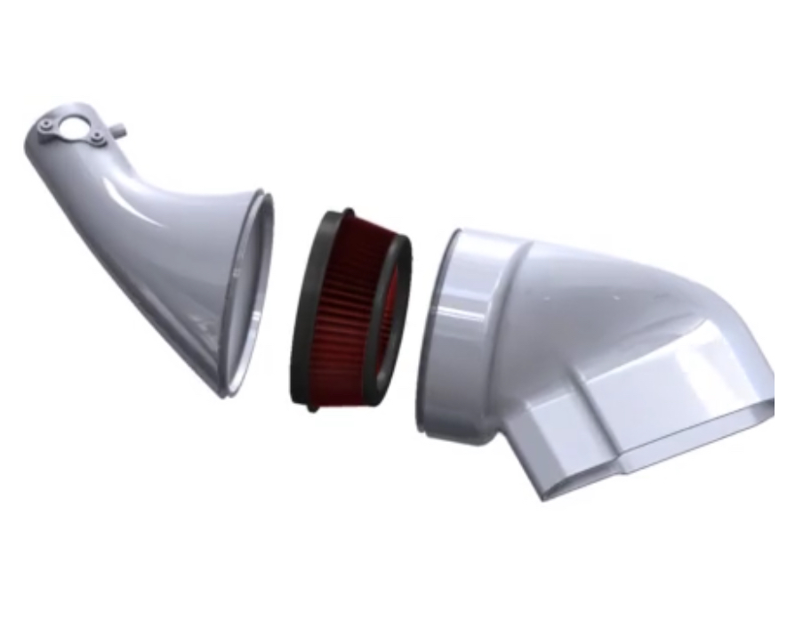

It is very impressive indeed as an engine especially at this budget. Compromises have clearly needed to be made for that warranty with very conservative tuning. The intake system is heavily worked on to reduce sound and keep It as small as possible for pass by noise regulations.
The 12-14hp gains from the graph are from an intake system which has just been developed by us which uses a very direct path, a very large air filter with a 175mm opening and much larger duct.

P-Norm is with atmospheric correction factor
P-Eng is without
The difference between the two tests is even great if the correction is turned off.
